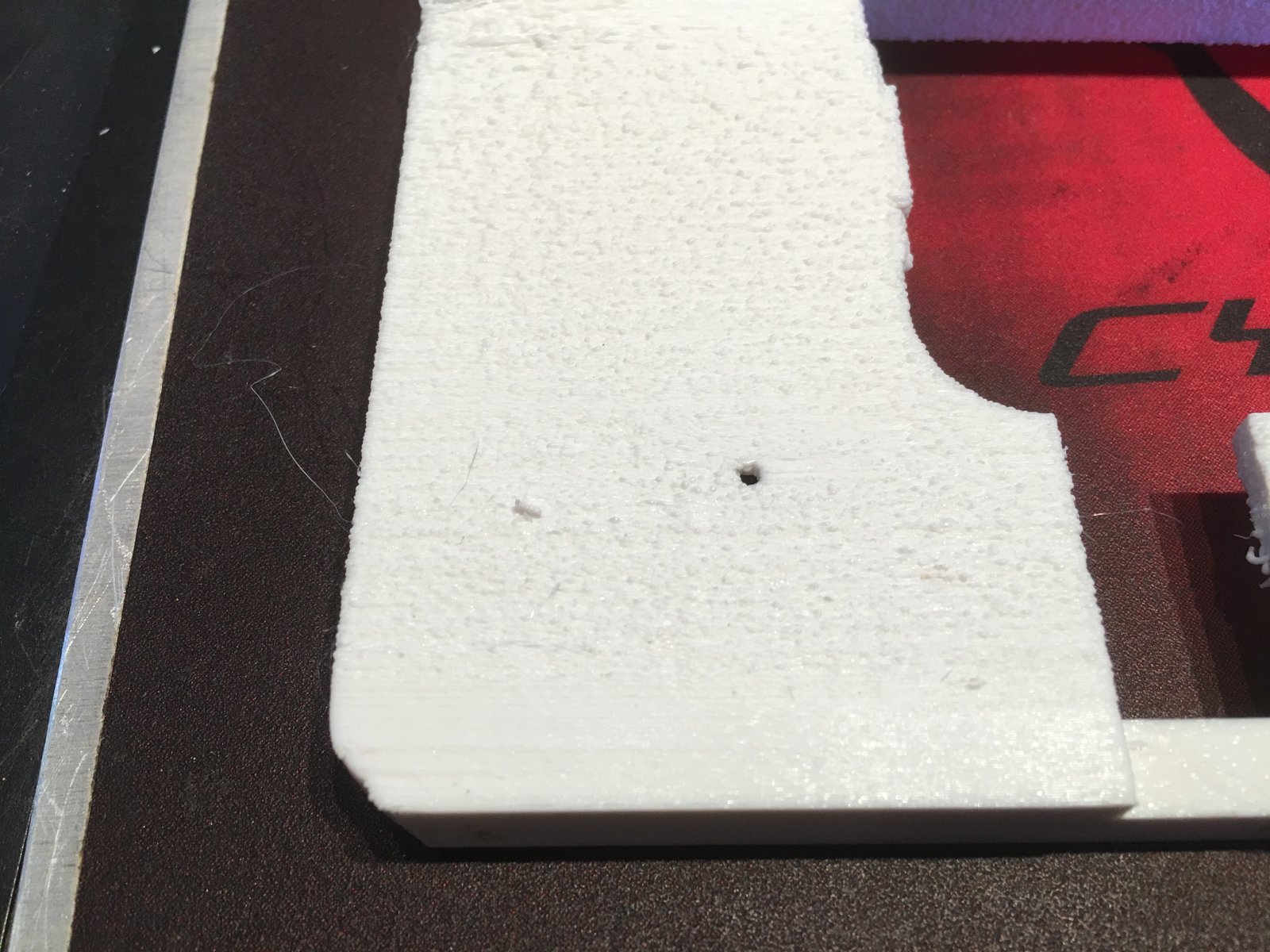

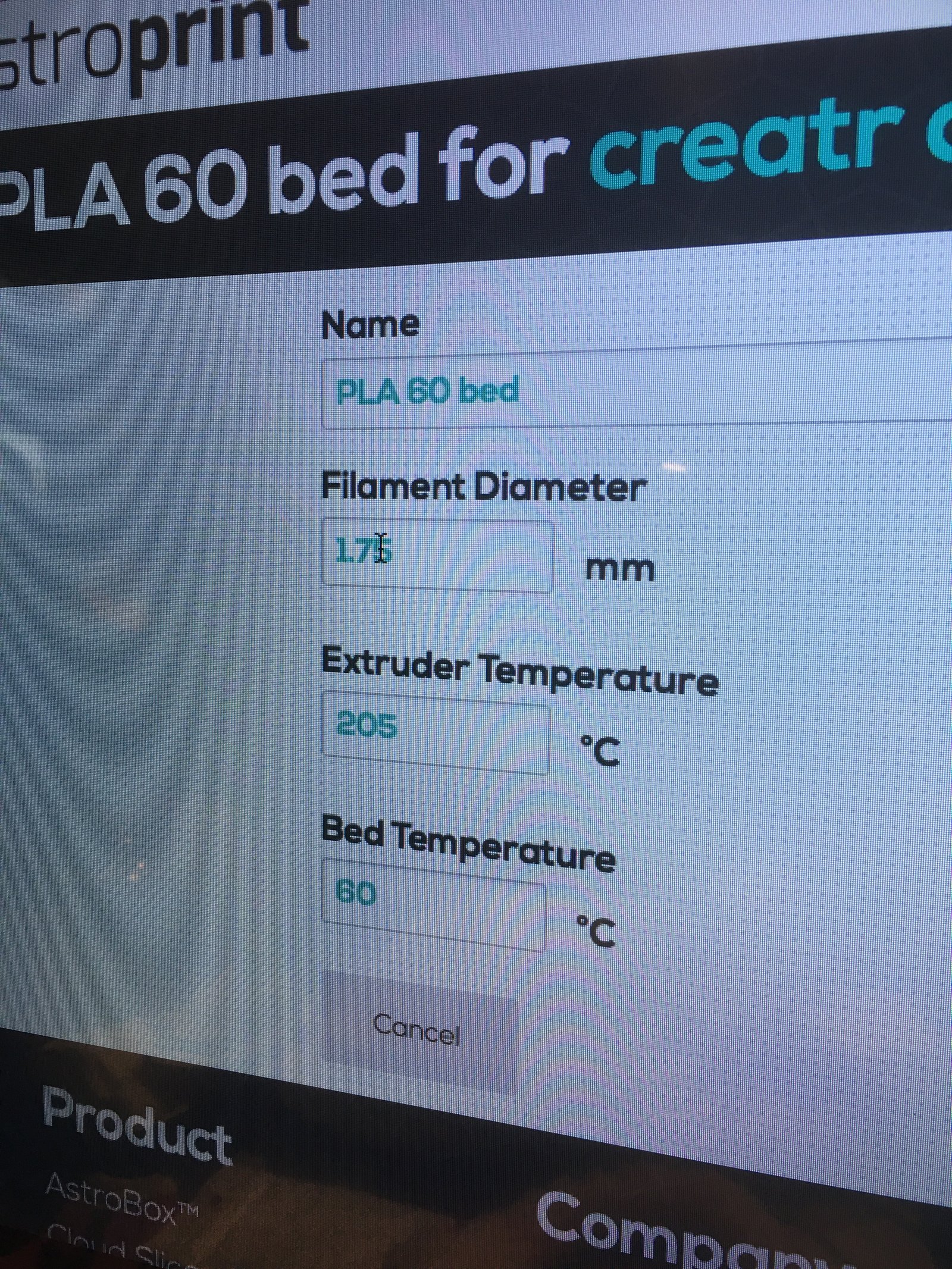

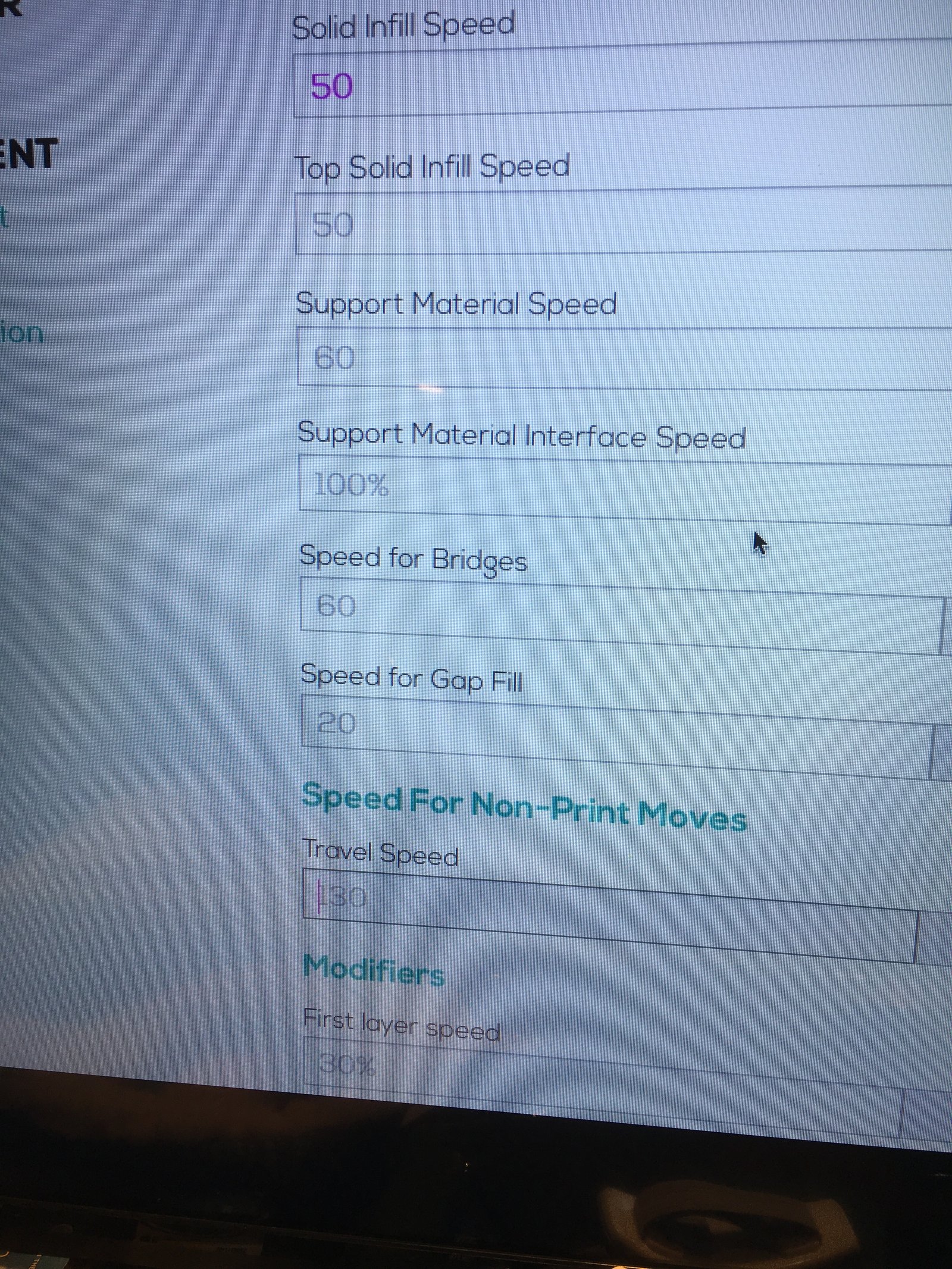

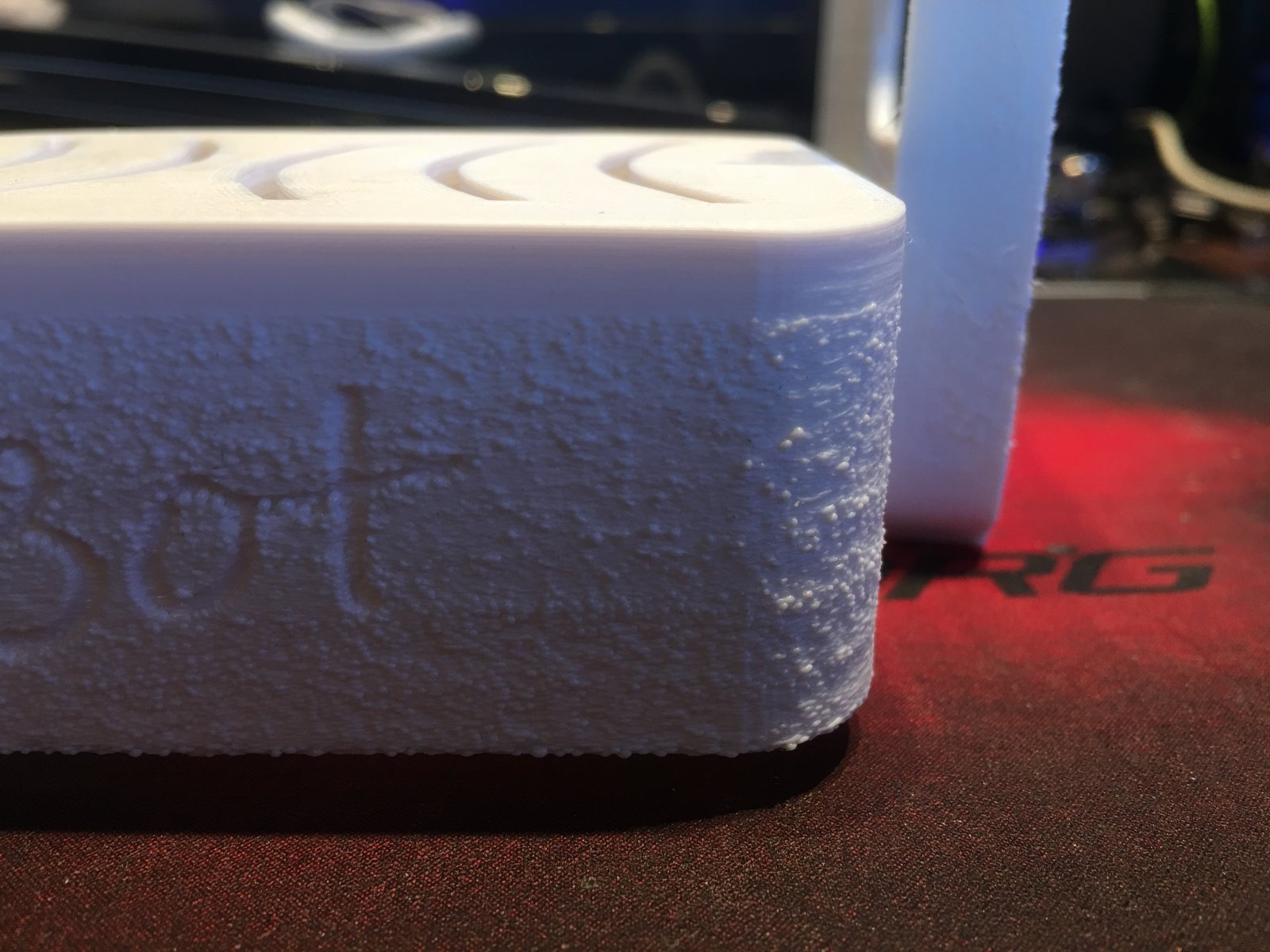

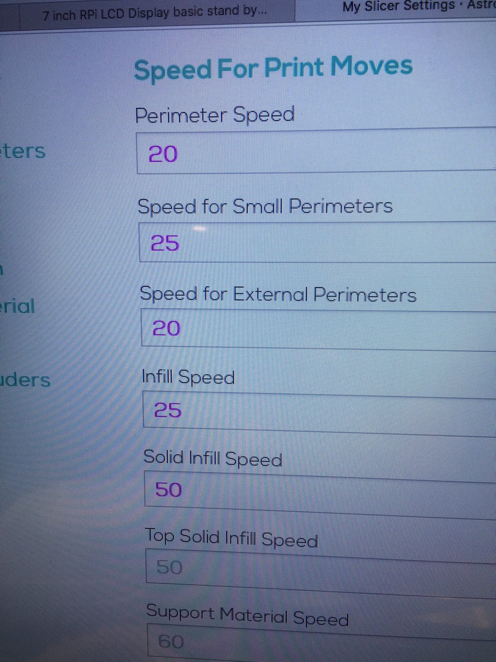

I am getting a strange print quality change during the build process on both my creatr duals. both are running astrobox and being sliced by slic3r. pictures below are of the print quality and then the settings are listed.
any help would be appreciated

Did you look at the temp during printing or did you change something on a certain height!
I think it would be a temperature change during the print
I don’t use this slicer but maybe it change temperature at certain height
Can you set it up to make concentric layer instead of rectangulair?
This could help you also, even if it is not the same slicer you use!
https://www.simplify3d.com/support/print-quality-troubleshooting/#gaps-in-thin-walls
3greetz
perhaps try to adjust the pla temp to 210/215 !
3greetz
Hello,
i had the same problem but i get it fixed.
I have changed the nozzles and plug and external build-fan on the back of the extruder. Now, my printquality is great!
