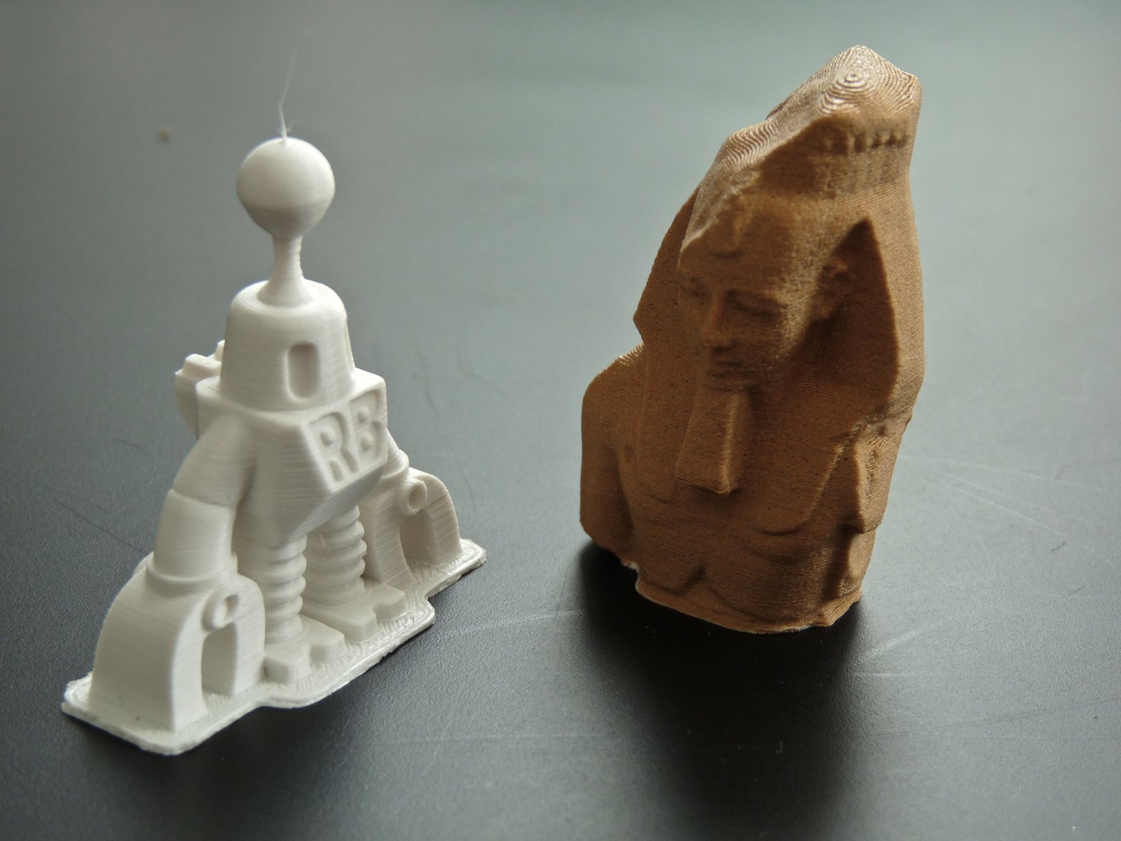

PLA and Polywood print on a CelRobox. Standard quality. 195/210°C, Polywood print with slightly reduced speed.
Hi there! Those are really good print, but please bundle your printing experience in one thread instead of making a new one for each print :wink: Of course you can post whatever you want, but other people’s threads (they might need some urgent help with their printer) do not get seen this way. I do not want to insult you or start any online rage-discussion (this already happened and it is just unnecessar), please take this as a handy advise ;-). What exact speed and layer height did you use? The overhangs look really good, but I can not see how your printer managed the “beard-like” overhang thing of the wooden figure, a picture of that would be nice. -Marius

Ramesses is printed with layer height 0,2. I myself was surprised with the little overhang, maybe because I reduced the printing speed with 0,75. I want to print it again with 0,5 speed. I don’t know the standard printingspeed in mm/h.
Interesting to hear, that you can only modify the speed by a factor, not by the actual mm/s. The layer height of 0,2mm is a good choise for fast prints and I guess your printer manages overhangs with this layer height very good.
Why not try out 0,1mm layer height (or even less if possible on your machine), the prints could get a little bit more detail, especially the top surface, where the layers are clearly visible :wink:

I will look what the default speed of the CelRobox is, I just don’t know yet. Speed adjustment is from half to double (real time). The other print “Mattijs I” is 0,1mm layer height with normal speed. I think you are right about the “best ratings”, but first I want to know the Robox and the filaments better.

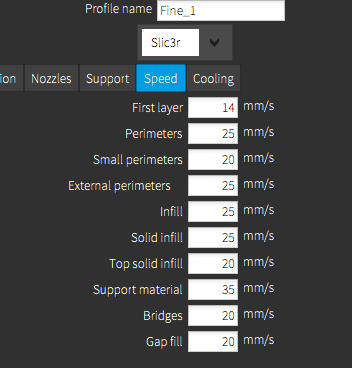

Got it. CelRobox has 3 preset speed profiles: Default, Slic3r, Cura. In advance mode you can make your own profile. When printing, you still can adjust the printingspeed (from half to double) factor as mentioned earlier.
