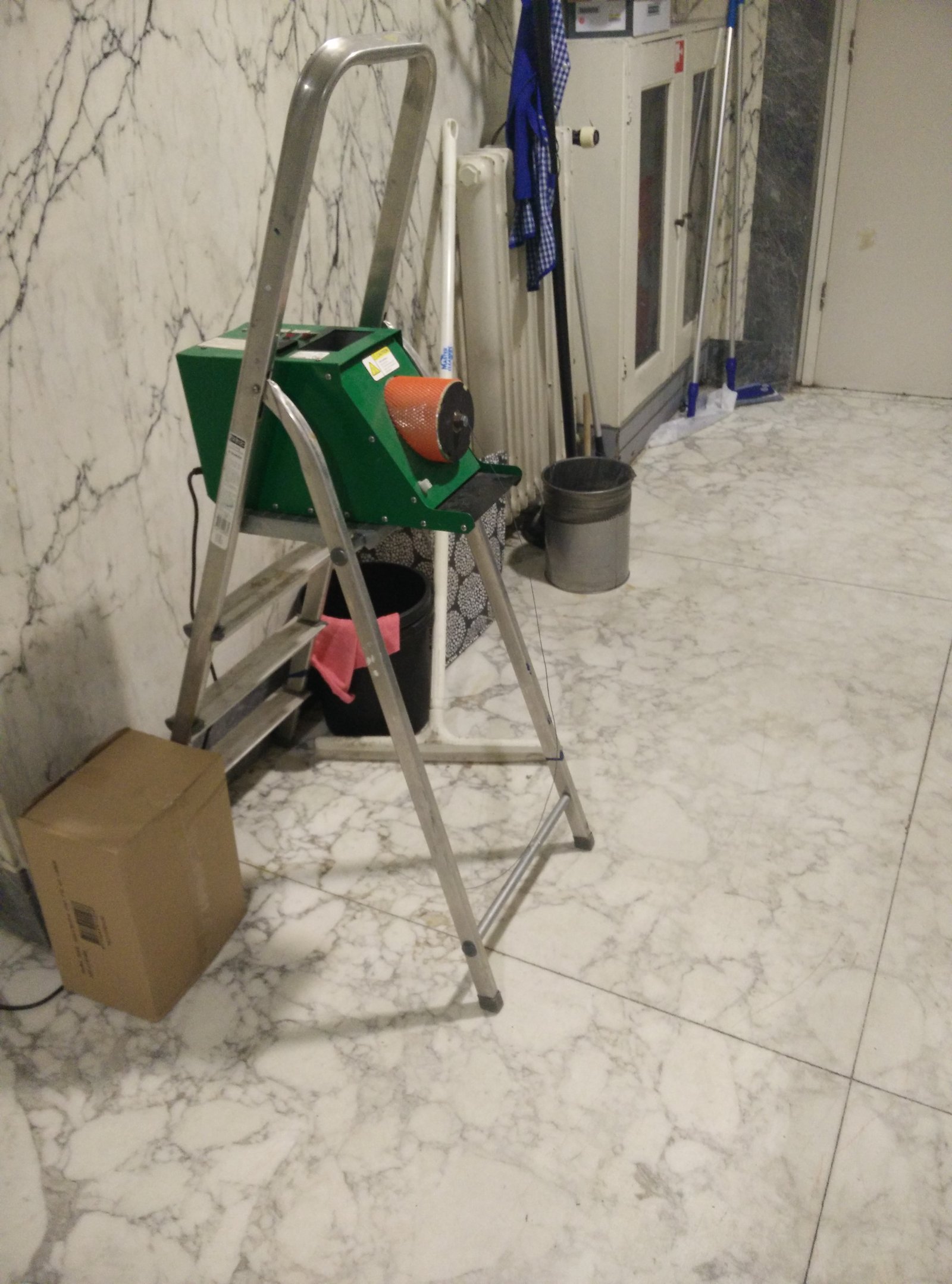

Challenge 2: Extrude PLA at the right diameter
This didn’t turn out that well unfortunately. With a 1.75 mm diameter nozzle I wasn’t able to extrude the diameter at 1.75 mm. In fact the average filament diameter was about 1.30 mm. I tried extruding at 130, 140, 150 and 160 degrees each yielding similar diameter results.
So I’d really appreciate it if you guys can tell me why this is happening and how the diameter can be increased?

Hi Bram,
With PLA you might need to use a larger nozzle. It sounds like the PLA is getting pulled from the extruder to much. A larger size nozzle would allow the filament to be pulled to the correct size.
On another note we have a spooler system that we are currently getting onboard and should have it available soon. This system can be dialed in to pull the filament from the extruder to the correct size and it also spools the filament.
