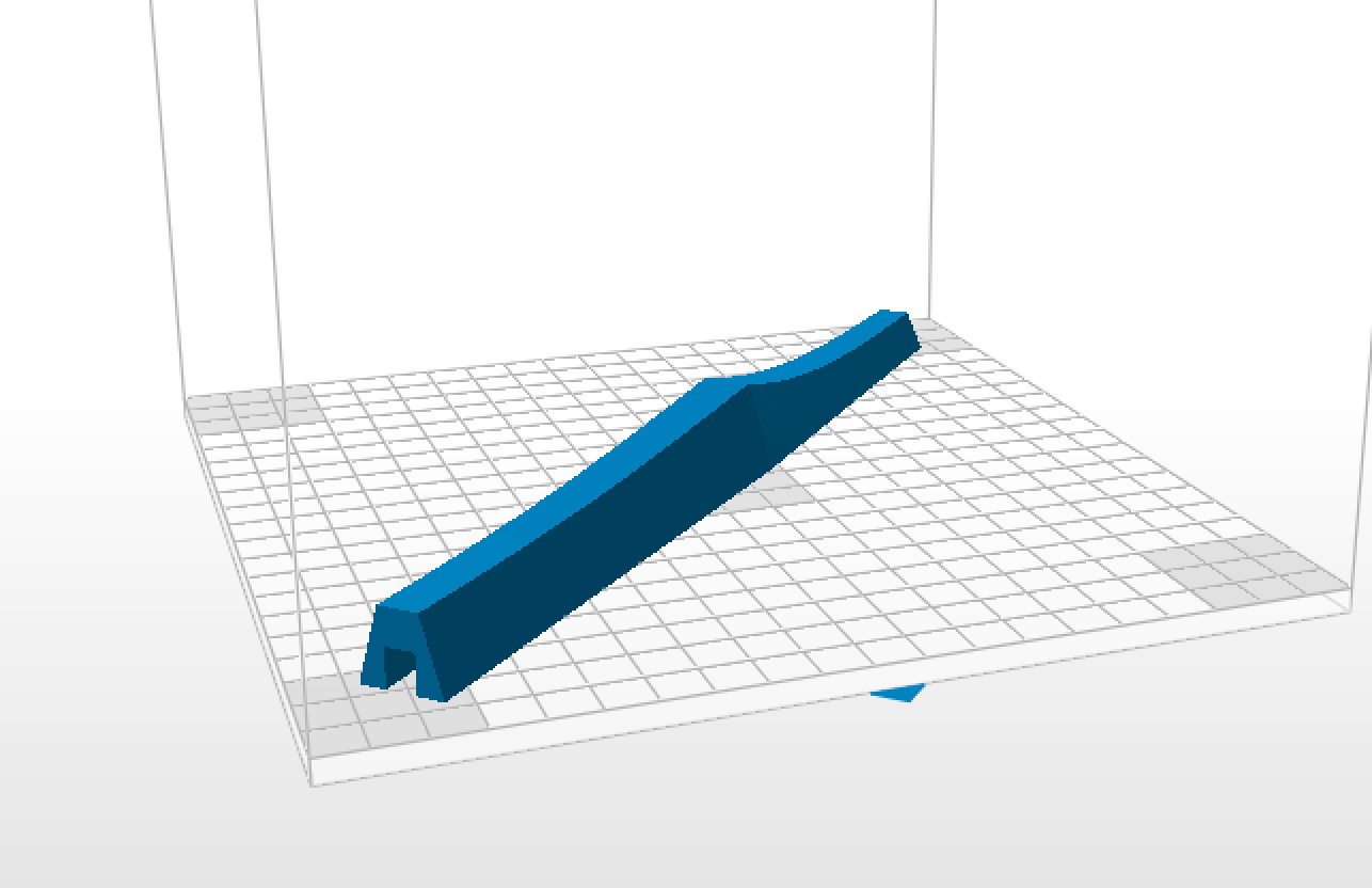

I need to print a handle for a sword that is 23 cm long (see file attached), but the hubs I have contacted so far can’t handle (excuse the pun) that length. I don’t want to print the object in 2 pieces and glue them as the resulting object would present a line of weakness especially when exposed to substantial amount of shock.

  1. Keep searching for someone who has a tall printer who can print your sword standing up. Keep in mind this orientation is actually also the weakest because the tensile properties between layers is around 50%. So if you use it for sword fighting there is a chance it will break between the layers. Standard infill is around 20%.
  2. I’d suggest splitting the part in the middle like in the picture attached. This kind of print is very risky as through my experience, long parts like these always warp. BUT if they don’t warp plus you don’t mind sanding and glueing them together this will actually give you the strongest build for sword fighting.
I have a Zortrax M200 and I have quite some experience in printing large ABS objects like these that usually warp. It’s one of the best machines out there for such cases but I must advise you it doesn’t always print warp free. It strictly depends on the geometry. If you’re interested we can talk about it more at @3DMuse. I am stationed in Germany.

Solution 2 sounds like a good solution, as a matter of fact real sword handles are made of at least 2 parts (of wood) glued together along the line of their LENGHT, like in the picture you attached, and then wrapped in cord and leather (see this video, for example: Euro Sword Grip Making: Part 1 - Wood Core - YouTube )
