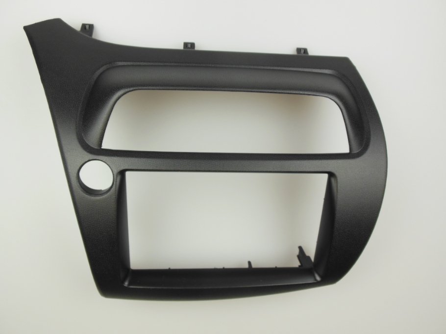

It’s been a couple weeks I am trying to find out what would be the perfect Material for my project:
It’s an car audio project, I would like to duplicate the Dash Bezel of my car.
Thereis 2 parts:
- Front: The one facing you when you drive, need to be solid and slightly flexible, ABS should be ok for that I guess (stuff like that:)
- Back: The part snapping into the car, this one need to be really flexible but really strong and rigid at the same time
I have a video to show you:
So if you could help me to find out how to do it, and if you think it’s doable via 3d printing, I have already all the design done via Autodesk Invetor (took me 3 weeks)

1 - I checked like you asked for the part in the video (the flexible black one), and it says PC/ABS
The most important thing for this part is that it has multiple SnapFits, and it would need to avoid breaking when installed (and removed) from the car. I dont know if ABS can handle that correctly, what do you think ?
2 - The other part (The front bezel) doesnt have any indication on it. The most important part is that it has to be solid, easy to polish and finish and custom paint. Probably also resist to heat as a car could be very hot during the summer. So ABS maybe the solution
3 - The 2 parts gonna have to be glued together and really stick. So i guess the best would be to use ABS for both to ensure this assembly to last
