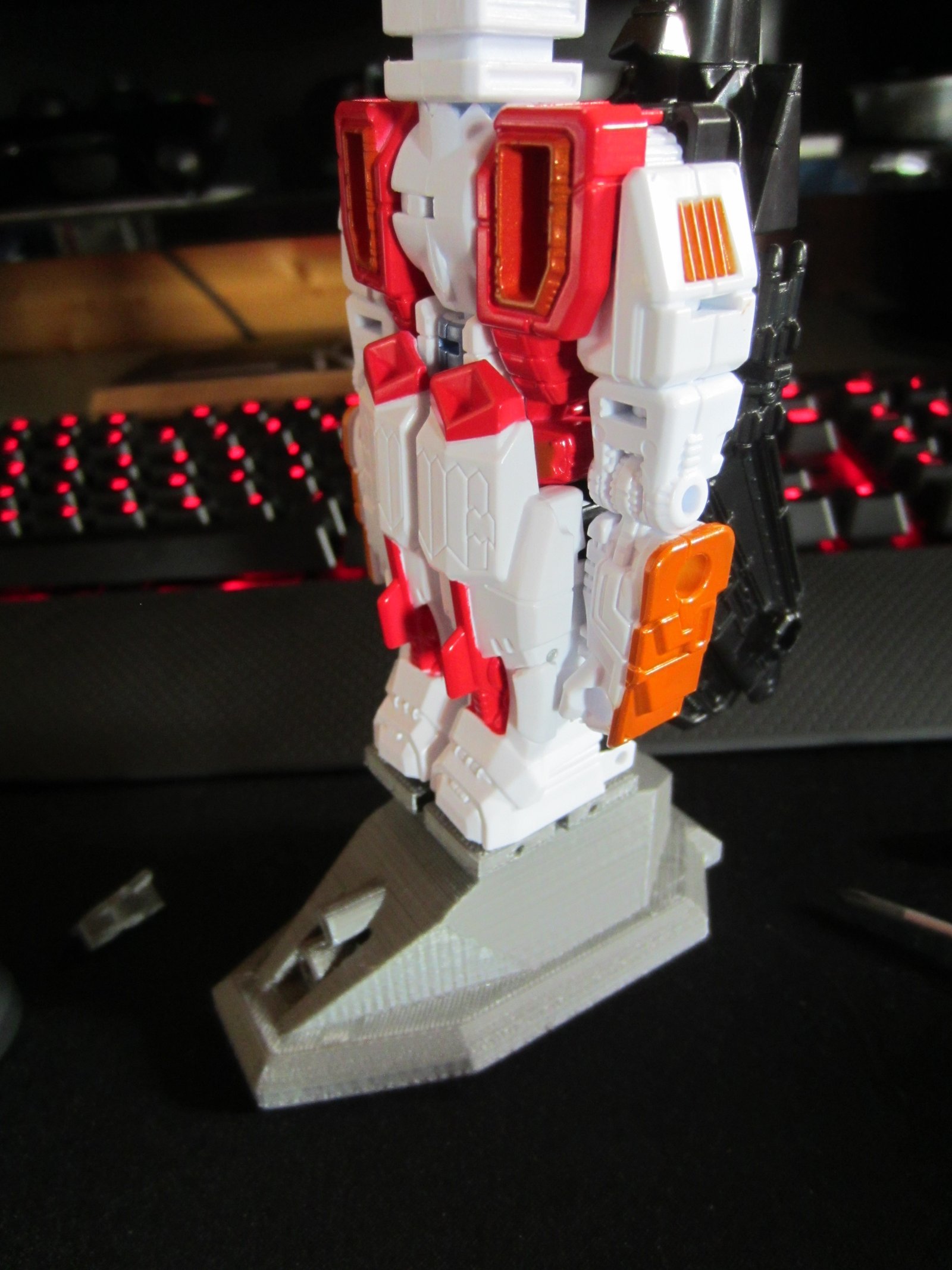

I just printed a large combiner feet for my Combiner Wars Transformers Superion. It’s a big too big :stuck_out_tongue:
Printed at 200 Micron cause else it would take 10 hours to complete, now just 5.
