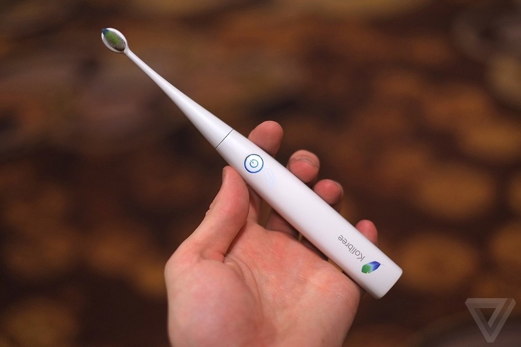

I have sanded an ABS print I have made and used a primer, 3 coats of paint and am I now trying to figure out which final coating I should add to give it a really nice smooth matte feel… I have seen a number of products that have this really smooth matte look and feel without looking to shiny, similar to the below image, any ideas how they get that effect?
