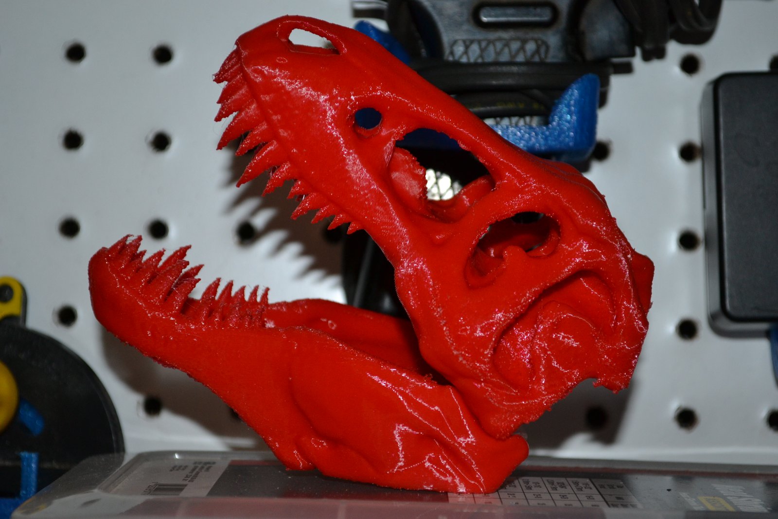

This is a Local Brand; manufactured here in the center of the United States! :slight_smile: , I purchased this filament from makergeeks.com, I love their Filaments! They never clog my custom or my stock extruders. The T-rex was printed in red PLA at 230 degrees celsius, it printed shiny! but it is an iridescent shiny. It is cool I can not do This awesome filament true justice with text. I have printed with several different PLAs and makergeeks is by far the very best!!! I love their natural PLA! PLUSS I always get it super fast! Once you try these filaments you will never order anything else I promise…and 24 buck a kilo with free shipping! http://www.makergeeks.com/mafigrbag2kg.html , I don’t know these filament manufacturers other than by their product.

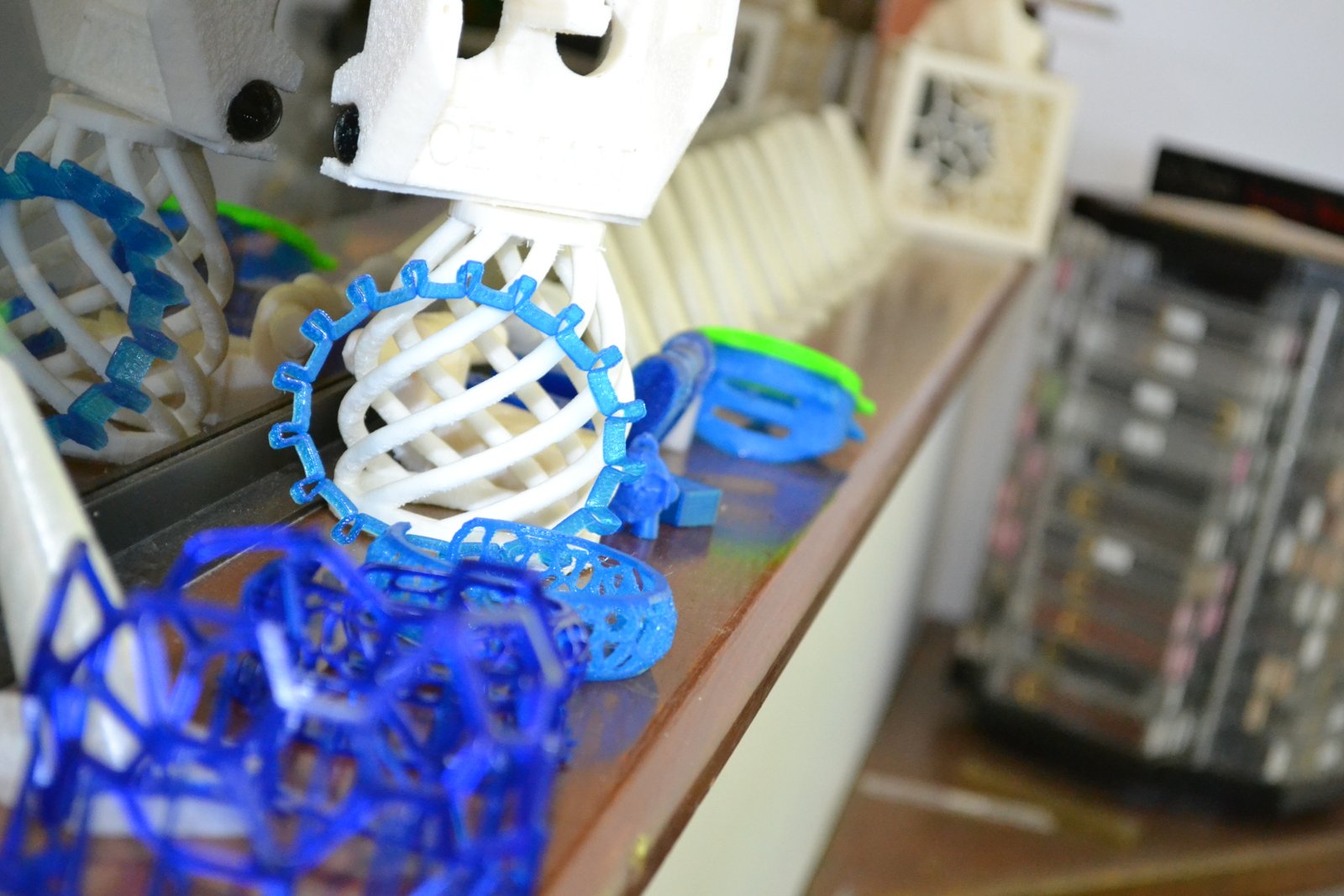

The “blue” print pic is a formlabs casting resin,
