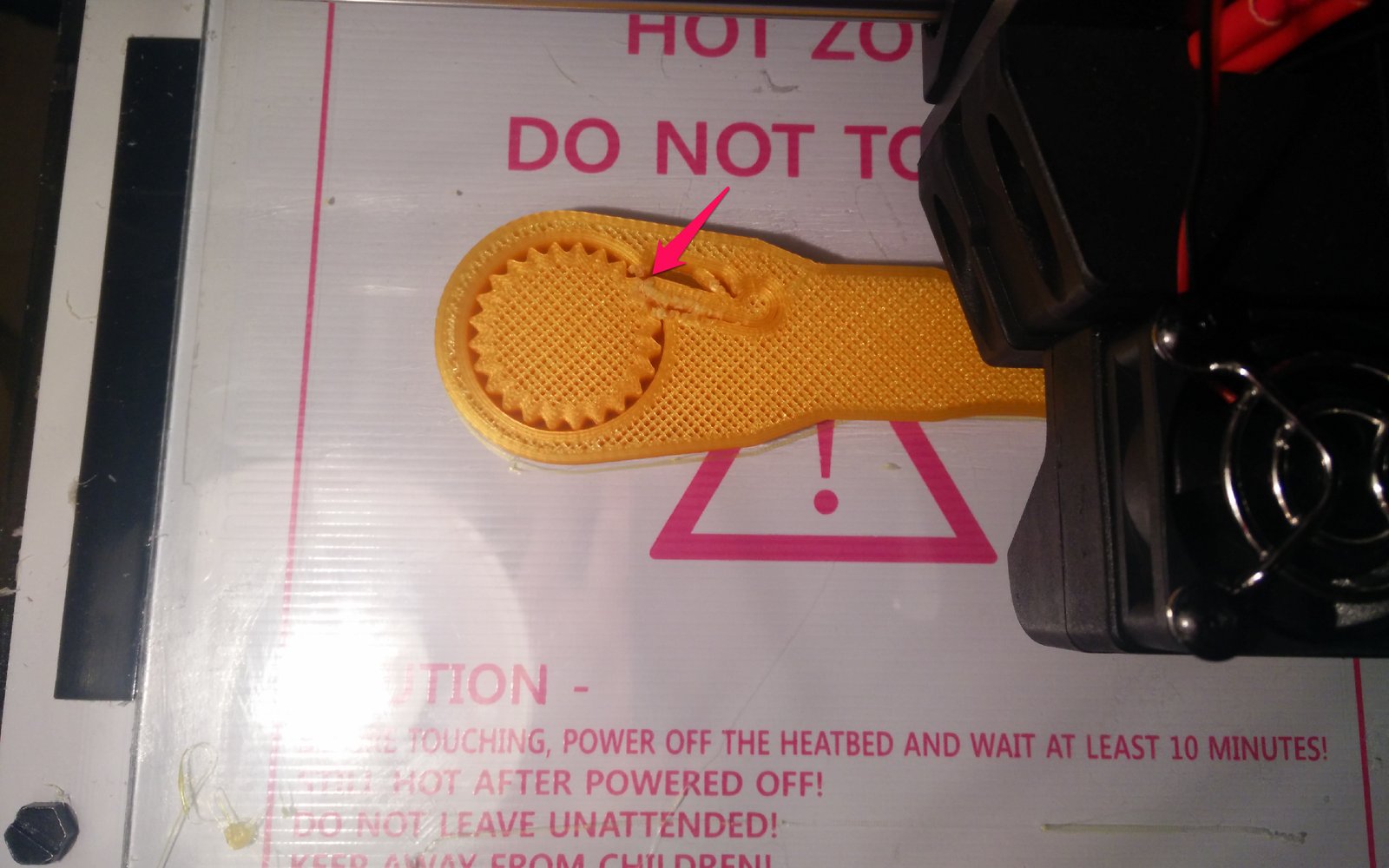

It seems to be a pretty straightforward one , but I can’t pinpoint what I should do exactly. The main question is - what should I play around with to determine the perfect settings for the printer to place the filament in the accurate location. E.g. The Nasa wrench requires quite a precise point for the whole thing not to be printed stuck together, but I can’t achieve that although the prints turn out really nicely (visually).

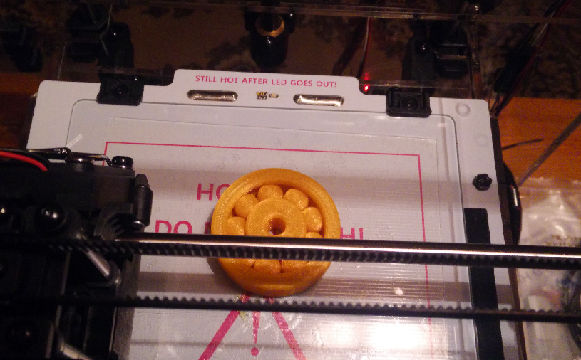

For example this bearing printed fully stuck to everything without anything moving (granted I scaled this one down to 50% of its original size)

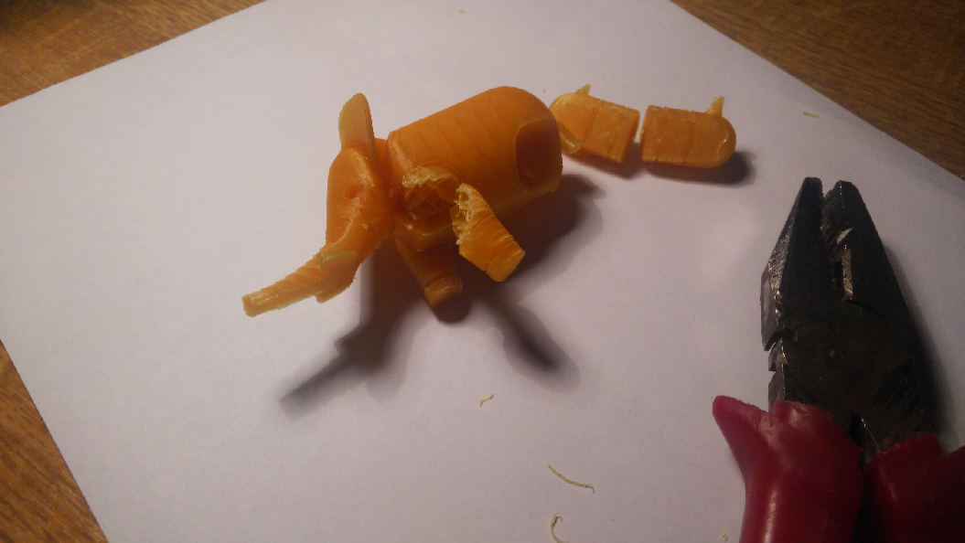

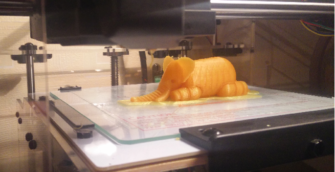

Same happened with this beautiful elephant (turned out pretty well , but the legs were stuck)
Well, not exactly stuck. I managed to move them, but I am not sure if this is how it is supposed to work (??)

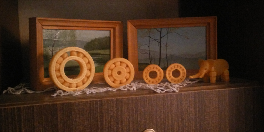

One thing I did was realize that my Cura was interpreting the filament diameter wrongly and fixing that helped a little bit. Along with reduced temperature I managed to print the big ball-bearing which actually moved, but it wasn’t perfect still.
The big bearing and the elephant are actually moving now, but still not as smooth as I’ve seen other prints do. (I know that this visual with the kick-ass soviet union art in the background really helps me tell the story)

over extrusion or too high a temp would be my top culprits. i would reduce the temp by 5 degrees at a time and see what the lowest temp was that gave good results.
Reduce the extrusion multiplier / flow rate and print at 100% size (no down scaling).
While printing the printer presses the filament of one layer onto the material of the layer below, if the flowrate is too high (100% might also be too high) the filament gets sqashed to the sides, meaning that the printed lines get wider. At one point the lines are too wide and will touch, even though there was a clearance of 0,2mm or alike set in the 3d file.
If you scale down the model you reduce the clearance aswell making the above described issue more likely.
Reducing the temperature might help a bit, but I’d go for more cooling, instead of less temperature. You still need the layers to stick to one another so you shouldn’t go too crazy with cooling and temperature dropping. Some cooling may help to get cleaner edges and it prevents “stringy” prints, in which the nozzle oozes material out during travel moves, those strings can cross the outlines of two seperate parts, causing them to fuse together => nomore movable!
