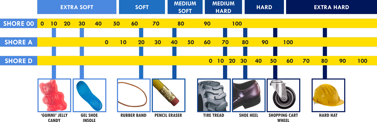

I am very confused about the Shore Hardness scale. In the 3D printing environment, people talk out Shore Hardness of A 75 being very flexible, but when you look at the durameter scale, then a shore hardness of A 75 is hard, as shown on the enclosed picture.
Hi plisberg,
I think that the shore hardness displayed for the filaments are at ~ 100 infill, they are more flexible otherwise.

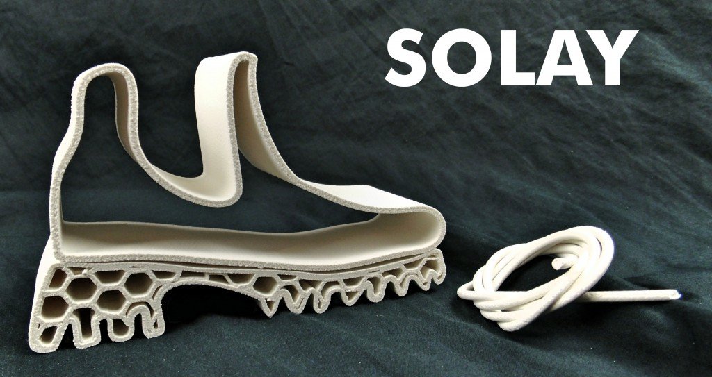

This stuff would probably be ideal. I love experimenting with Kai Parthy’s filaments but unfortunately this one is only available in 3mm. I’ve been hoping they come out with a 1.75mm so I can try it out.
-Jesse
