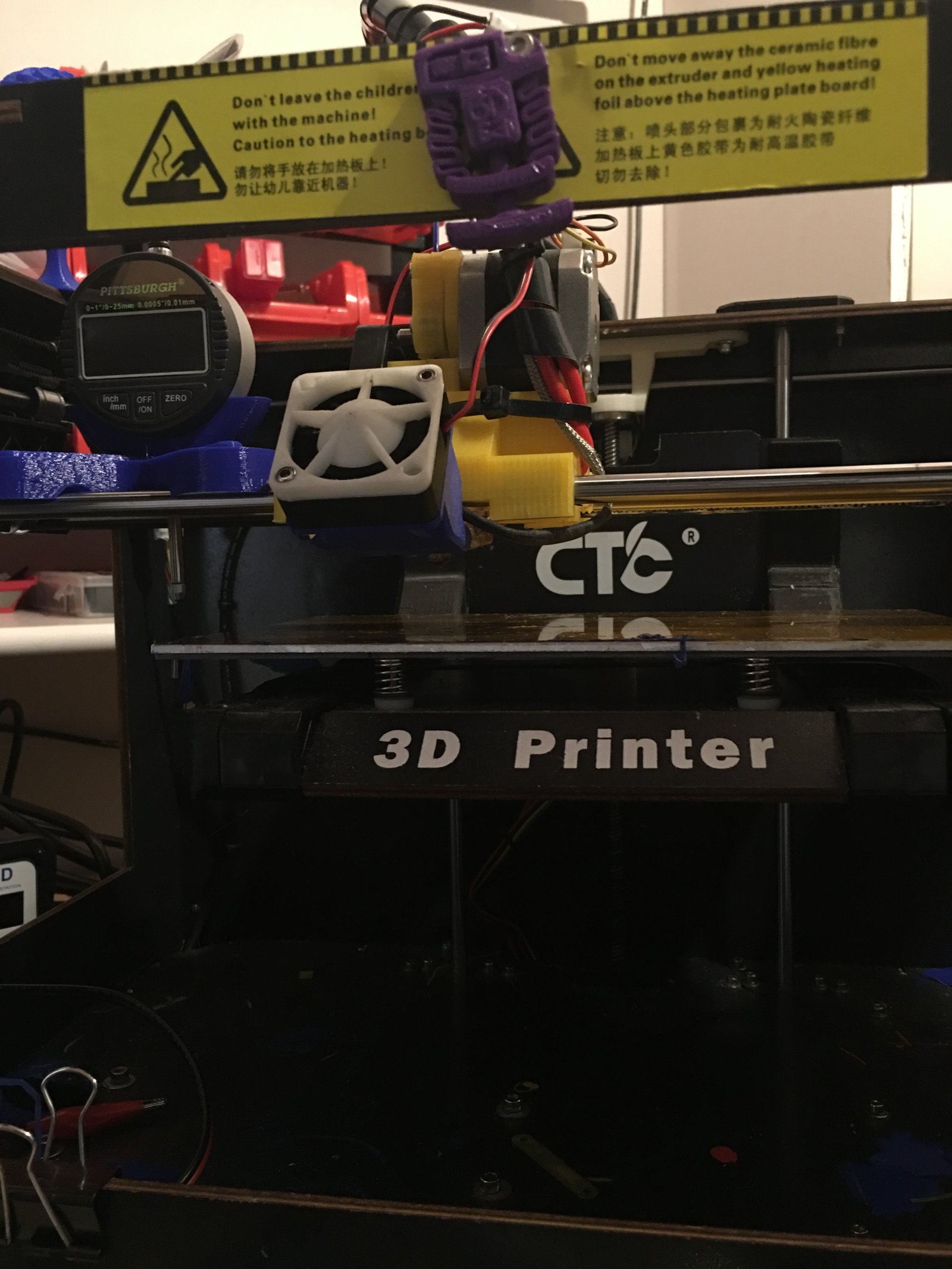

Thank you Chris, i saw your picture and is that an extra fan? I watched several videos about installing another fan but can you tell me which one you bought? Cheers, Sky
