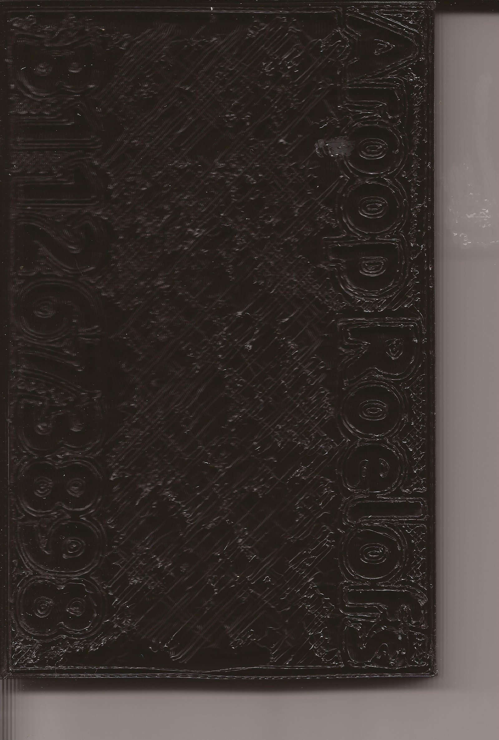

I tried to make a little card with a code of mine (it’s a tracking number thing for a game, nothing special).
However, as you can see in the scan I made (I just slapped it under my old flatbed scanner), the quality is just horrible.
Mainly around the parts where it has to work with “blank” space, the numbers and letters are pretty fine and quite strong.
When I pinch the print between my fingers on the “blank” space, I can hear and feel it crumble when I apply a small pressure.
I didn’t make a scan of it, but the first layer lines are very thin as well.
Now, of course, I want to improve it and I’m curious what causes it, and, obviously, how to fix it.

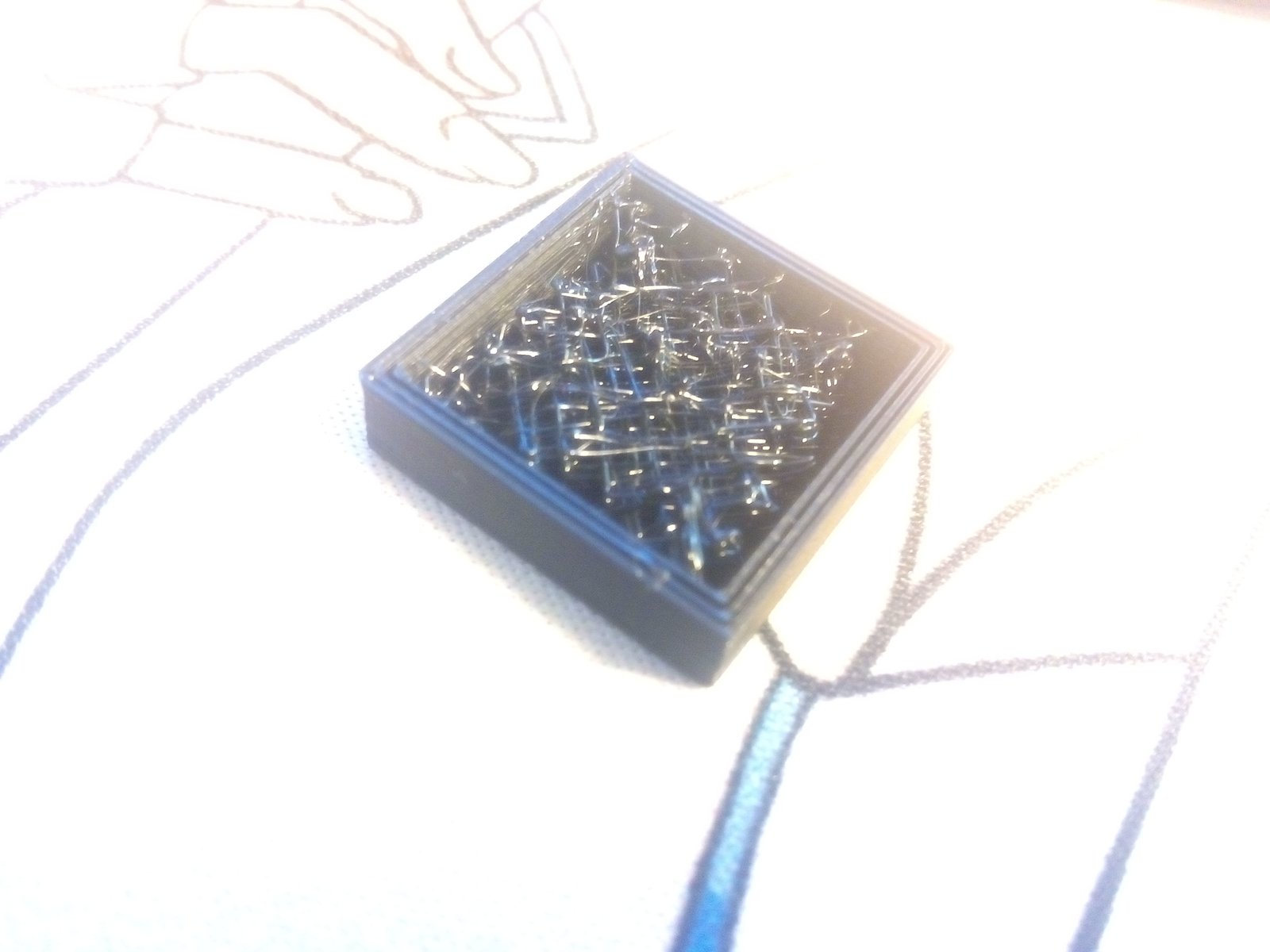

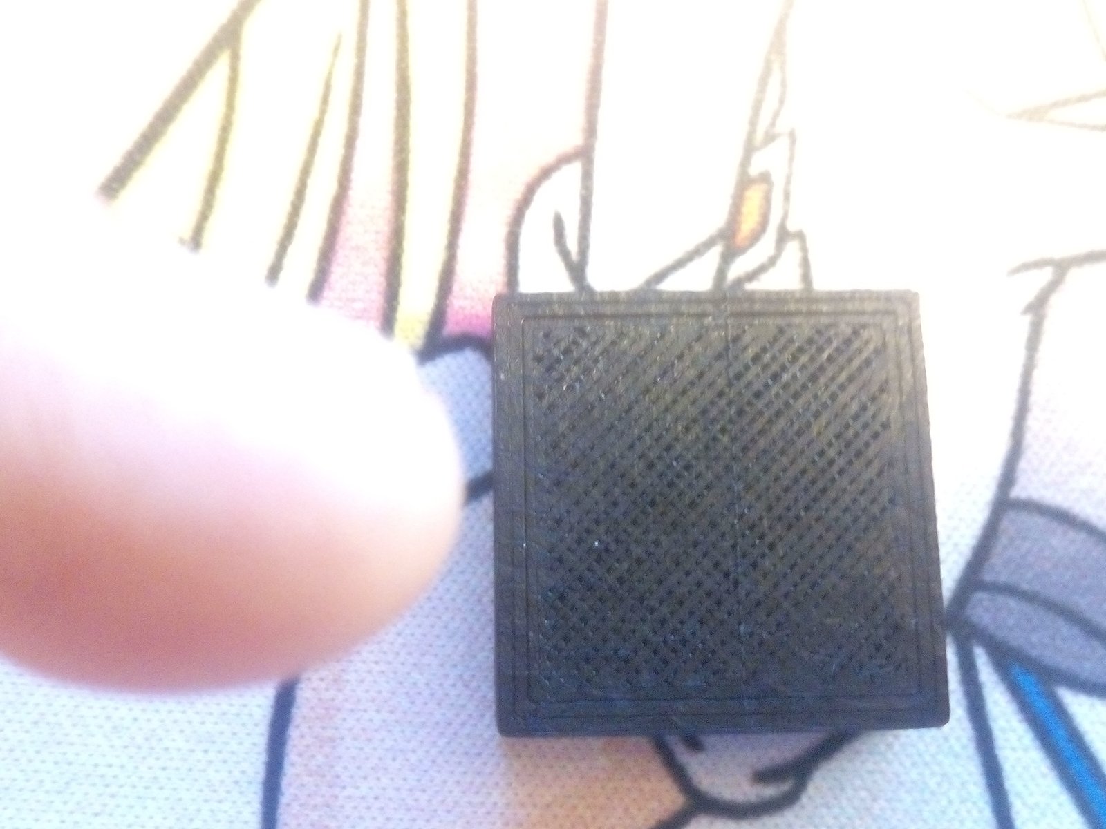

I didn’t have the time to level it, but I made this little print (see pictures below?).
I’m sorry about my camera, it’s horrible (wouldn’t expect more from a 160 Euro phone lol)
I made this little “thing” by making a 20mmx20mmx20mm cube and then stopping the print at about 25%.
The infill density was 100%, and the speeds were all 35mm (except the “Travel”)
Layer Hight was actually 0.1mm.
The “wall” (perimeters?) where heck a clean and strong, just the center/infill was rubbish.
I pulled the thing apart and this is what I found as well:
the 3 perimeter layers were strong and as clean as expected.
The 3 bottom layers were strong enough, and almost as clean as expected (could be better, but not a big deal)
I hope I could provide you with enough information right now :slight_smile:
Just as I thought, wispy infill. Decrease your speed for infill, lower temp, not sure what the auto setting for speed is doing. But you are definitely printing faster than your extruder can push infill out!
