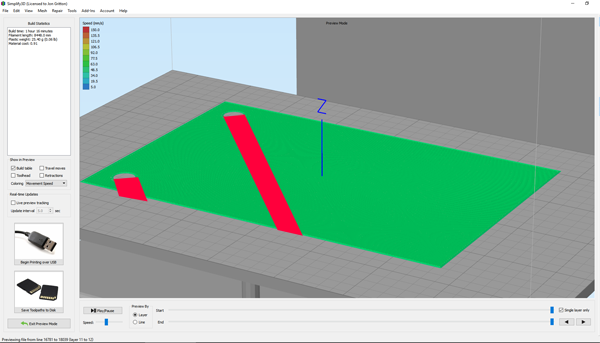

Hi all, a very simple print is showing an odd error. It’s simply a rectangular plate, 3mm thick, with two holes near one shorter edge. It’s not a complex mesh, according to netfabb and makeprintable and any other checker I can throw at it, it’s got no errors. When printed, on the final top layer, the printer appears to simply “forget” to finish a couple of sections (see image - I haven’t used a photo 'cos it’s virtually impossible to see). This is a screenshot of the final layer in Simplify, which shows that the layer should be complete and even.
However, when printed, it misses the bits I’ve crudely highlighted in red. It’s just as though the printer has forgotten to go back and fill these missing parts in. It’s only on the last layer, all previously layers - including the previous solid layer beneath, were fully completed.

I have S3D and I noticed on a print I was doing last night that those areas you highlighted are printed last on a layer. I had a couple of times in the past, where I saved the gcode to the SD card, and when I printed it, the printer stopped before the print was done. I noticed when I re-wrote the same gcode, that the file was larger. I was thinking that maybe I removed the SD card before Windows finished writing the gcode file to the card, even though S3D says the file was done. I think I might have looked at one of the gcode files in a text editor and seen that the file ended prematurely.m Do you still have the original gcode file?
