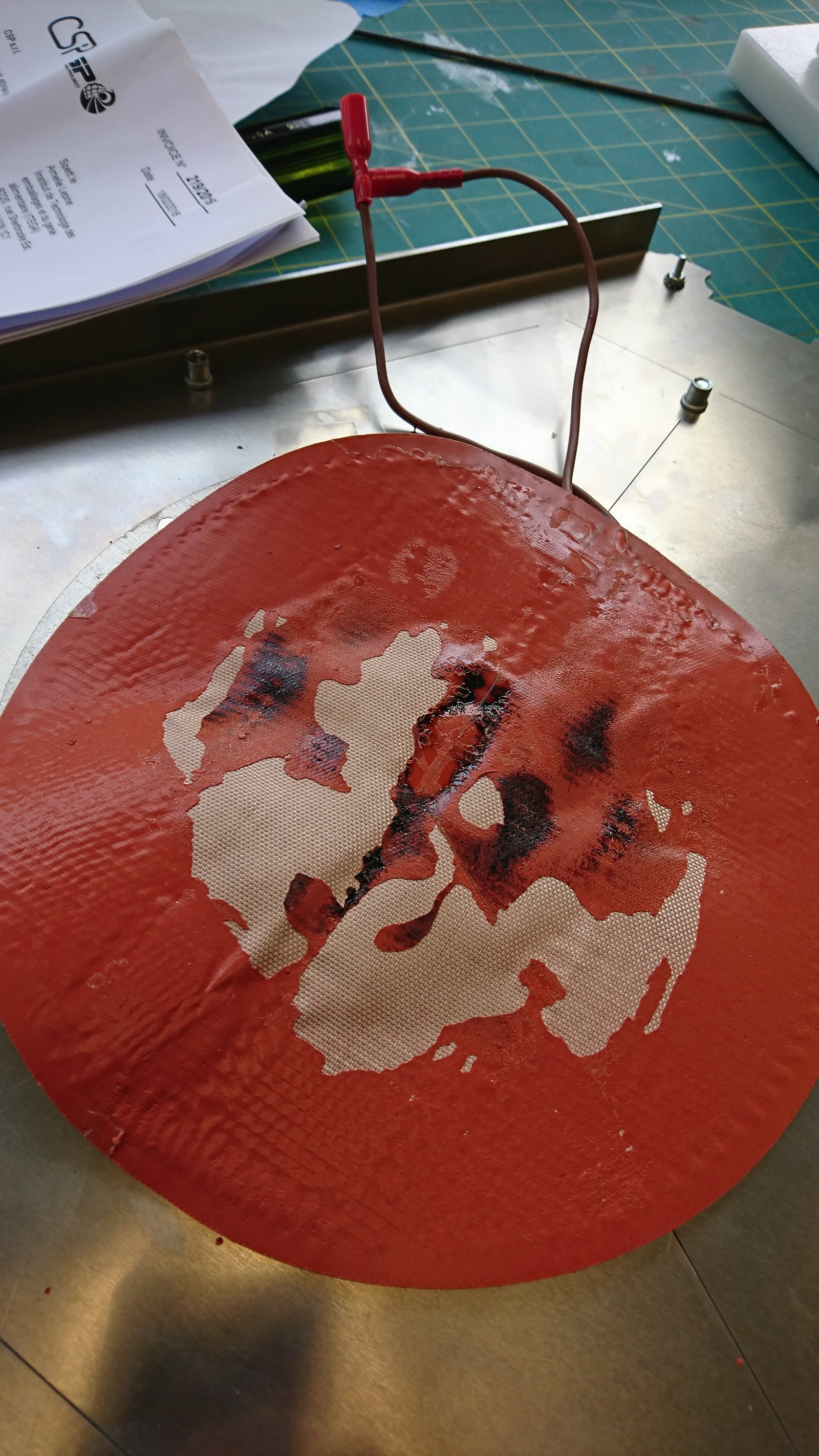

So I have dismantled the baseplate and found out that the heater and heat sensor both seem to be defective. Maybe the sensor has been giving a bad reading to the machine causing the heater to overheat?

Hi, I don’t understand how you can say that the heater and the sensor are defective.
The heater can’t overheat, becasue there is an emergency termal lock built in.
I suggest you to don’t change these coponents un your own, because the placement of them is very critical for the print quality.
3D printers aren’t very complex machines, but a bit of experience is needed to avoid to make trouble. I suggest you to call a professionist to get support.

Please see attached file! : )
This is what makes me think that the heater overheated. Also the dense smoke coming from underneath the base. And the firefighters and sprinklers. Kidding. But still, I am pretty sure the part is bad now.
