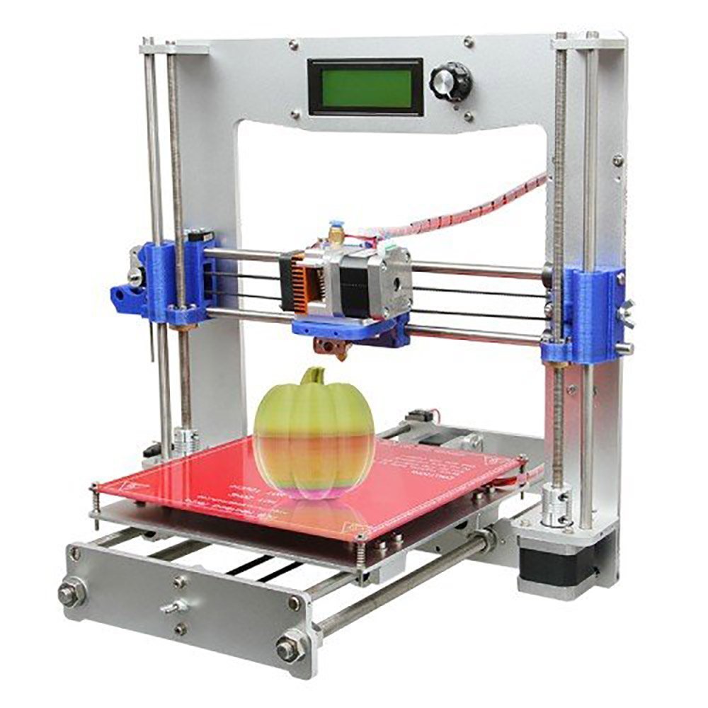

Hi im looking to buy my first printer, at the moment my budget is not too great so ive been looking towards the DIY kits as im confident with construction. ive been looking at these.
http://www.amazon.co.uk/WER-Prusa-Mendel-Aluminum-Frame/dp/B01462X6OO/ref=sr\_1\_9?ie=UTF8&qid=1445603520&sr=8-9&keywords=prusa+i3
http://www.amazon.co.uk/WER-Aluminum-filament-Printer-materials/dp/B0148CXWRS/ref=sr\_1\_12?ie=UTF8&qid=1445603520&sr=8-12&keywords=prusa+i3
But finding it difficult to see reviews and such, if anyone has any opinions they would be greatly appreciated, Thank You :slight_smile:
Prusa i3 designs in general are fairly reliable and well-performing. This is one of the Chinese variants, and I’ve had good experiences with them. However, 3D printer kits are nowhere near ready to print as soon as you finish building, and especially if it’s your first printer it may take you a lot of research as well as trial and error to calibrate and tune it well. If you have the patience for such a task, then it’s a great printer for the price. One thing of note with Prusa i3s, though: in my experience since they’re built with the bare essentials for a frame, the build quality isn’t all that great and slight bumps can misalign the axis, giving you less-than-perfect angles. This is particularly apparent in the aluminum single-sheet Prusa i3 such as the one you linked, since there are no supports at all for the single sheet frame (most wood and acrylic designs mitigate this somewhat). The only two exceptions I can think of to this flaw are the P3Steel and the Wanhao Duplicator i3, both of which are built and reonforced with structural steel.
