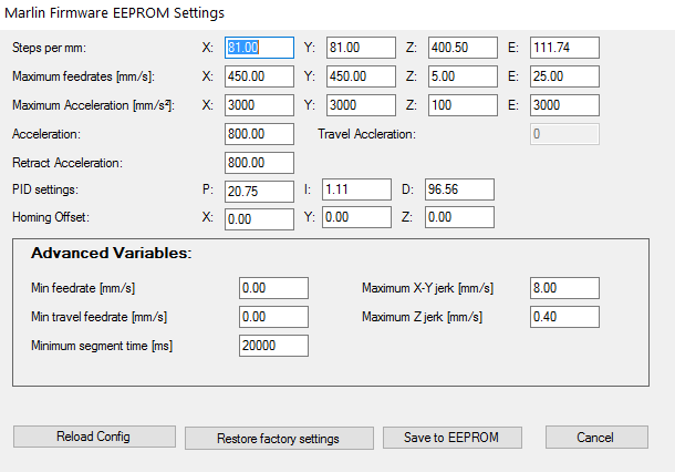

Decided to tune my I3 plus as best I can and so wondering if Im on the right track.
Things I’ve done just done:
1.PID auto tune
2. Esteps calibration (this was off by 11mm)
3. LCD firmware upgrade.
4. Just about to install z brace mod.
5. Lowered jerk to 8.
That’s all I can think of really.
Does anyone have any recommended values for acceleration and jerk and what I should change to as per below screen shot? Im looking for quality rather than speed so any suggestions are welcome.
Also, my prints have always been slightly too large and ive had to scale to 0.99 in cura to make them fit, what would cause this, X/Y steps off? How would I check/calibrate those.
Current eeprom attached.

Looks like the steps per mm are too high, which would explain your oversized prints. These are the settings I use on my Di3 and everything comes out the
correct size.
80.0000 X-axis steps per mm
80.0000 Y-axis steps per mm
400.0000 Z-axis steps per mm
10.000 Max. jerk
0.300 Max. Z-jerk
Thanks for the reply, ill input these values and see how it goes.
Not sure, I haven’t checked as I always print the same parts and they are all the same dimensions. I’ve just increased the e-steps as I was getting under extrusion so don’t think its that so the steppers must be off. I’m going to try the settings above and print to compare. Its interesting that my factory defaults for nearly everything are way off.
Sorry if it is a silly question, but what is that screenshot from? I’ve been editing the file directly in Arduino IDE.
