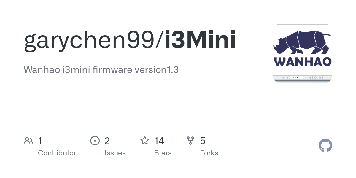

Found: garychen99 (WANHAO 3D PRINTER ) · GitHub
Who has posted two folders for the i3Mini under slightly different names, both generated the same night. Looking to see if there was a configuration.h customized for the printer, I cannot tell if any configuration was saved. I also suspect the version (1.1.1) found there is OLDER than than the version (1.1.4) my printer shipped with. However something deeper in must have been altered as there is notes regarding a bug fix applied to correct an issue with the z-axis.

Having tried the GitHub i3mini.rar download, I could not get it to compile in Arduino IDE 1.8.5 (or earlier 1.6.4) , as I too have the problem of unknown board, in fact unlisted board. I just get blank fields if I use Tools>Get Board Info, so your extract helps. I now know the board title, and that is a Mega/2560 Mega based, which is a step forward. having said that nothing like it appears in my Tools>Board list. I am only a very casual user of Arduino, so cannot begin to solve this part of the puzzle.

I did also take a little bit of time to use a comparative file checker to analyze the directory and file differences between the different uploads to the I3 section of GitHub. And although you would think that each of the posts were essentially the exact same thing for the same printer there are some noticeable differences. However I somewhat lost interest in the hunt and did not finish this Expedition. A thorough analysis based on date in an assumed identical revision between them may reveal more data that is useful to us in custom compiling assuming that the entire repository is there for an I3 specifically.
