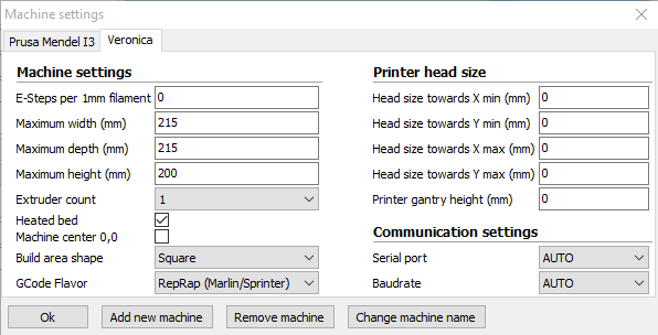

I have this printer!
Sounds like you need to modify your machine settings.
This is what my machine settings looks like (the link below). I called mine “Veronica” HAHAH!
I really hope this helps!
