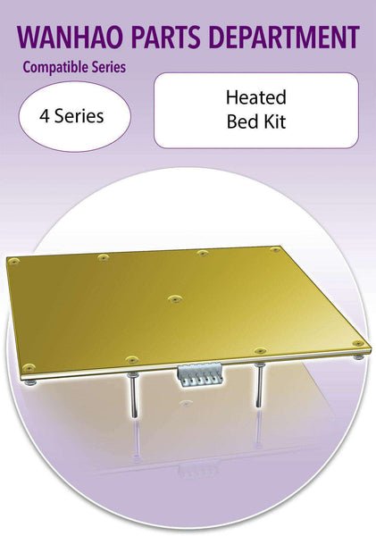

A thermistor is not going to cause half a bed not to heat. It’s a circuit board heater. It’s more likely that the connector is damaged near the board in or that the trace burned out. It would probably be better to replace it with a DC silicone heater.
https://www.ebay.com/i/271562093905?chn=ps
As a Makerbot Replicator 2 clone the print quality isn’t any major step down. Parts are still available. Bed upgrades as well. You can print on an unheated bed with PLA with no issues. So if you wanted to waste it then that is on you. You could use a multimeter to check continuity of all the traces. No need to use a non-contact thermometer. The price you pay for one you could probably fix this. One print could pay for the repair.
