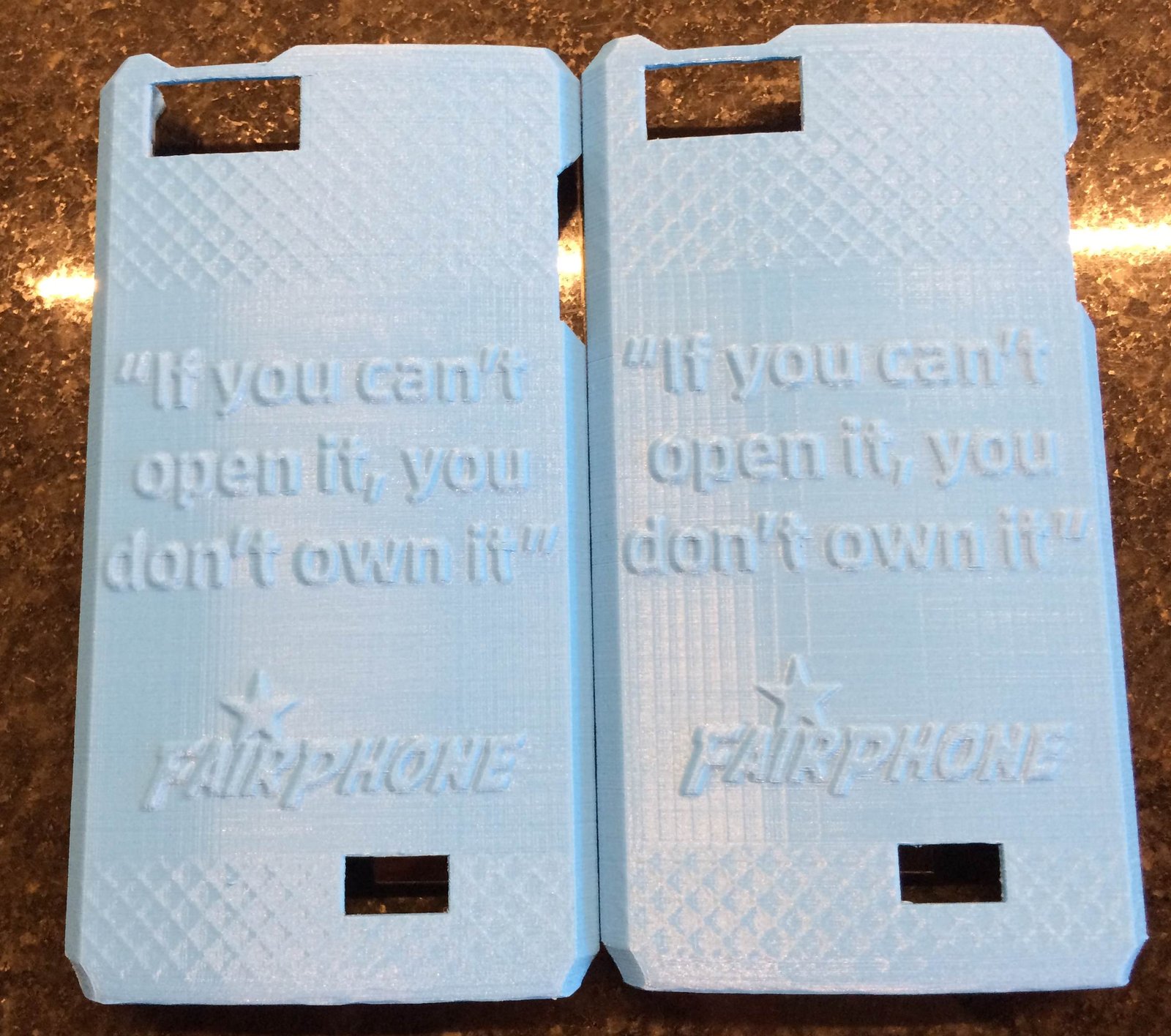

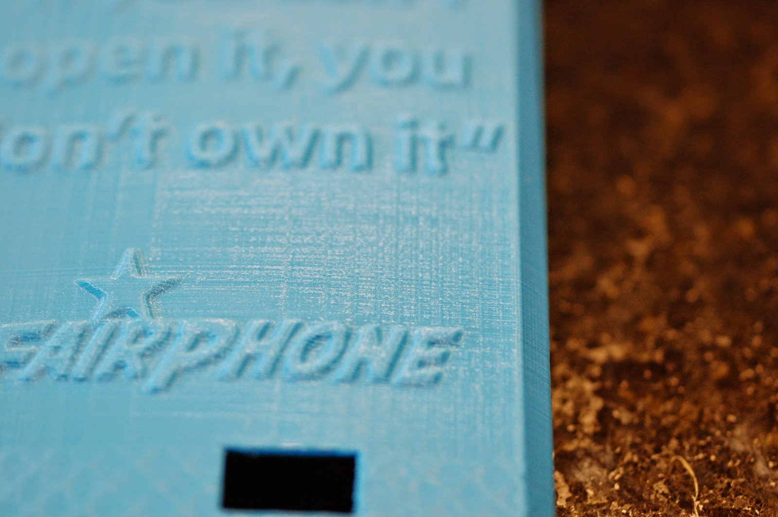

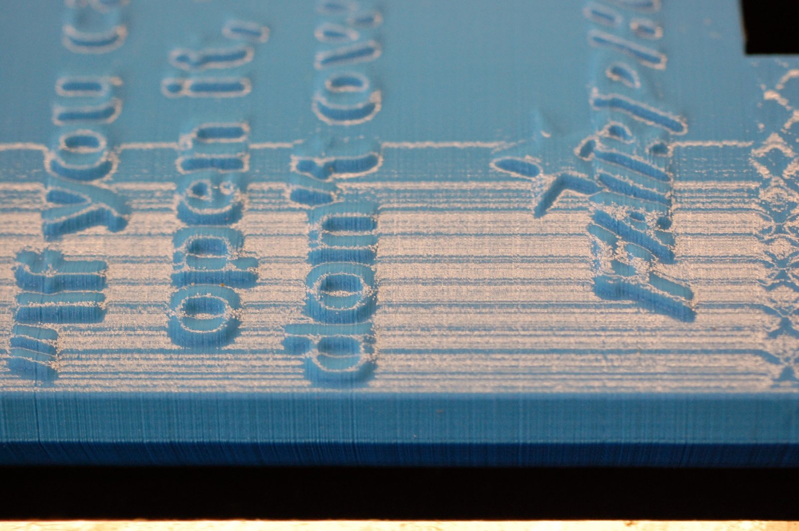

I have printed Day1, day4, test case and manifesto case. On the latter 2 where there are untextured aread, I get vertical striations.
The attachments perhaps exaggerate the issue and maybe I am being too picky. Unless you have light reflecting off these lines (as I do in the photos, as well as the fact that these were taken with a macro lens) they are far less noticeable.
I have seen other examples of this on other hubs photos, but I’d love to figure out how to eliminate it. I am acheiving good quality apart from this.

thanks for the responses, for the record, here are the 2 results for comparison. The only difference being the angle of the model on the bed, and I also printed a few degrees cooler as I realised I was possibly printing at the upper end of the range and thought it might help with the stringing across the gaps.
I still want to try alternative James’ suggestion of alternative slicers and will report back when I do.
sorry , to clarify, I printed at 15 deg from the front plane rather that parallel to the front or side.
