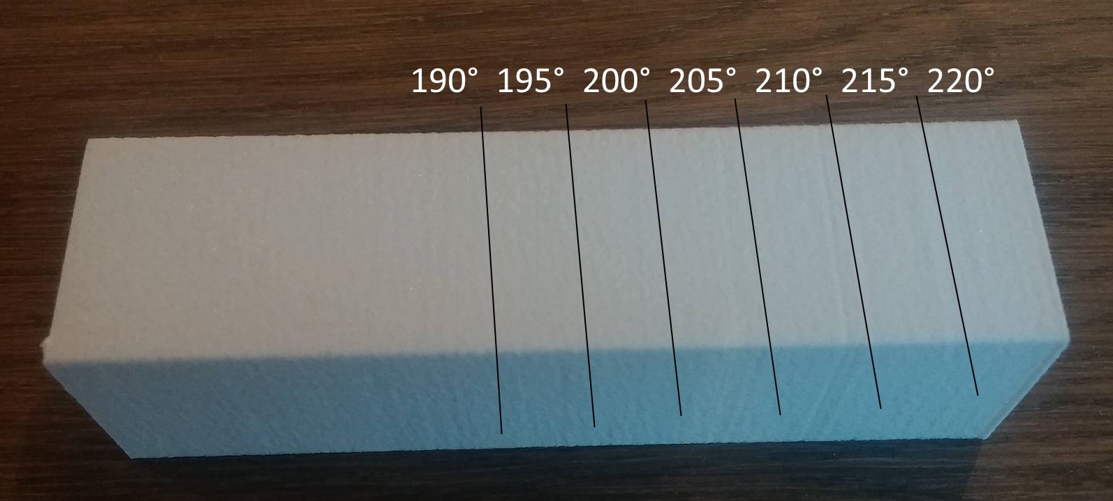

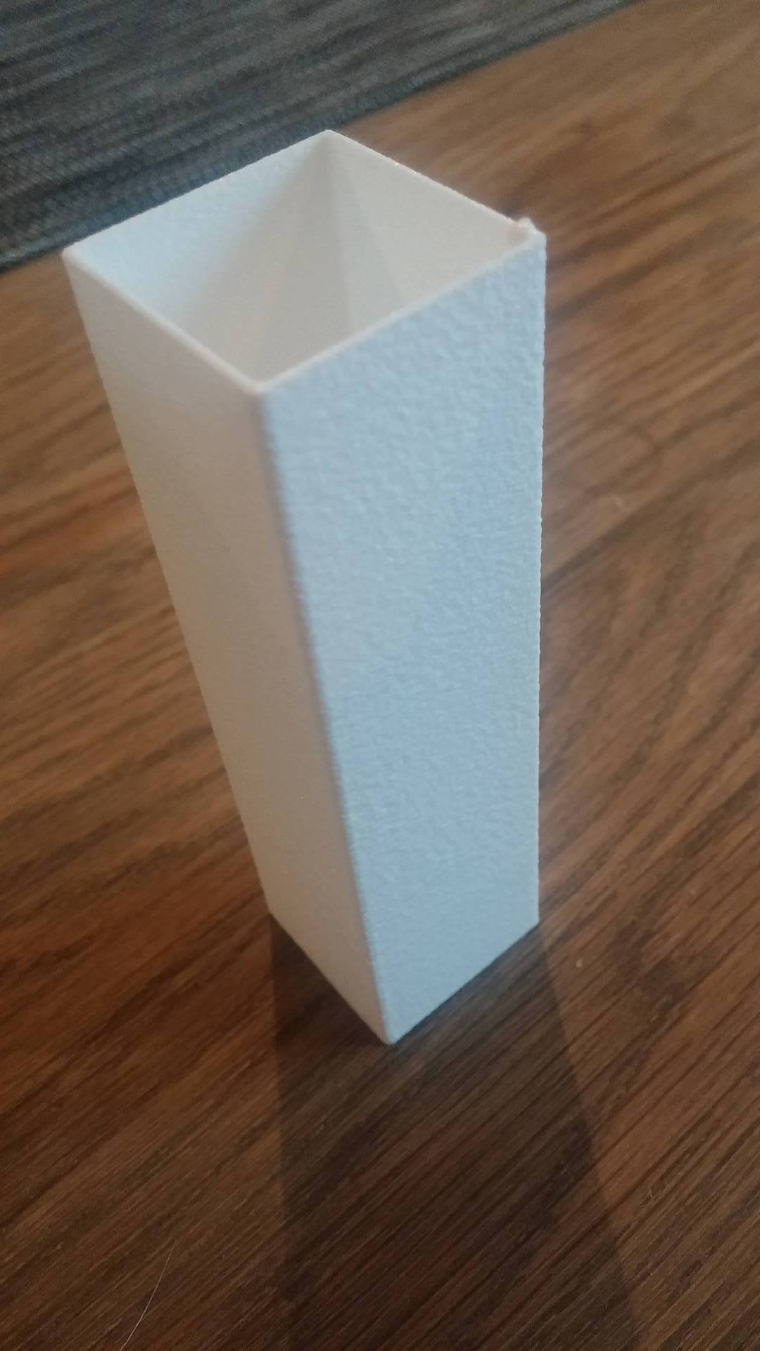

Since i had a clogged nozzle a month or two ago, the quality of my prints is going down. The surfaces of my prints are really rough, compared to the prints i had before the clogging. I thought this woud be due to the temperature, so i edited some gcode that prints a cube, and every 10 mm changes the temperature by 5°C. I started with 220°C and ended with 190°C. But weird enough, i see practically no difference between the layers. They’re all evenly rough in my eyes.
Could it be that the nozzle suffered from the clogged nozzle, or that it’s still a bit clogged?

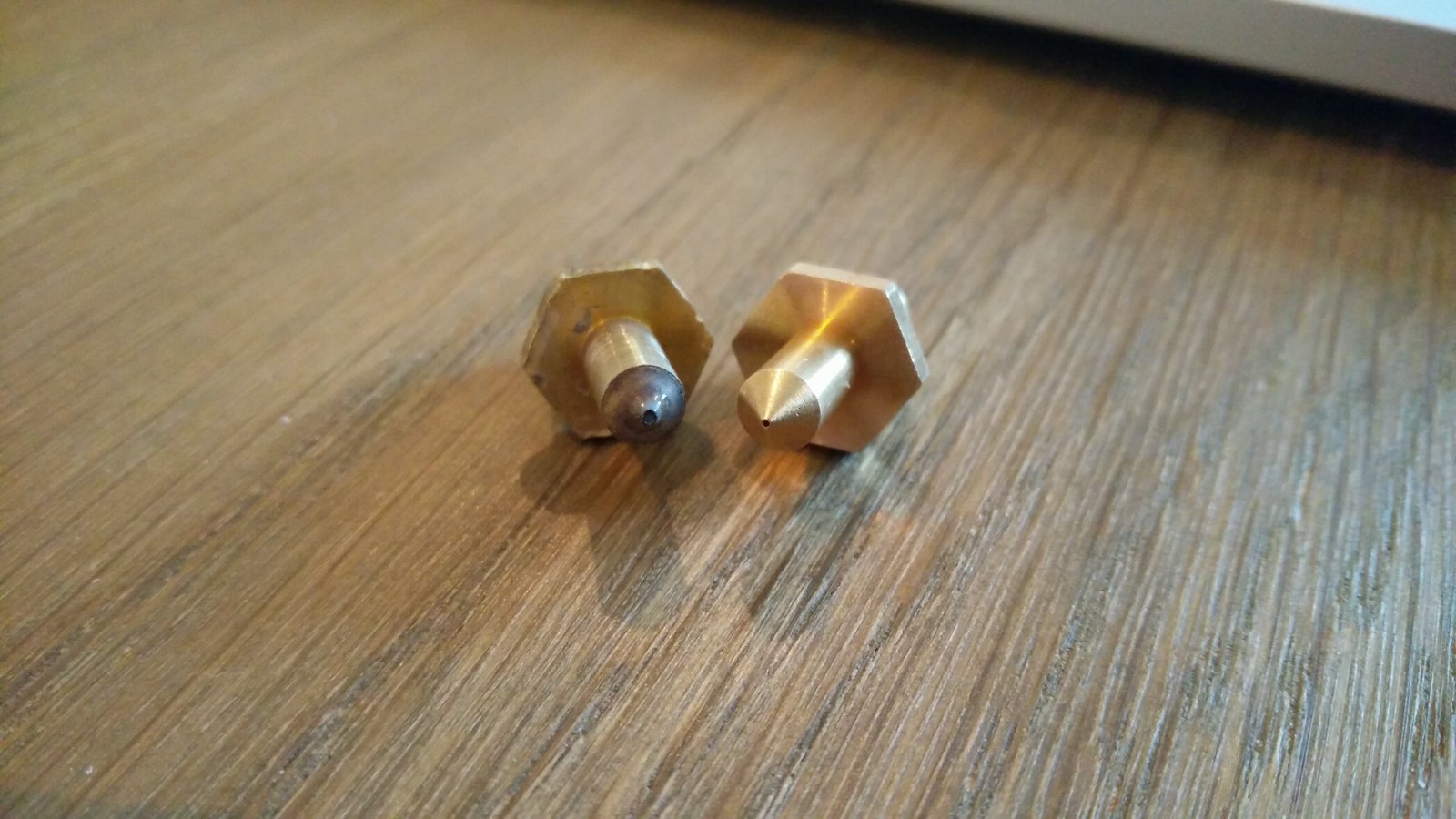

For anyone wondering, i have fixed this problem. My nozzle was completely broken, probably from crashing into the bed one time. So replacing the nozzle solved the rough prints!
