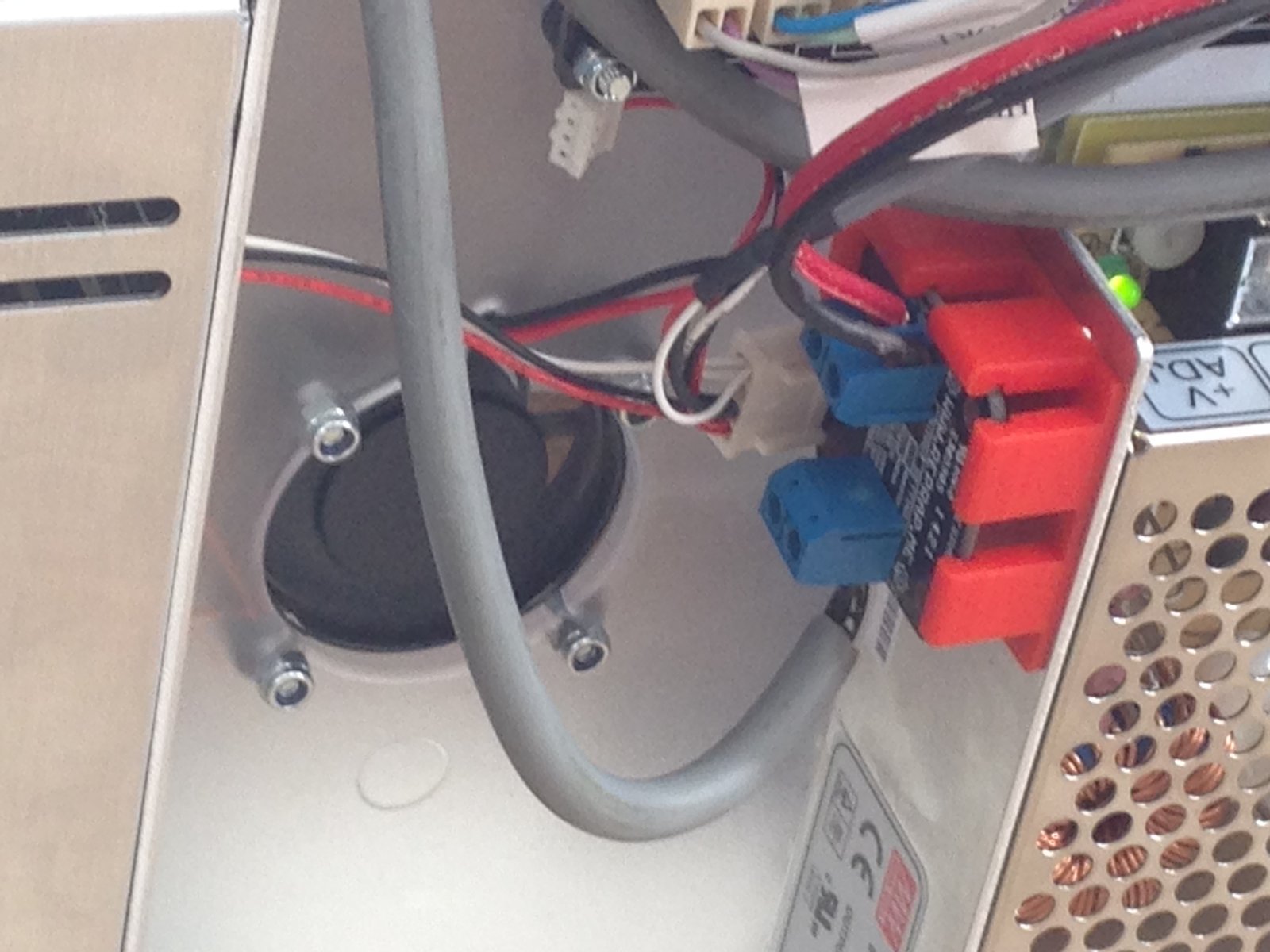

after that, you’ll need a power expander, so that the output for the heatbed on the mainboard can control the heatbed.

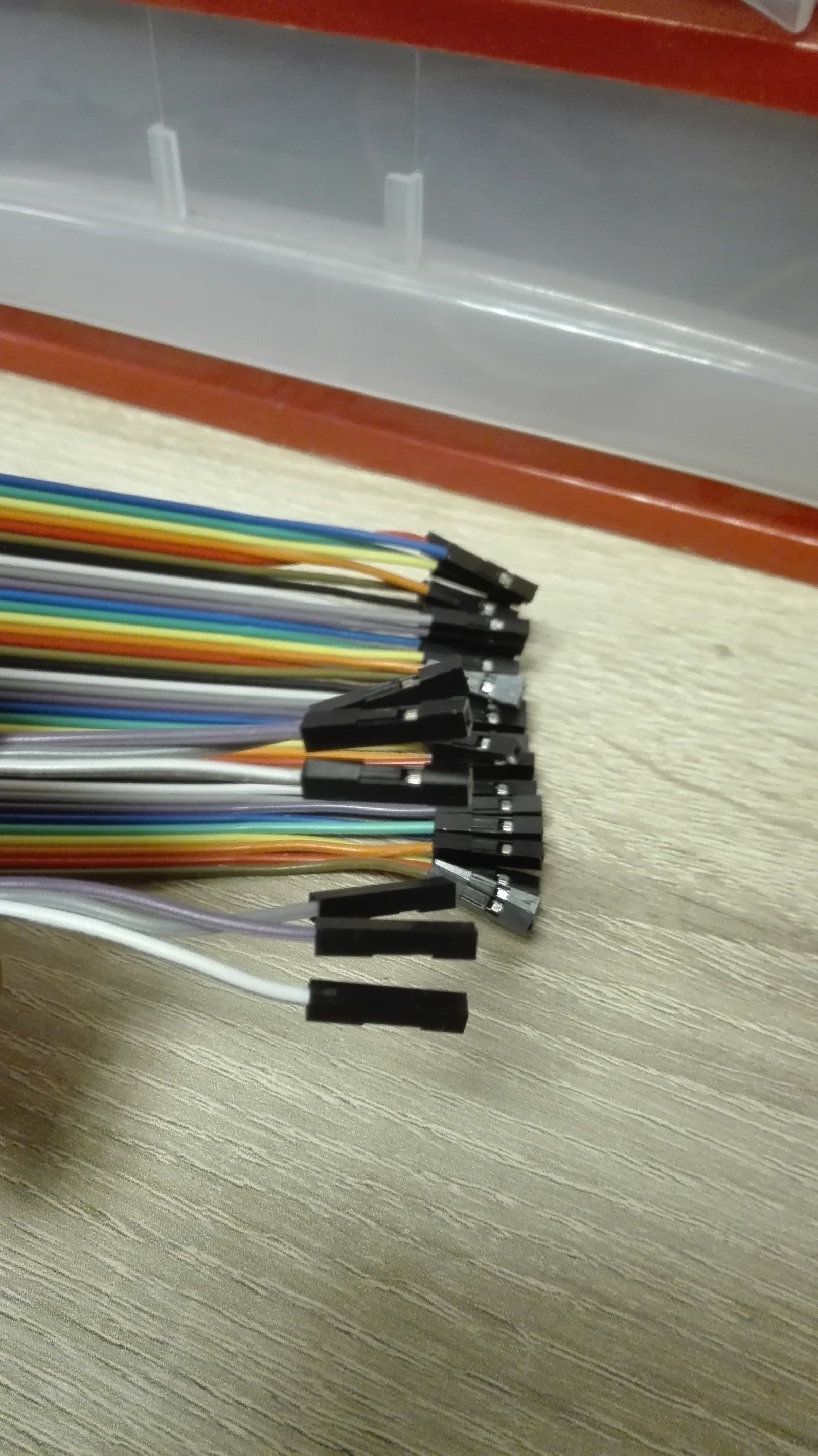

I used female-female jumper wires to connect the board with the expander (works great)

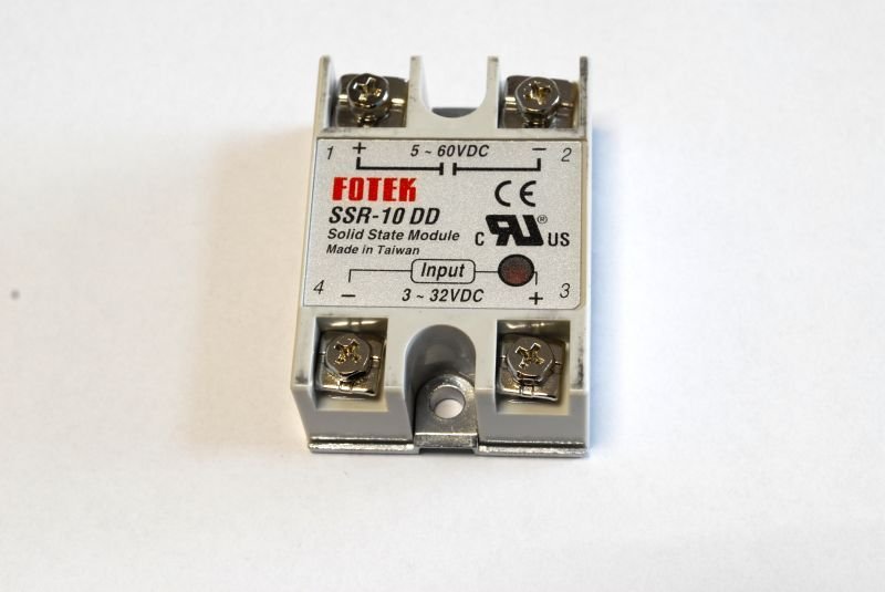

I put the Builtek s*** direct on the bed-frame and used it as electrical isolator

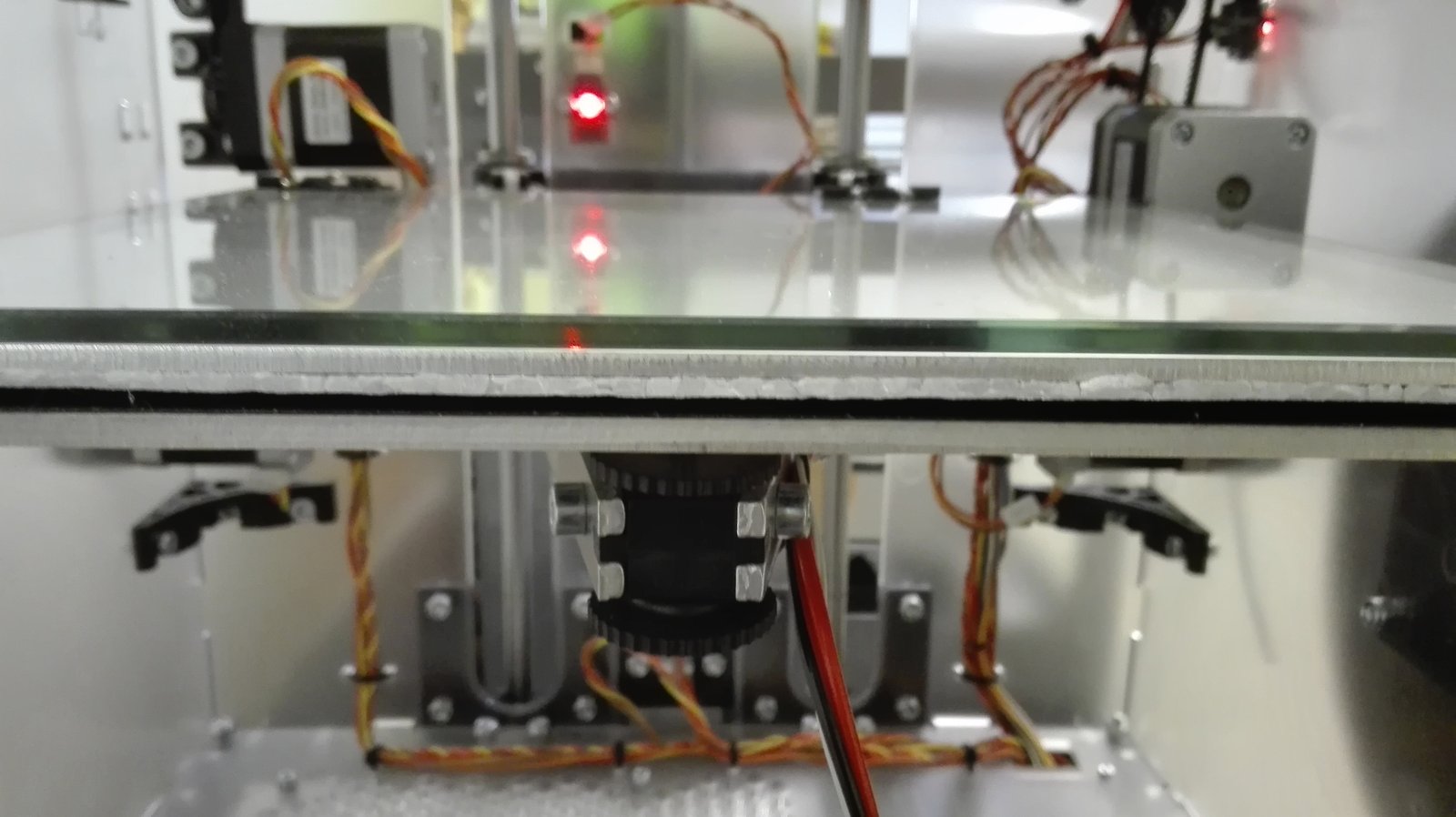

I made a sandwich of frame - thermal isolator - heatbed - glassplate and just fixed it with foldback clambs.
Keep in mind that your printbed is much bigger after this. So you might also have to modify the z-endstop to prevent a nozzle-crash. (I used superglue (cyanacrylate) and a pice of filament).
