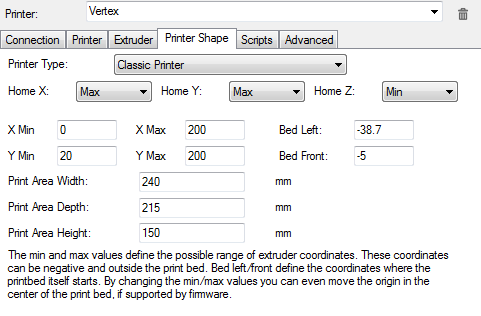

Check, if Repetier got the default K8400 printer settings for dimensions, directions, etc…
In Printer settings, look for parking position. My setting is: X:200, Y:200, Z:0
Inverse Direction is set only for Z axis.
For Printer Shape, i got these settings (see attachment)
‘Bed left’ could be different - i got printed my own dual extruder holder for using 2 e3D’s.
Hope, this helps…
