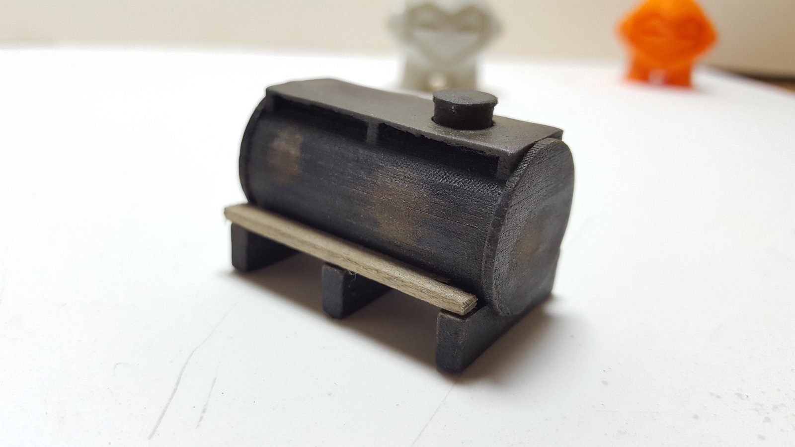

Guess who’s on 3D hubs now! Is it possible to really rust up the iron PLA? As in getting rich reds and really attack it? Would be really neat to print something fairly derelict looking (broken down factory equipment, broken gear or such) and make it rust massively.

You can get it a really deep color honestly! Here is the tank after letting it just rust on its own in the ambient air after getting the vinegar kickstart and it is a very deep color. Honestly it looks exactly like a rusty model with loads of rust. I love it because I can make old looking models for my trains very easily as I never liked the look of “plastic model made to look like rusty metal.” This is a print I did for a client that she rusted and it looks spectacular. Protopasta on Instagram: "#Repost @kaykay979 with @repostapp ・・・ Inspired by many to try rusting these #3dprinted #ironearrings. @crazywhitemachinist @proto_pasta @3dhubs #3dprinting #upcycling #persianrug #wearyourtimes"
