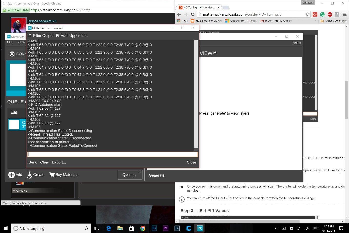

upgraded hot end to E3DV6 but Cant auto tune PID. What is going on?
Need help tuning PID settings, Upgraded to E3DV6 and updated firm ware but when ever i run M303, this occurs, also when i do test calibrations my hotend’s temperature would dip dramatically mid-print.
attached is a screen shot of my matter control’s terminal

Sorry just saw your attached picture. I have no experience with Matter Control so can’t help there, but double check your thermistor connections. If the thermistor reads out of the ordinary I would expect that it wont heat properly.

looks like your printer is disconnecting. and the temp seems to be dropping.
power issue?
