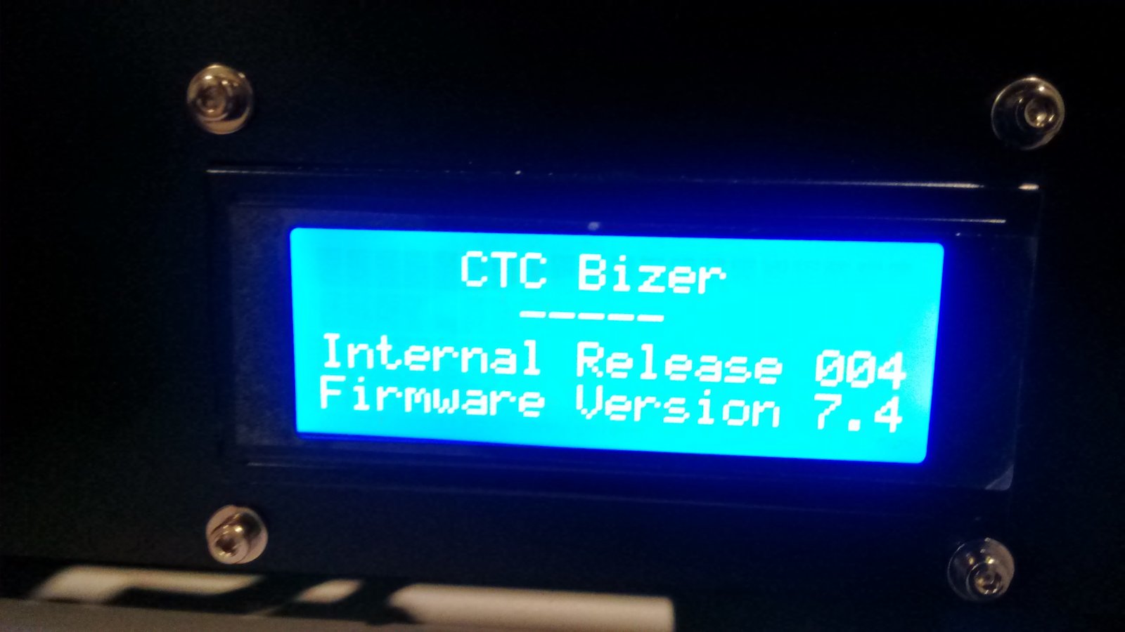

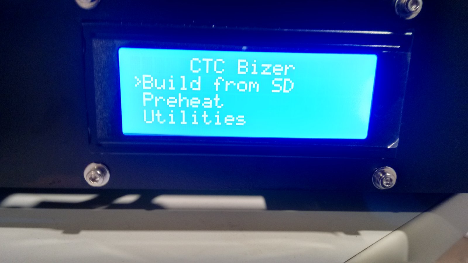

I recently bought a CTC Bizer from eBay and it’s our 4th CTC. I guess CTC has changed their default firmware from the MakerBot versions that shipped on previous units to their own custom 7.4 version (pulls up with a CTC Bizer heading on the LCD and has a few different options).
When I try to upgrade the firmware to Sailfish 7.7 I get some issues. First, MakerBot Desktop doesn’t recognize the printer to get it up to 7.5 and Replicator doesn’t act normal with it is as well.
