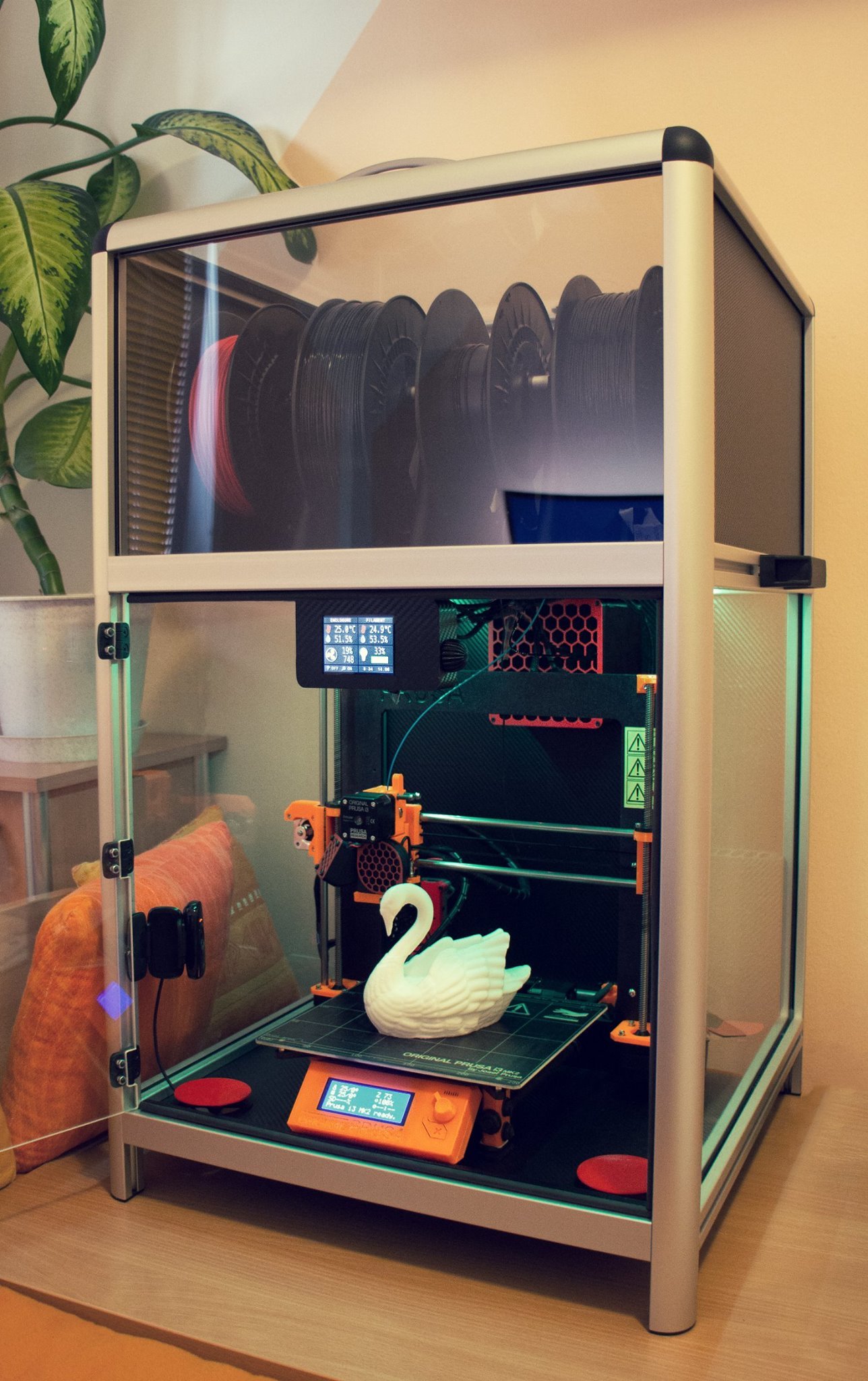

Universal Smart Enclosure for 3D printer!
Finally on Thingiverse: https://www.thingiverse.com/thing:2792618
That’s my “smart” universal enclosure. I have 2x temp + 2x humidity sensor (printer area+filament area), dehumidifier in filament area, HEPA+carbon exhaust filter, PID regulated vent (RPM vs. temp), fume sensor, 2x relay, EMI input filter, RTC, logging, RGB leds (each led controlled individually), alarm over wifi. I’m running printer on Octoprint which is not directly connected to enclosure → I can power RPI and printer via enclosure wifi relays.
This will improve printing quality and you can build it on your own!
