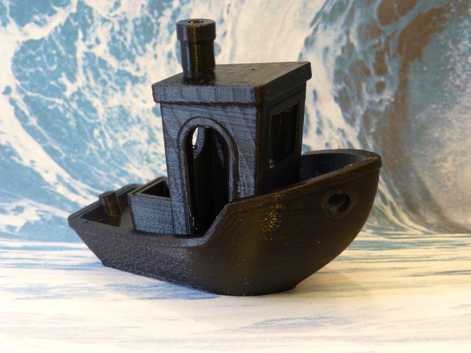

The problem is…it prints perfectly on my Wanhao Duplicator 4S but not on my Ultimaker 2!!! On the Ultimaker 2 there are zebra like lines on each side of the cabin which is a gently curving surface.
There is a thread on this topic on the Ultimaker forums but if someone here could print this thing and post the result it would be appreciated! I would note that at least one other person gets the exact same result on their Ultimaker and that I have tried everything to get rid of the artifact. A super high infill seems to do it as does rotating the object by 45 degrees. Both of these actions, however, have negative impacts on other aspects of the challenge!

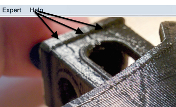

We gave it a try and can confirm that it is the inner infill structure affecting the outside of the hull. Please read this link for more information. The attached image in this post also illustrates our result.

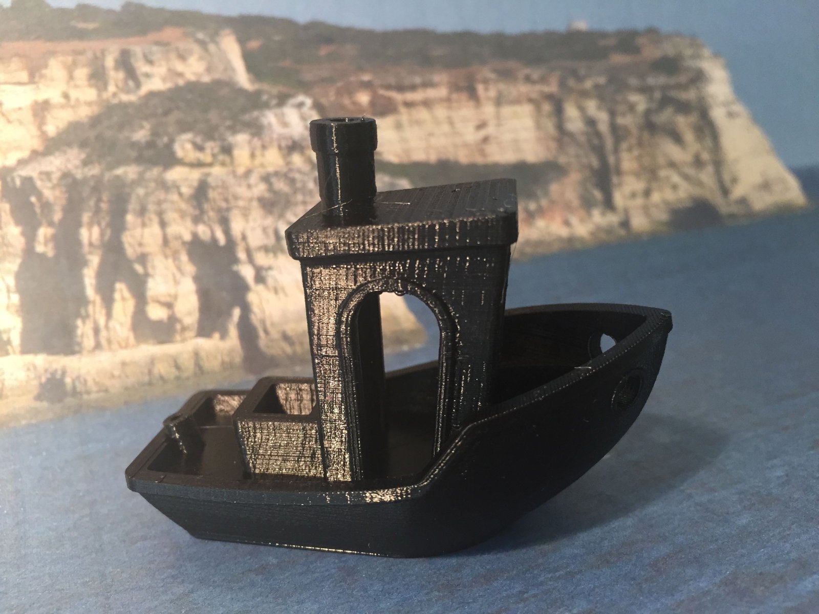

As you state in your instructions, raising the number of shells fixes that problem … that is why I raised my number of shells on test 22 from two to three! Which got rid of that artifact but not the zebra stripes on the cabin which you can see in my print and I think I can make out in yours though I am not sure…

Rotating the model by 15 degrees gets rid of the artifact. The discussion as to what the problem is, and what a better solution might be, continues on the Ultimaker forum! It appears to be something to do with the stepper drivers. This photo shows a print done at the Normal (.1mm) resolution in Cura but turned by 15 degrees on the build plate. No more zebra!
I printed my first 3DBenchy to mark 2666 print hours on my Ultimaker 2+, and got exactly the same lines as yours a few years earlier. I can tell you it’s not infill, that’s for sure.
