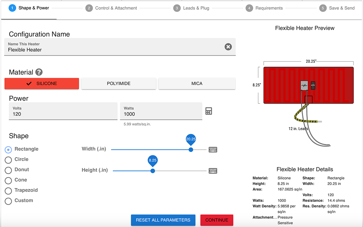

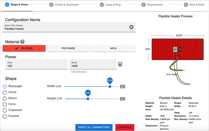

This flexible heater builder tool allows you to configure a silicone rubber heater up to 24" (609.6mm) X 18" (457.2mm) so it shouldn’t be any problem to configure a 330x330mm.
Here’s the link…
https://farnam-custom.com/custom/silicone-rubber-heaters
