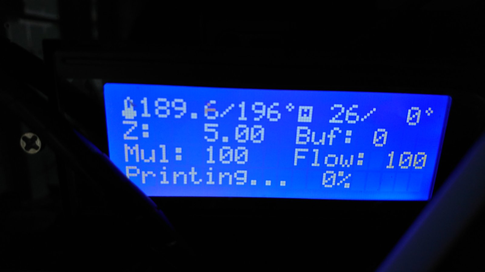

hey people, I hope you can help me. this is my very first time ensambling and trying to print with a Tronxy p208e, I followed all the instructions that came with it but when I try to print it keeps heating up and nothing happens :sob: I’ve been waiting like 1 hour and a half and still nothing, here is a picture of the LSD screen. I don’t know what to do
Your bed isn’t heating. You need to find out why. I haven’t seen your printer specifically, but I suggest looking for a fuse or a connection that isn’t correct, then also looking at a potential firmware issue. Also, check that your bed thermistor is properly installed and set up in the firmware.
