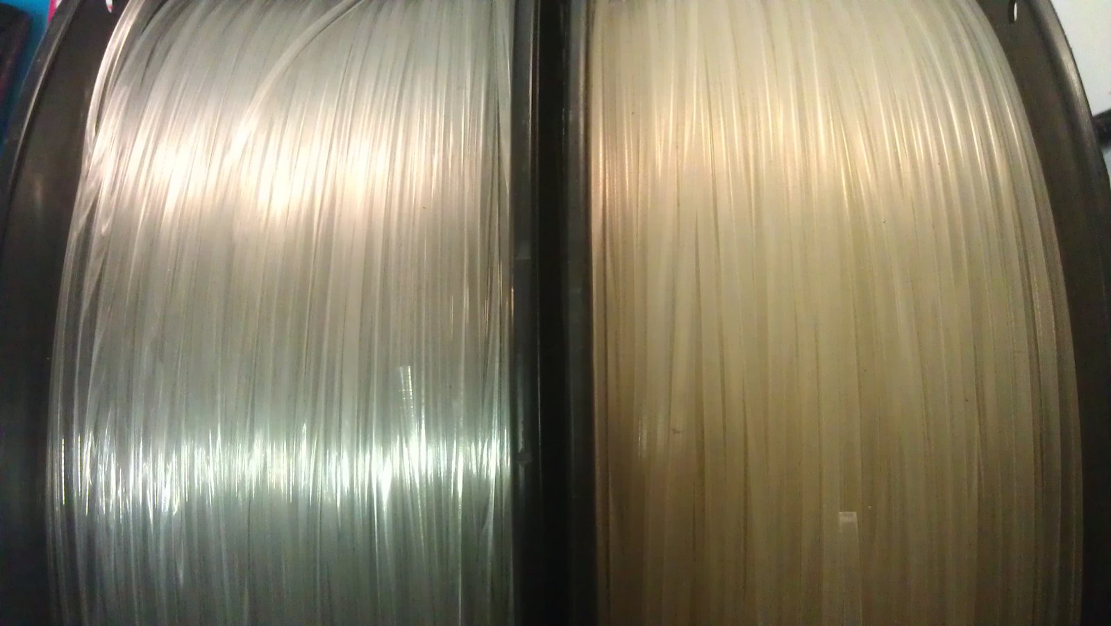

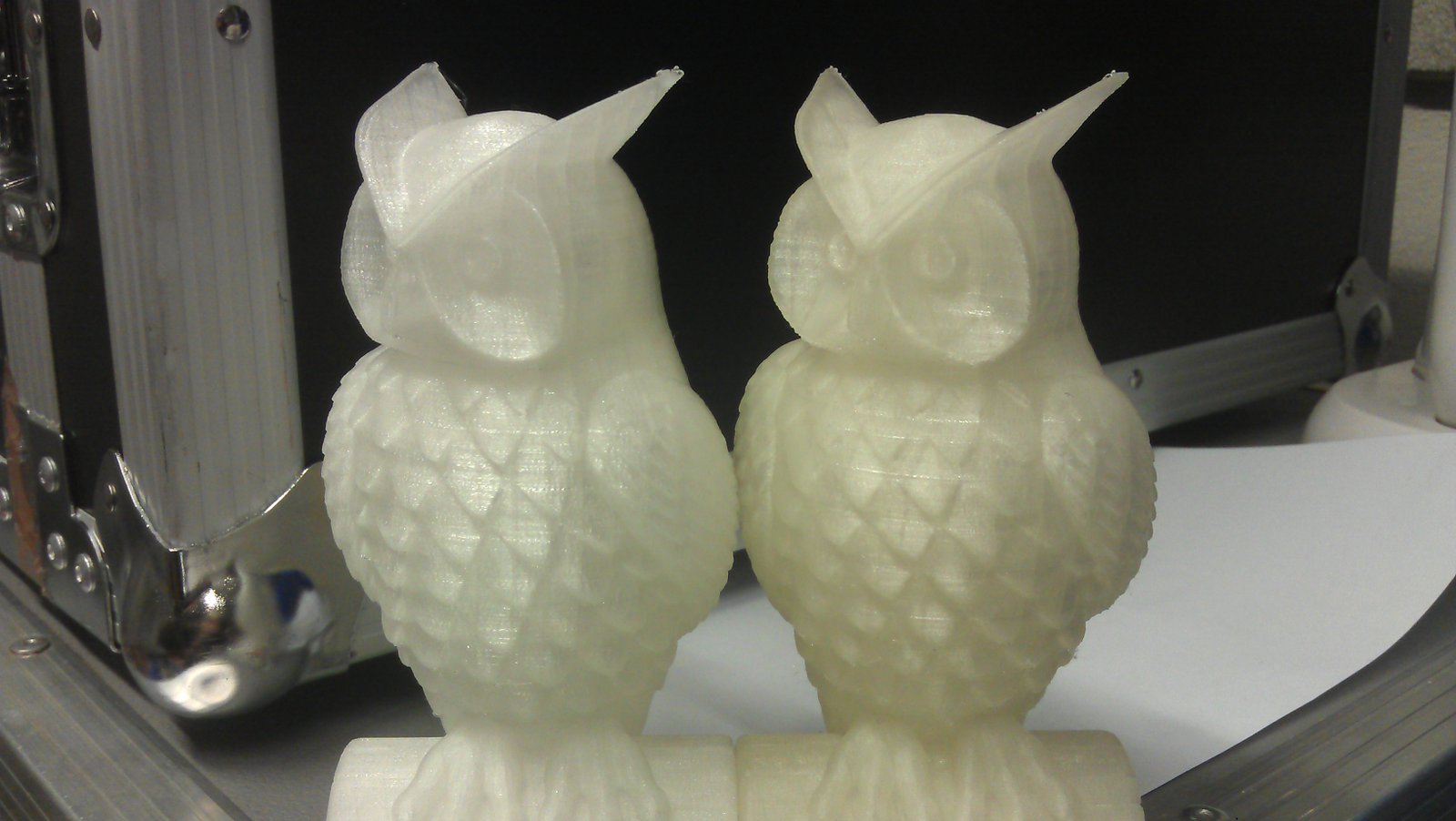

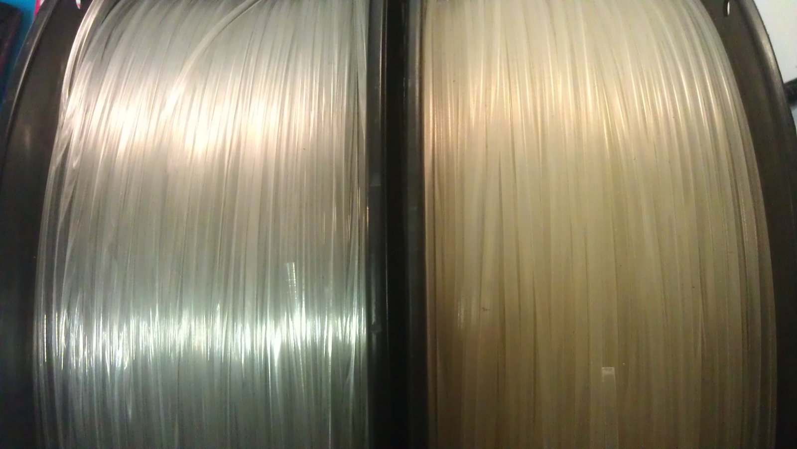

Buying transparent filament is not so easy. I bought two spools from German RepRap and got two different transparents. I still need to try the colorfabb stuff.

what material is this and sold by who?
