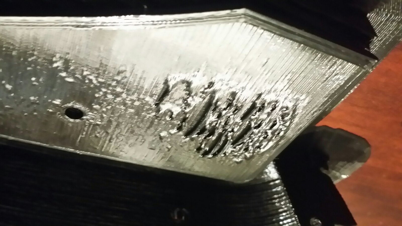

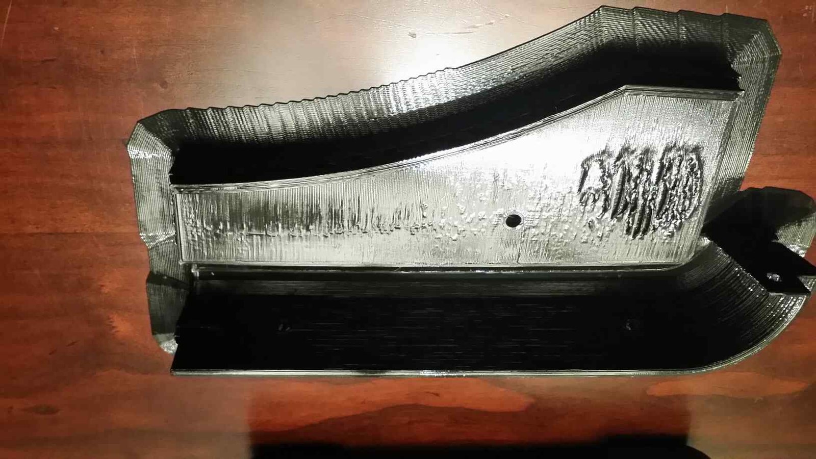

Attached are images of a part I am printing. For some reason the top layer is splitting as shown in the picture. Its PLA at 0.3 layer height on the robo 3d printer R1. It seems to be related to top layer infill on larger flat areas.
I haven’t changed any printer settings since I could print something like this and its appearing across spools so I am guessing its a mechanical issue. I am printing a 3"x3" flat plate to see if I can catch it in the act. Anyone seen this before?

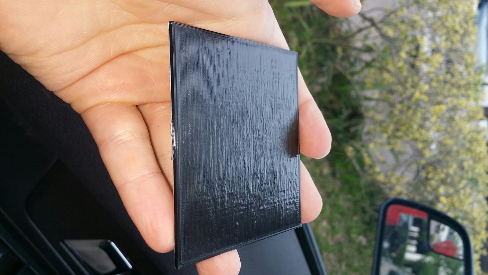

Ok time to clarify:
It looks like its a fundamental issue of my top layer not adhearing well to the one below it. I have attached two more images of the square I printed this morning. The one in the clear light of day really showcases the poor surface finish on the topmost layer. I’m suspecting the following:
(1) I am extruding too cold (180c) but if so I would expect so see errors other than my top layer
(2) A partial jam in my nozzle. If so again I would expect to see differences in layers other than the last, top one
(3) Something fan related. I am not sure what but historically my fan has strived to ruin my prints.
First off, I would recommend printing with a 10% or higher honeycomb infill. Also, make sure your top layer is printing at about half of the speed of your regular speed. Another thing that you should check is your top layer extrusion width. If it is too wide, it could be causing the top layer to warp more while cooling. The primary suspect IMO is that it looks like there is 0 infill, causing the hotend to pick up filament it already extruded and displace it.
TL;DR - Print with 10% honeycomb infill, that should fix it. If not, Raise your temps to 195 or so, The plastic gets very stringy at 180c

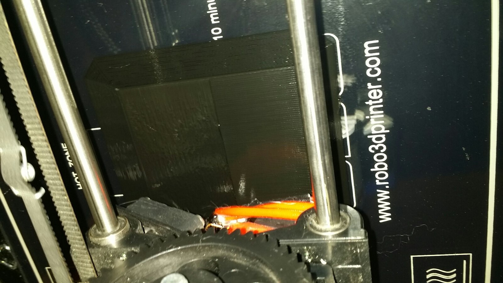

watch your printer during a few solid layers, preferably the top, and see if the nozzle is staying clean or has filament blobbing up on it. That way you can see if the nozzle is dragging around some of the plastic its already extruded.
I have some pictures showing exactly that time but they came out terribly so I’ll try with a picture with words: Lets call the top layer 0, the one below that -1, then -2 etc. It looked like layer 0 never adhered as well to -1 as -1 did to -2. 0, -1, and -2 are all using the “top layer” setting as I print with 3 layers top and bottom. layer 0 looked like it kept a uniform distance from -1 as it was laid down but immediately raised (or didnt) immediately after the nozzle left it. Whether it stayed down or didn’t seems to be related to its distance from the perimeter (see image 1), the closer to the surfaces center, which I am taking to mean the farther from the edges, the more pronounced the striations and where there is very little distance between perimeters there is no problem.
