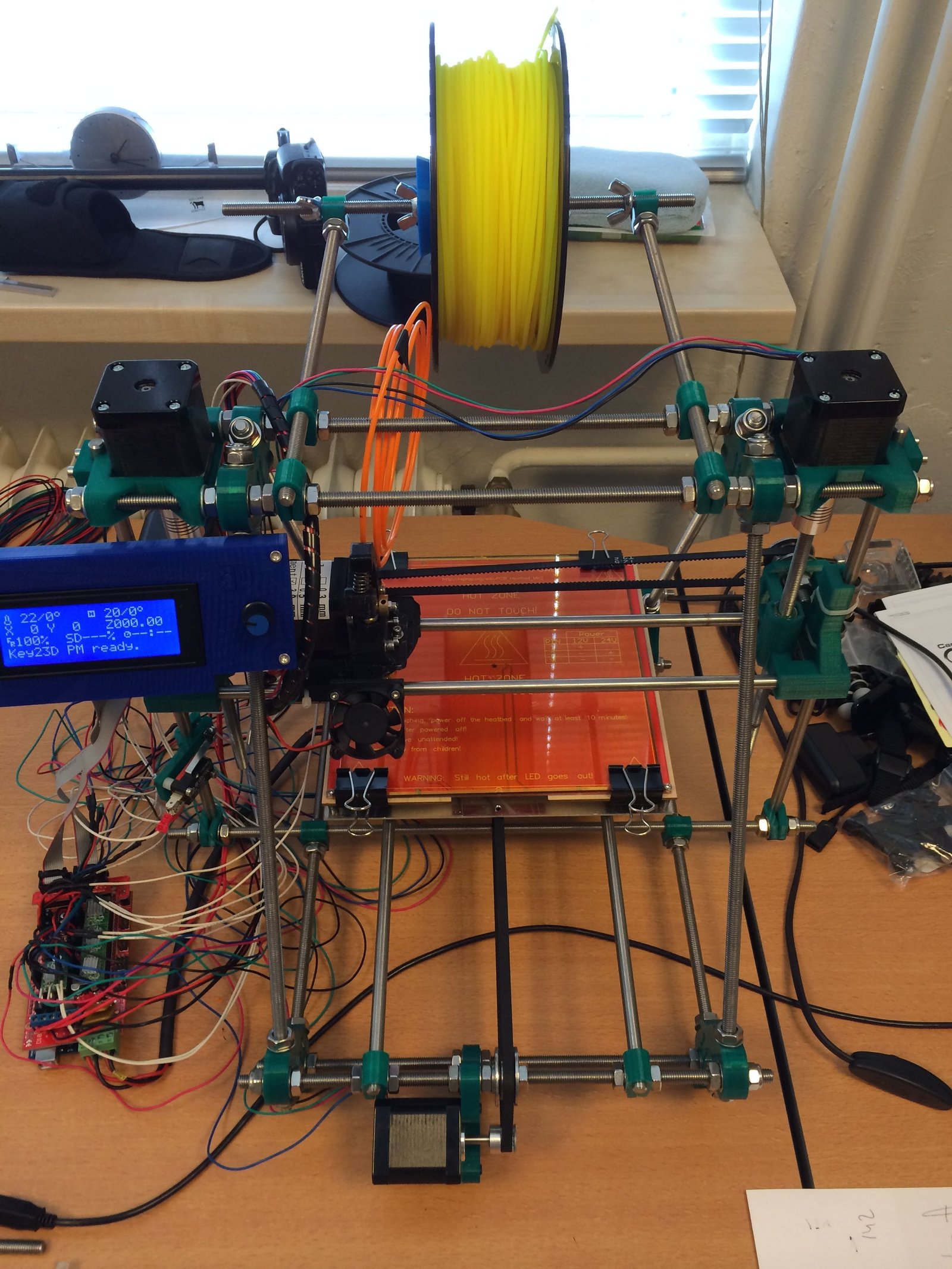

I am in the process of building a RepRap Prusa Mendel i2 that I bought from Heacent in China with two purposes:
1 Learning exactly how everything fits together and works without bothering about the print quality to much (I have well working printers already)
2 Building a school-project so students can build a 3D printer themselves with my guidance
I changed a few things though:
1 I printed the parts myself and did not use the parts that came with the printer because the quality was not to good
2 I added some parts to carry the power supply and filament and a box for the LCD and pushbutton
3 I changed the Melzi board that came with the printer to a setup with Arduino 2560 R3, Ramps 1.4, LCD and SD cardreader so it can function without a computer attached to it like the Ultimakers. I also used Marlin firmware.
4 it is not finished yet :frowning: the wiring is still a mess and the extruder doesn’t do exactly what I want, everything else functions OK now and I have been working on it for about 20 hours I guess
5 maybe I will go for a different extruder setup
I bought everything in China through DhGate and Aliexpress at a total cost of less than € 400.
(except for the cost of the printed parts)
Kind regards, Guy

Looks great Guy,
Thanks for giving me another option and some informed information on RepRap style printers, my only concern would be if someone that is not so technical would be able to build something like this. Although i am willing to learn so its more about me than the printer in essence.
