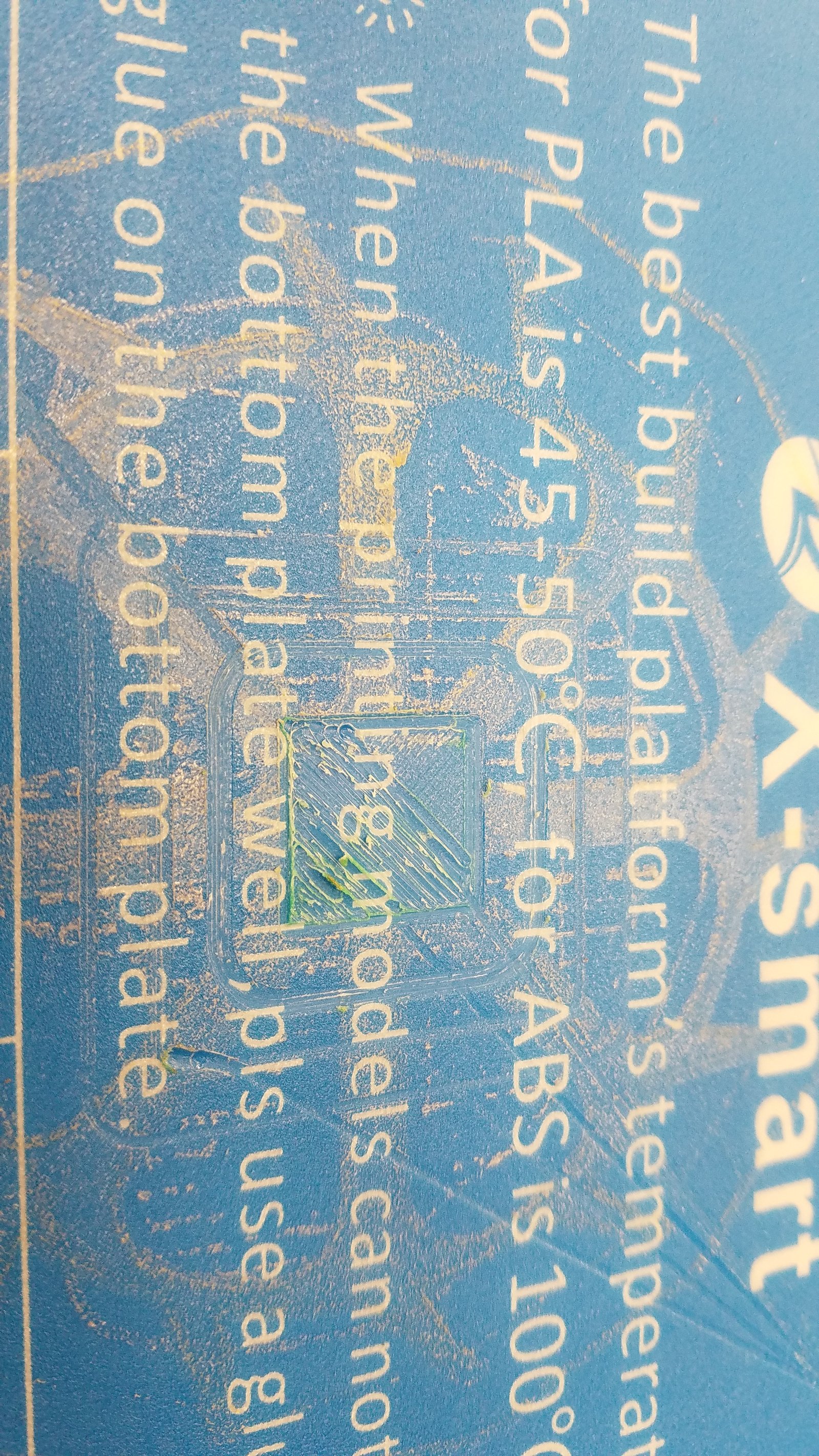

Everything loading and unloading filament seems to be working normally. I tried to lower the bed even more, to the point where the screws are pretty darn tight. Still not much extrudes from the nozzle and the block, which are both still wobbling a little on the bed. Here is a picture of what the bed looks like during a test print:
It is still too close to the bed.

The nozzle is too close to the bed. I can see it from the picture. When it was reassembled something is causing the nozzle to be much lower than normal.
When the bed is all the way down by the leveling screws you can get 2-3 credit cards in between the bed and nozzle.

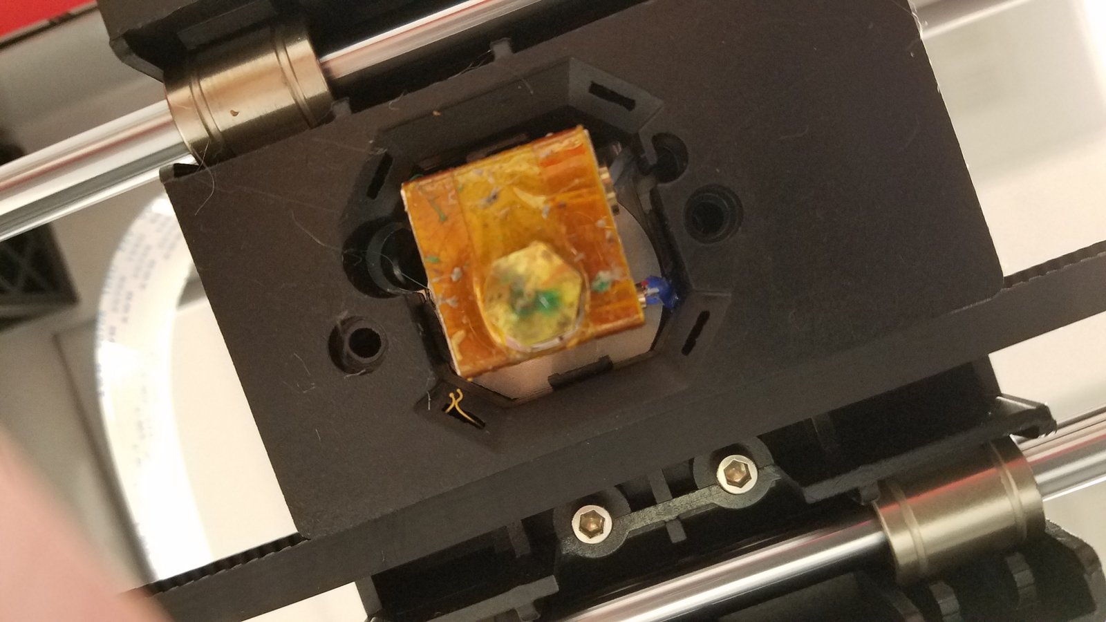

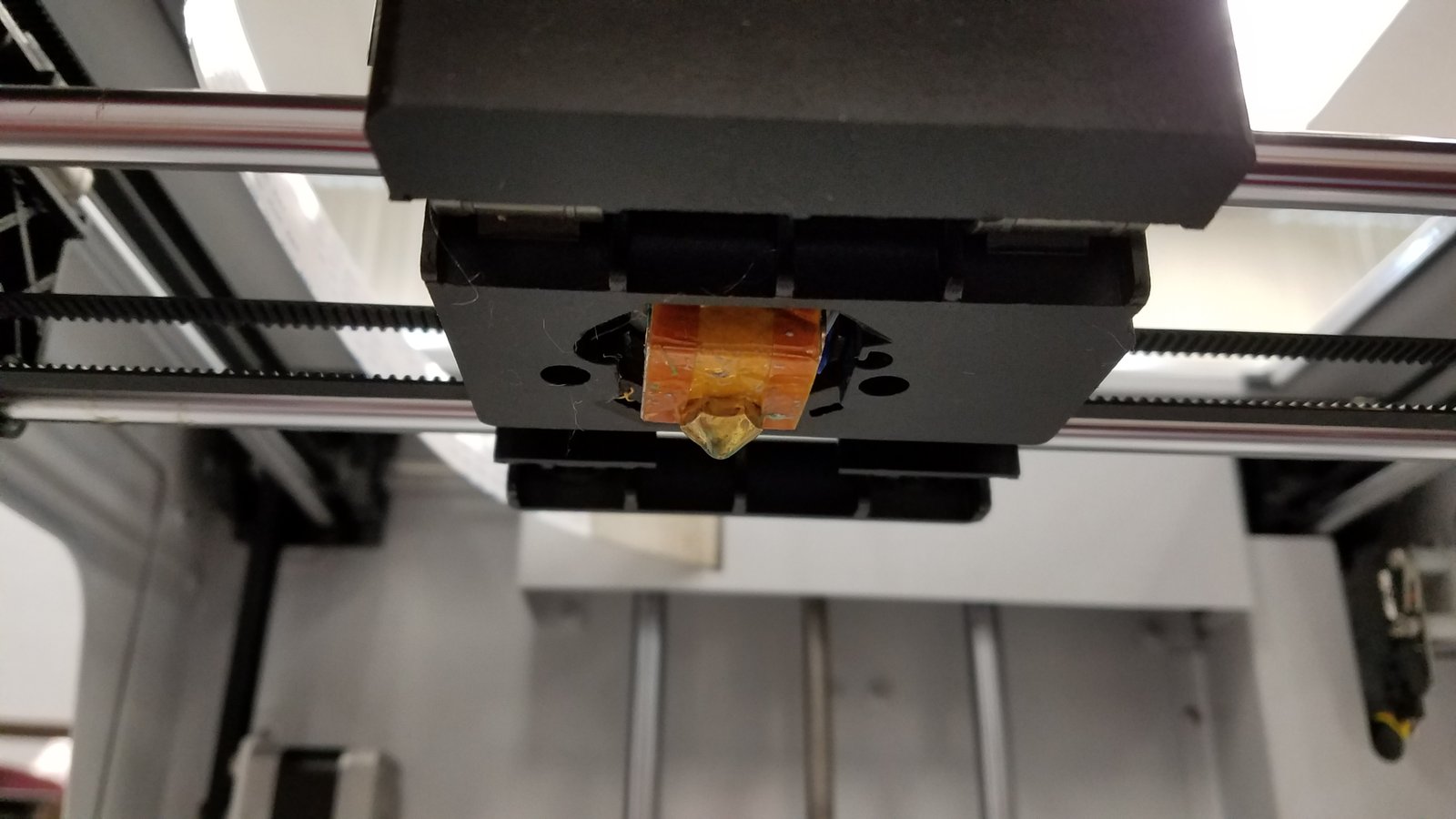

Take a picture of the nozzle and heat block so I can see the gap between the hex part of the nozzle and the bottom of the block.
Is this what you were asking for:
Hope this sheds some light on it.
Was trying to see the gap between the hex part of the nozzle and the bottom of the heat block but it is covered by the insulation so really can’t see.
