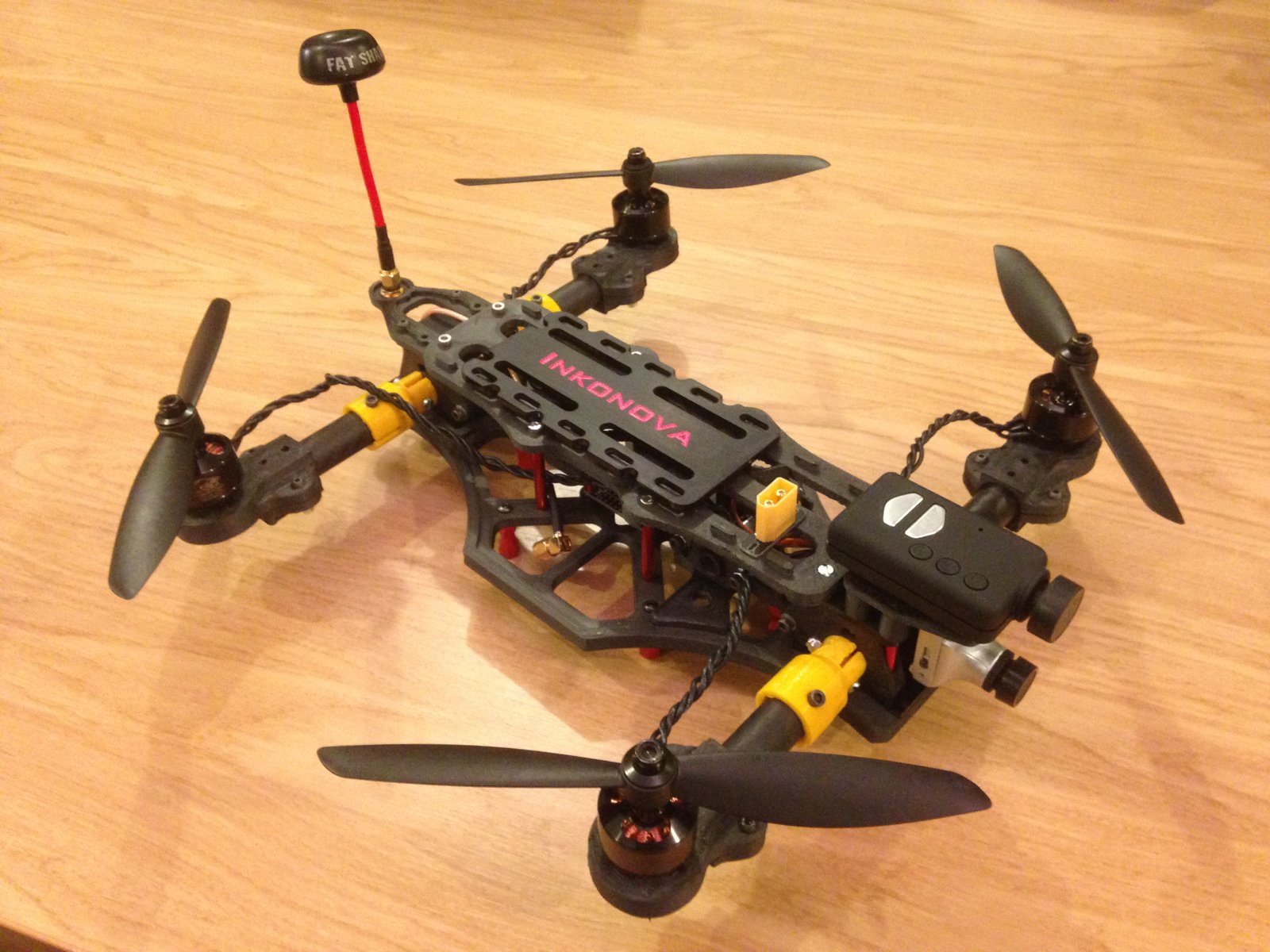

Soon after @ released their flagship (in my opinion) filament, the XT-CF20, I got a few spools to test it in our coming product to be commercialized in few days from this date: a new drone racer with dynamic titling arms and mostly 3D printed with the XT-CF20.

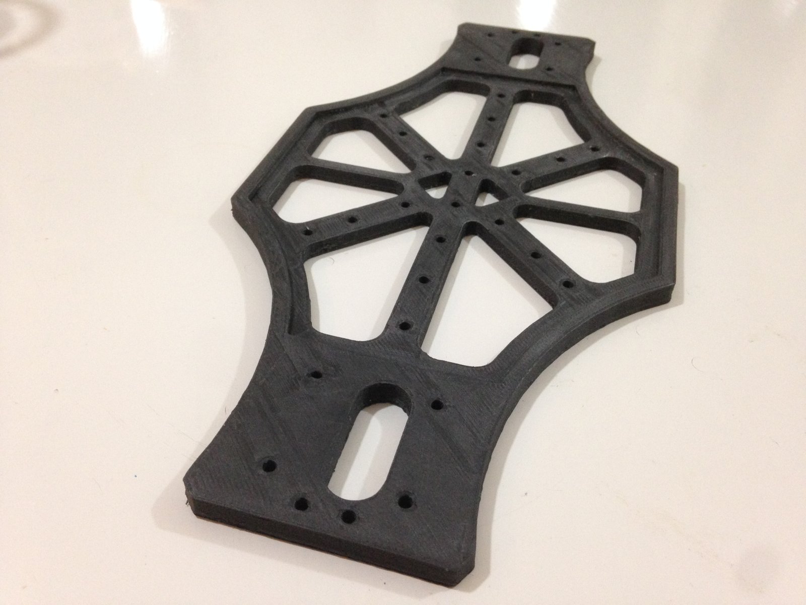

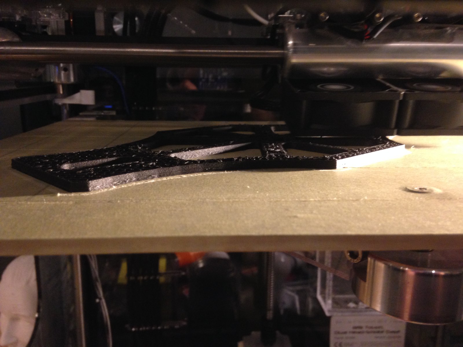

Surprisingly, the XT-CF20 has almost no warp (the part in the pictures below is the main drone plate: up to 8 mm thick part and almost 30 cm long) even at just 60 degrees bed temperature. I like it a lot, so much that I haven’t print with PLA and ABS since I got it, even for random parts, I use this filament or plain XT (which is softer than PLA and ABS but very easy to print with and good mech properties in some of my other applications).

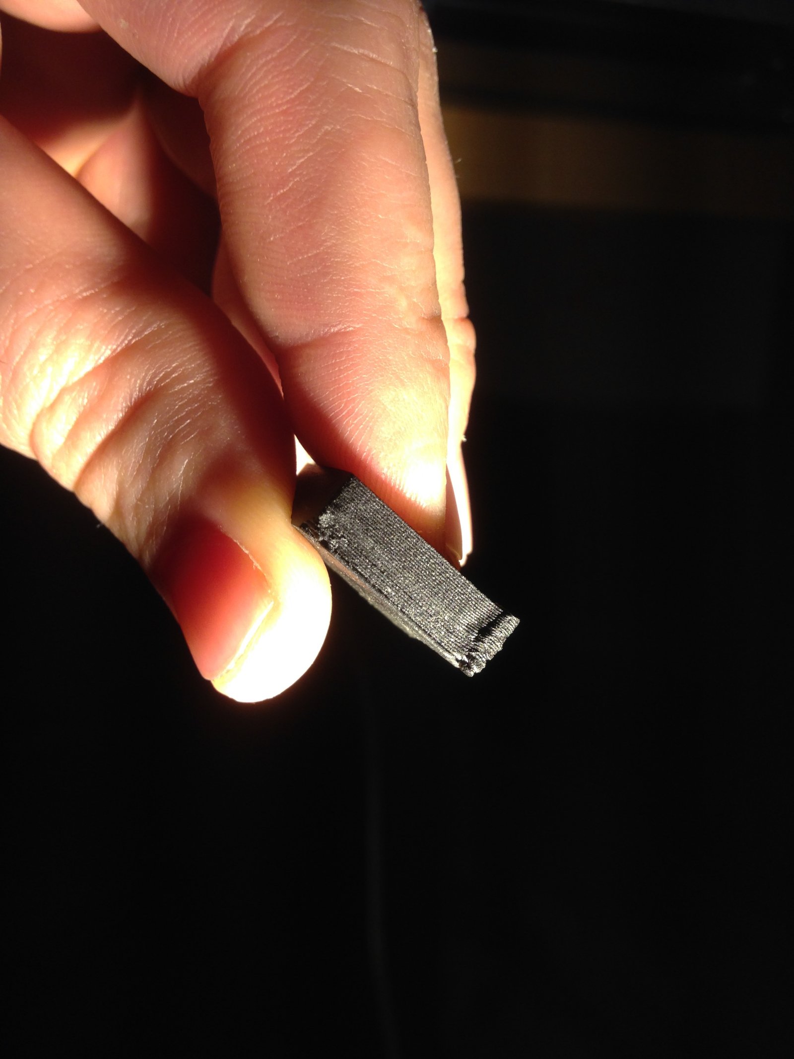

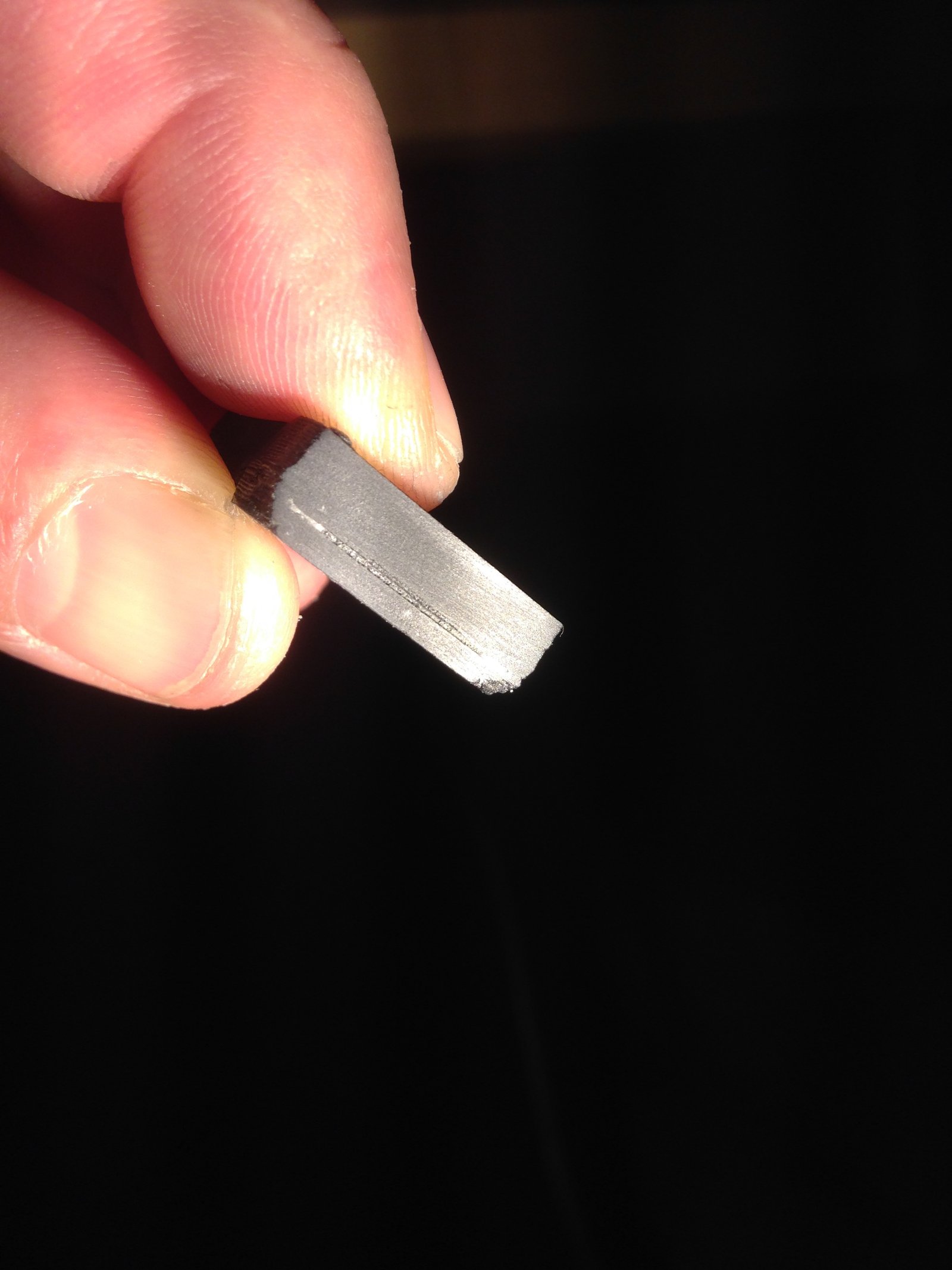

However, abrassive postprocessing (sanding) and drilling are AWESOME. With little that you sand the part, the results is supper smooth and layers disappears. Is super nice to work with it (see pictures of my first test cube before calibrating the machine). Warping is also inexistent as you can see in that big drone plate.

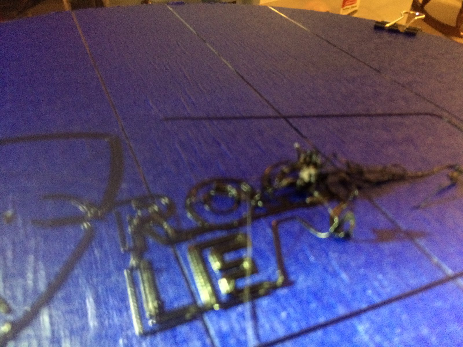

Im having trouble printing with colorfabbs carbon fiber. Its just sitting in my room now. I bought the stainless steel nozzle. .07mm and When it prints, it will print the first 2 or 3 layers and just stop extruding. If I push the filament, it will continue printing but it just has trouble extruding. Any idea?
I am using makerbot rep 2x also. I followed all your settings.

Hi @TangibleCR -
First, a stainless steel nozzle is not the ideal choice for this material. Your Rep2x already requires near max temps for printing PET-like materials such as XT and the SS does not transfer heat well (or increase wear resistance that much). Instead, can I suggest instead our hard plated nozzles with better wear characteristics than and thermal performance close to the stock brass: Micro Swiss Plated Brass Nozzle | 3D Printer Nozzles – ProtoPlant, makers of Proto-pasta
At $14.99, it’s the best, low-cost upgrade you can make to your printer. 0.4mm is the stock Makerbot orfice size, but increasing to 0.6mm can also further improve the reliability of your flow and printing success : Micro Swiss Plated Brass Nozzle | 3D Printer Nozzles – ProtoPlant, makers of Proto-pasta
I don’t think you’ll have great luck with Makerware and a non-standard nozzle size, so I also suggest upgrading to Simplify3D. Powerful software for only $150!
