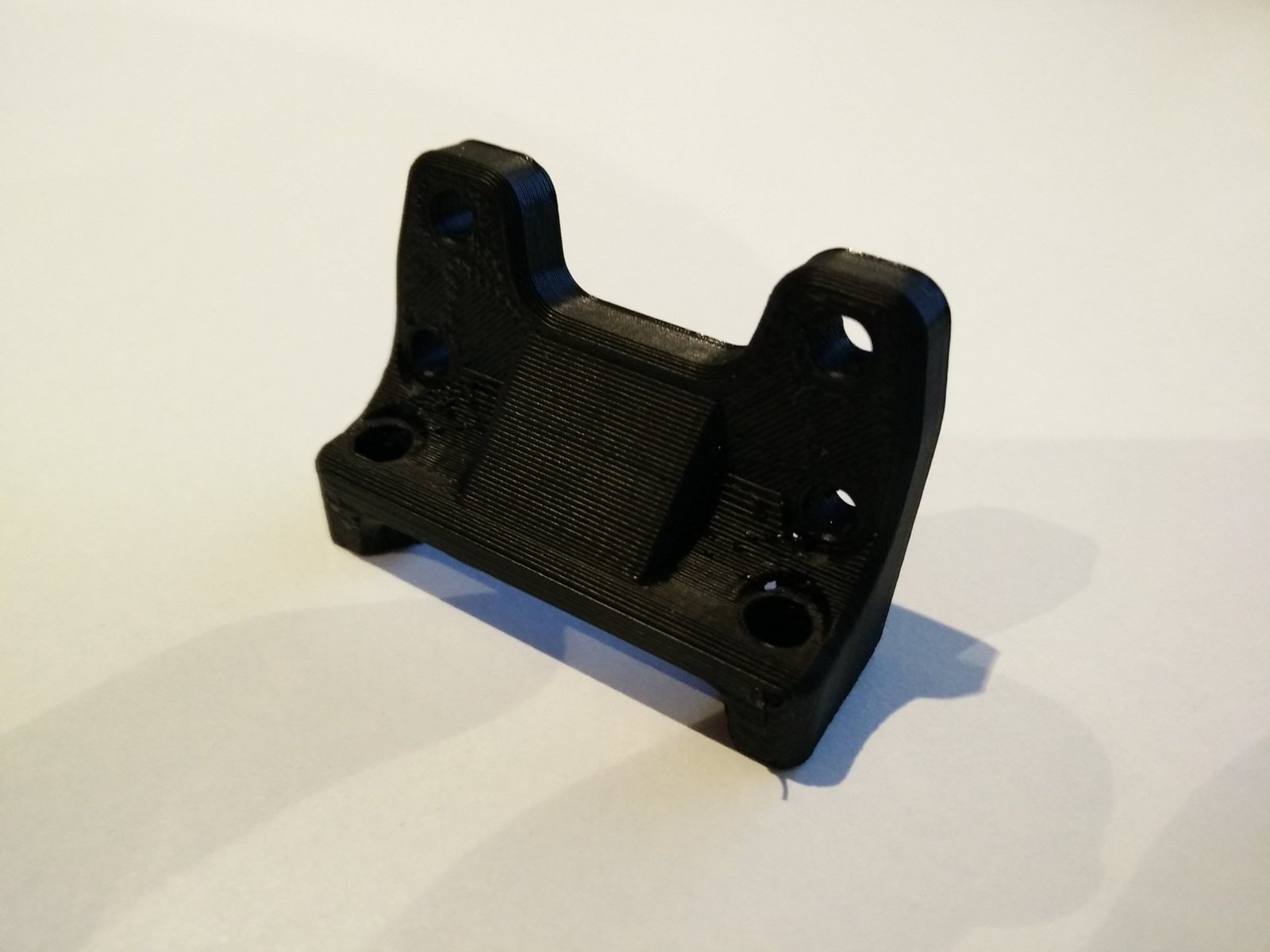

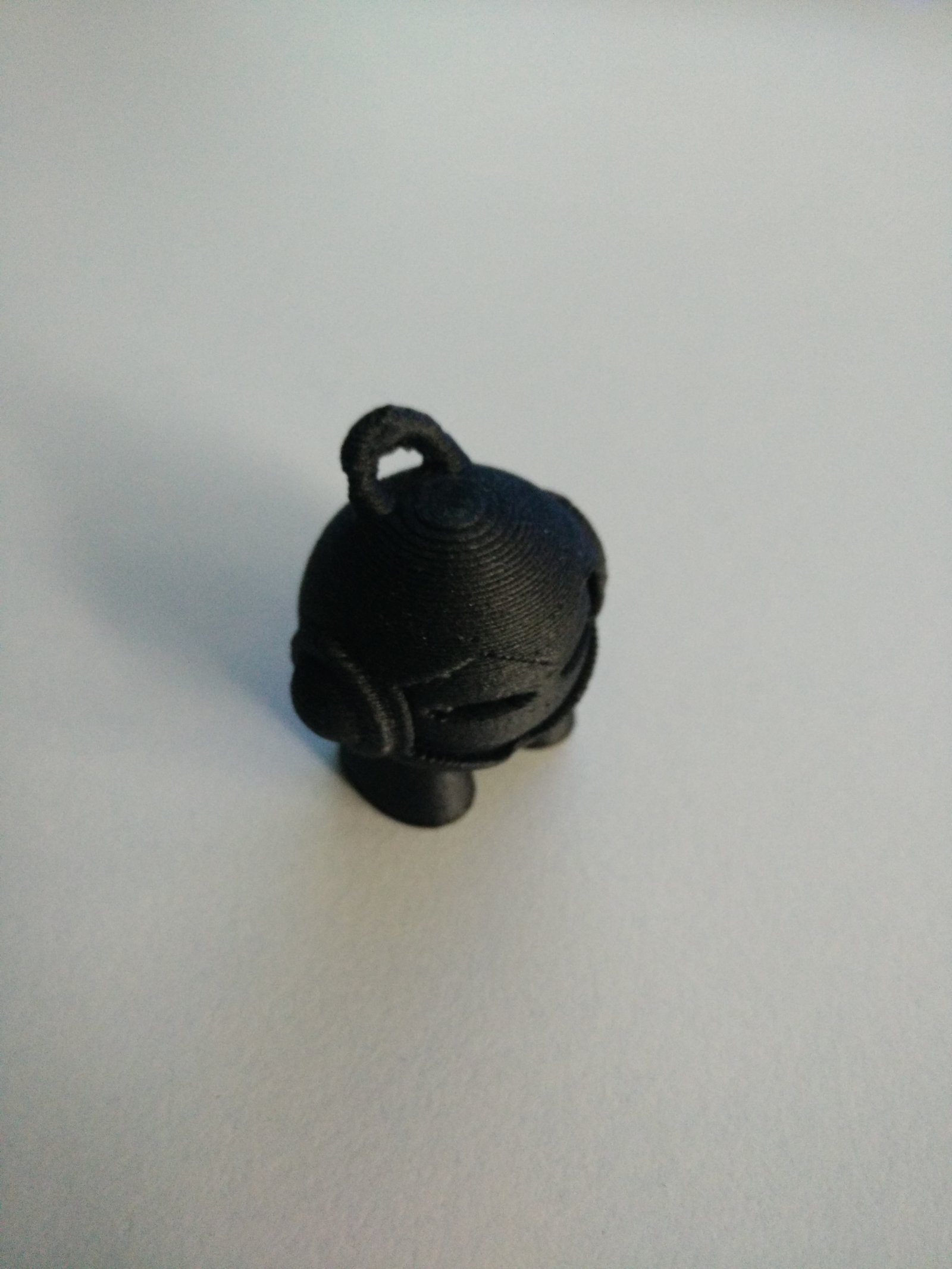

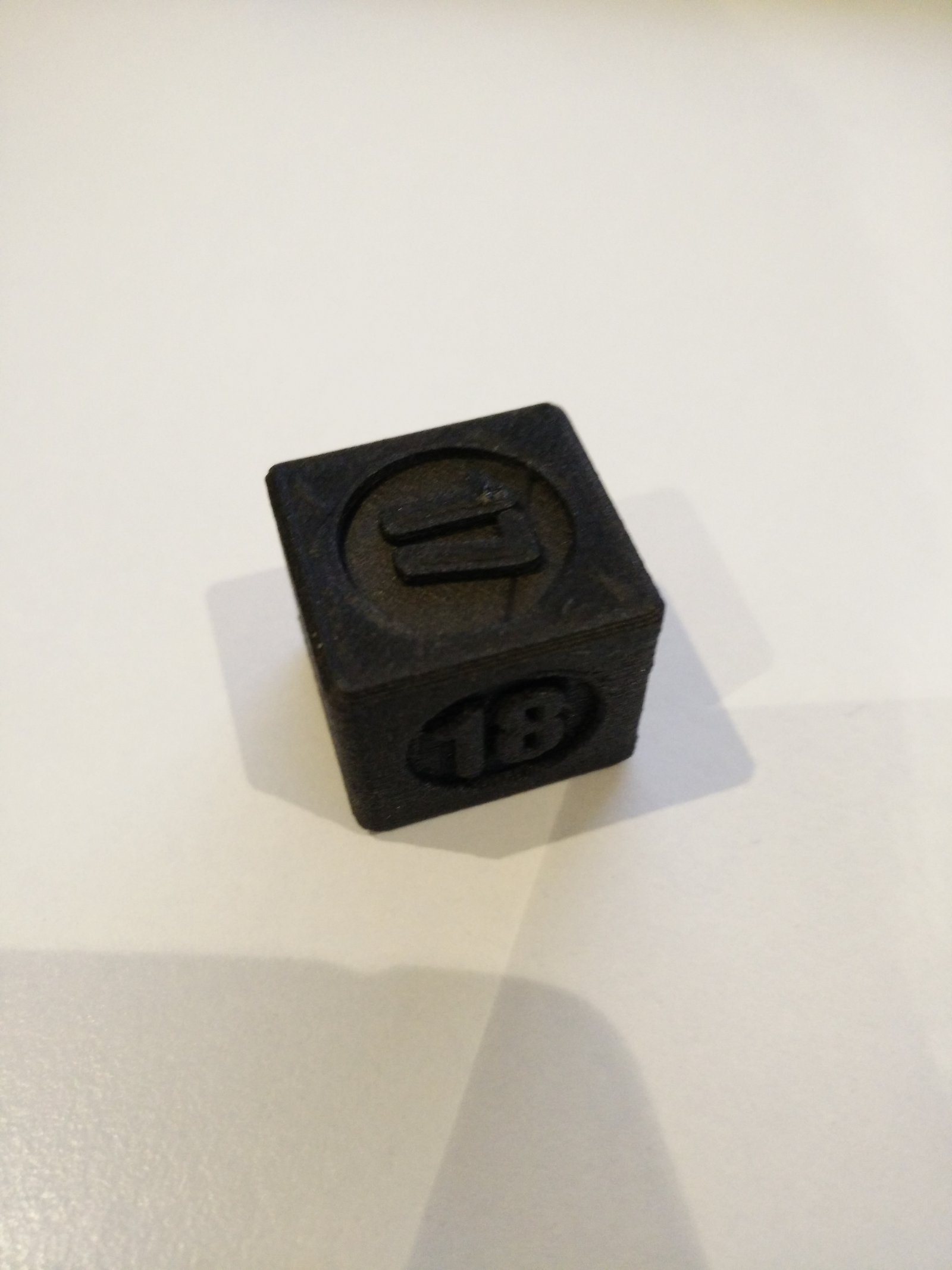

It has allot of printed parts, that also was my intention! Printing speeds for PLA are 60mm/s wich is pretty fast. It has an heated bed. I printed PLA and Colorfabb XT-CF20 on this printer, both with outstanding results. Price for this printer to build was about 280€ wich is fairly cheap I think. I added some print examples in the attachments :wink:
