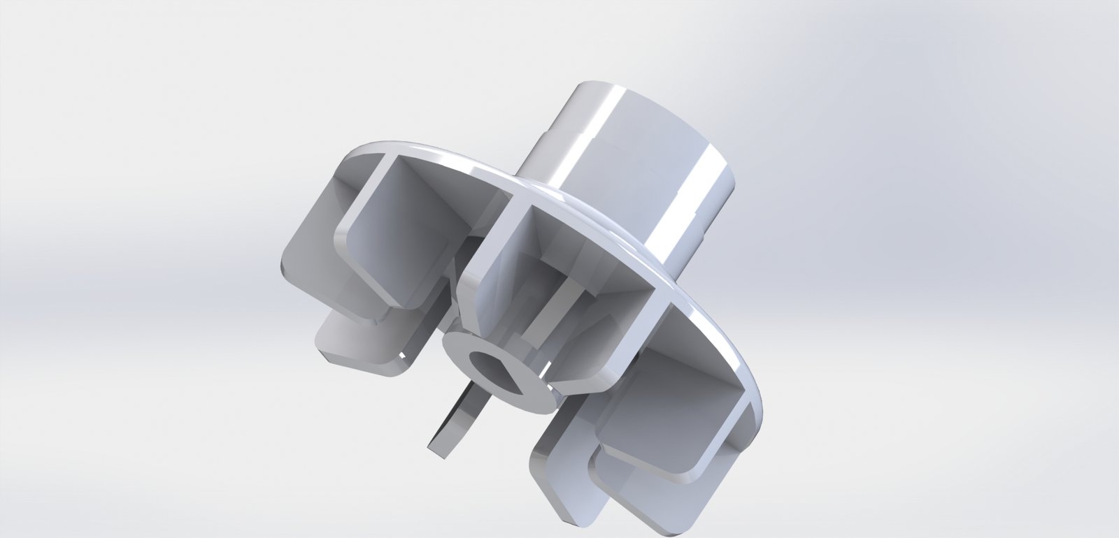

I’m printing a wand blender coupler for a coleague of mine.
The CAD model image is included at the end of the post. The total height of the model is 23 mm and the widest diameter (at the outside of the fins) is 35 mm.
I’ve succesfully printed one piece but broke 7 out of 9 fins while removing supports. The fins are 8,5 mm long, 1,5 mm wide and 8 mm high. 5 of them broke when I took off the horizontal support at the base of the fins. The vertical walls of the support deformed and took the fins with them.

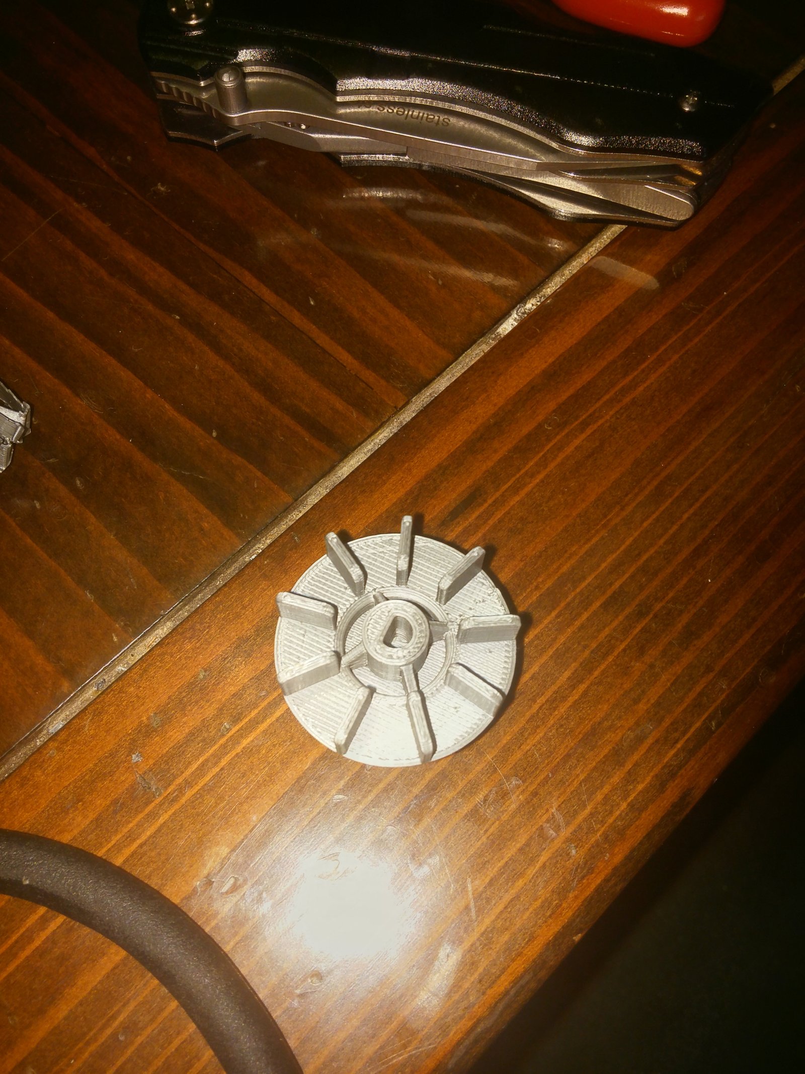

I did the print upside down and it worked. I’ve gone for 0,5 mm X/Y support distance and 0,15 mm on Z distance. The roof was a bit harder to remove, but I’ll write that off the this being a small print so I didn’t have a big surface to grab.
The finish is a bit coarse, but I’ll get a hang of the settings with time, this is only my 4th ever print.
You might notice the small edge on the upper part of the model, that’s only 0,175 mm difference in radius and it printed perfectly, I was really surprised to see that to be honest.
Oh, and I started removing the print when the bed temp dropepd to almost 45 °C, it popped right off, so thanks for the tip.
I’ve managed to print the part upside down, that did the trick. I mean, the first try was also a success but the fins were just too weak so they broke when I removed the supports.
If you want, I can still send you the .STL file, just to see the difference in quality, if you’d want to print it. It takes 1h to print with settings I used in Cura (this was my 1st Cura sliced print, I wanted to try that also) and we can then compare results. Also, I’ve printed it out of PLA that comes with MK2S, I’ve only got the printer a week ago so I still don’t have anything else to print from.
blender_coupler.stl (392 KB)
Here is my print. The side with the fins feels really smooth. Every surface feels spot on, vertical walls and the horizontal floor.
The other side, where the support was, as I’ve said feels a bit coarse, you can feel the gaps between the lines, especially with your fingernails.
And the really rough edge on top of that side is the result of supports being too close and me not having proper tools. I don’t know why, but even though I’ve used X/Y distance and minimal distance to be 0,5 mm, it got really close to the print here. But there is also an option that was selected “Z overrides X/Y” or something like that, so maybe that got to do something with it.
Oh, and this was printed with 0,15 layers - 0,2 mm first layer. First layer temp. 215 °C, other layers 205 °C, bed temp. 60 °C
