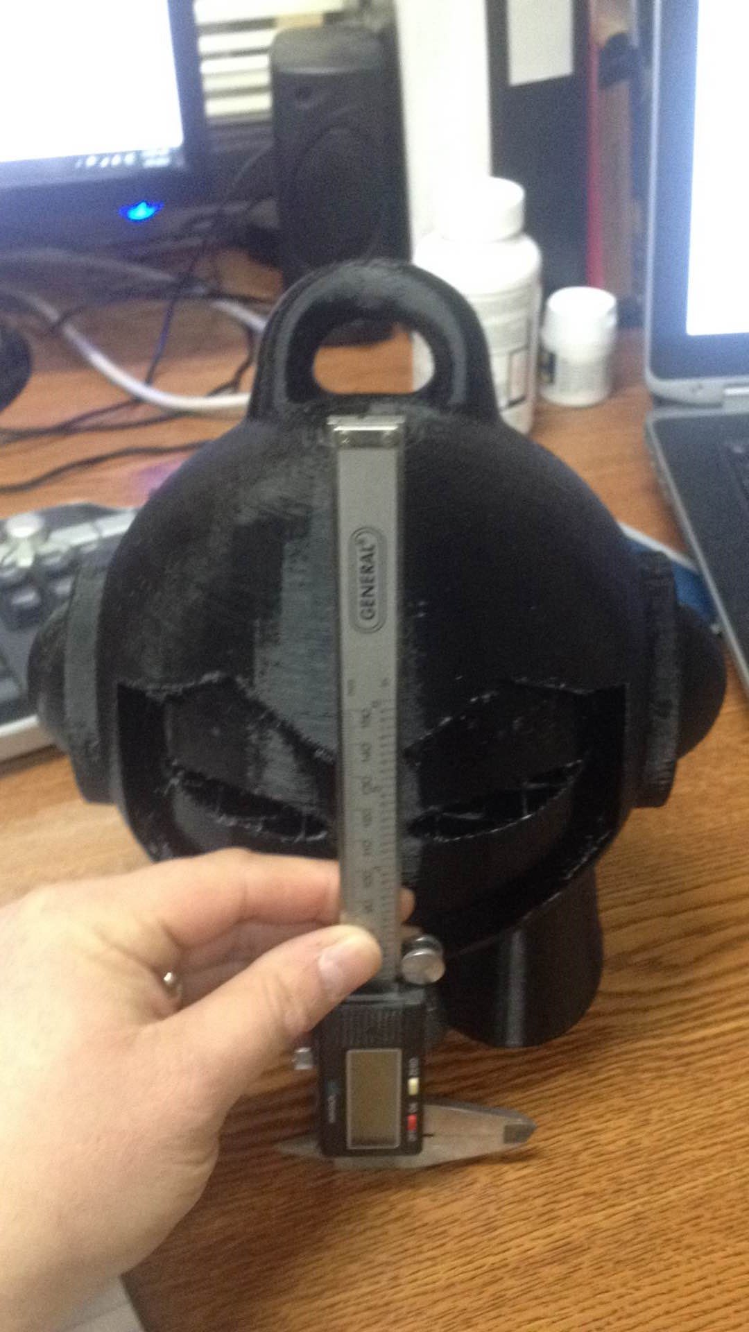

May not be the biggest one printed, but it was as big as I could go on the Rostock Max. Using E3Dv6 printhead.
Awesome job, Mike! How big is it exactly and how long did it take to print?
216mm, I have printed taller items but not one with this much volume
and 13.5 hours

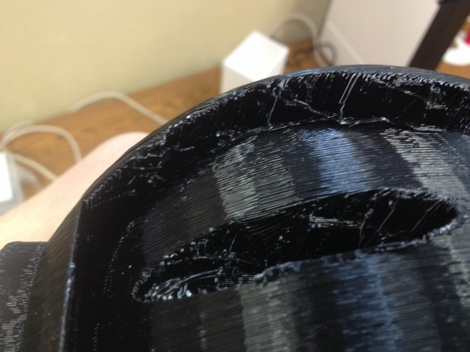

Can you add a picture of the helmet section (overhang above the eyes) ? I’d like to know how the printer managed such a big overhang angle.
-Marius
Marius,
I used supports – but they were too tight and thick so I need to do some more clean up.
Here you go.
