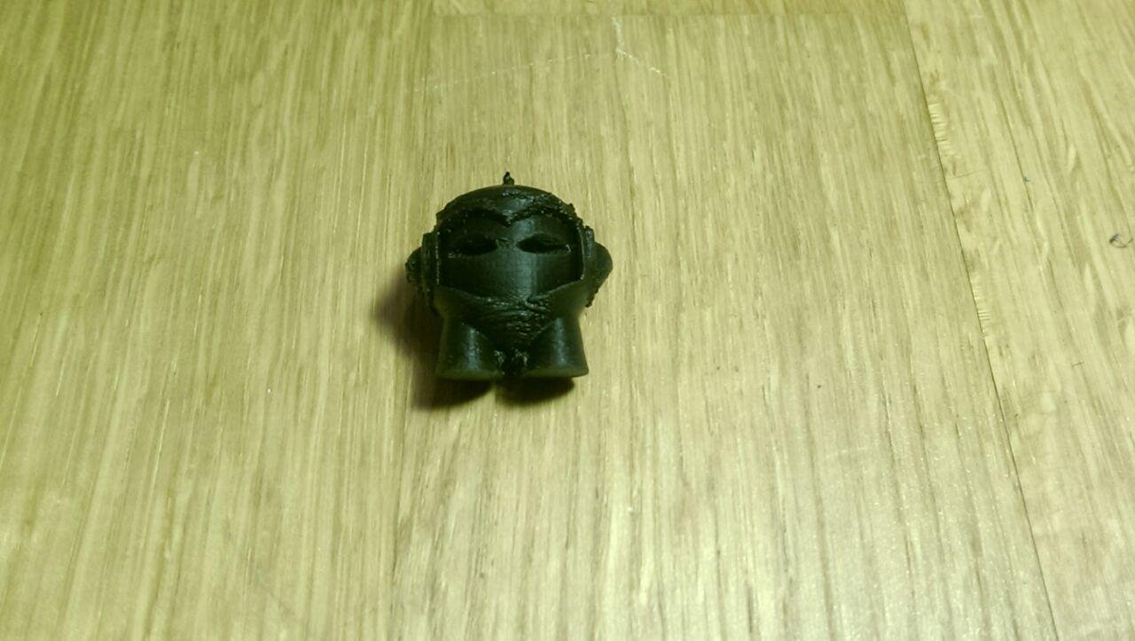

Lately I experimented with soft-PLA from Orbi-Tech and would like to share my (very useful) results with you:
The first prints were really bad. I couldn’t even load the filament. Because it is so soft, the Printer (in my case a Witbox) wouldn’t take it into the hotend. So my hotend was blocked several times.
So I decided to put the soft-PLA in the fridge for a night. The next day it worked marvellous.

You’re welcome! I made a key fob with the letters brap.ch. It’s really cool because it flexes a bit. Then I tried to make a Soft-PLA Marvin. Some parts are really nice but others failed. I think I’ll have to try it again. Maybe my printbed wasn’t levelled that exactly. Have you already tried soft-PLA?
