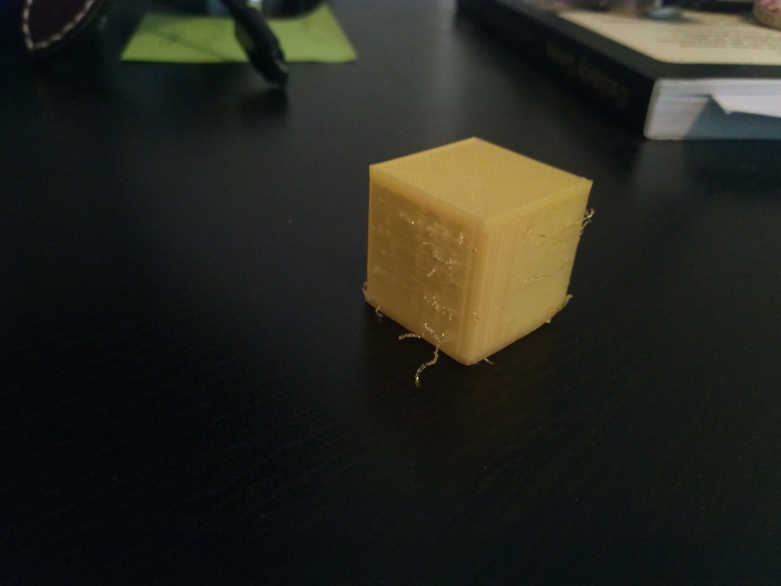

So I’ve decided to try printing PETG on my Wanhao duplicator i3 since i want to print higher temperature materials but not have the thermal challenges of ABS. I am able to print some decent looking parts but not without them having these strings around the print (see photo of 20mm cube). The strings only appear to be on the edges and the base and top of the print seem to be fine. I’m using these cura settings below and the PETG I’m using is Inland PETG, any recommendations on how to mitigate this issue?
print speed: 45mm/s
temp: 235C
bed temp:90C
retraction speed: 40mm/s
retraction distance: 8mm
Outer shell and top/bottom speed at 20mm/s

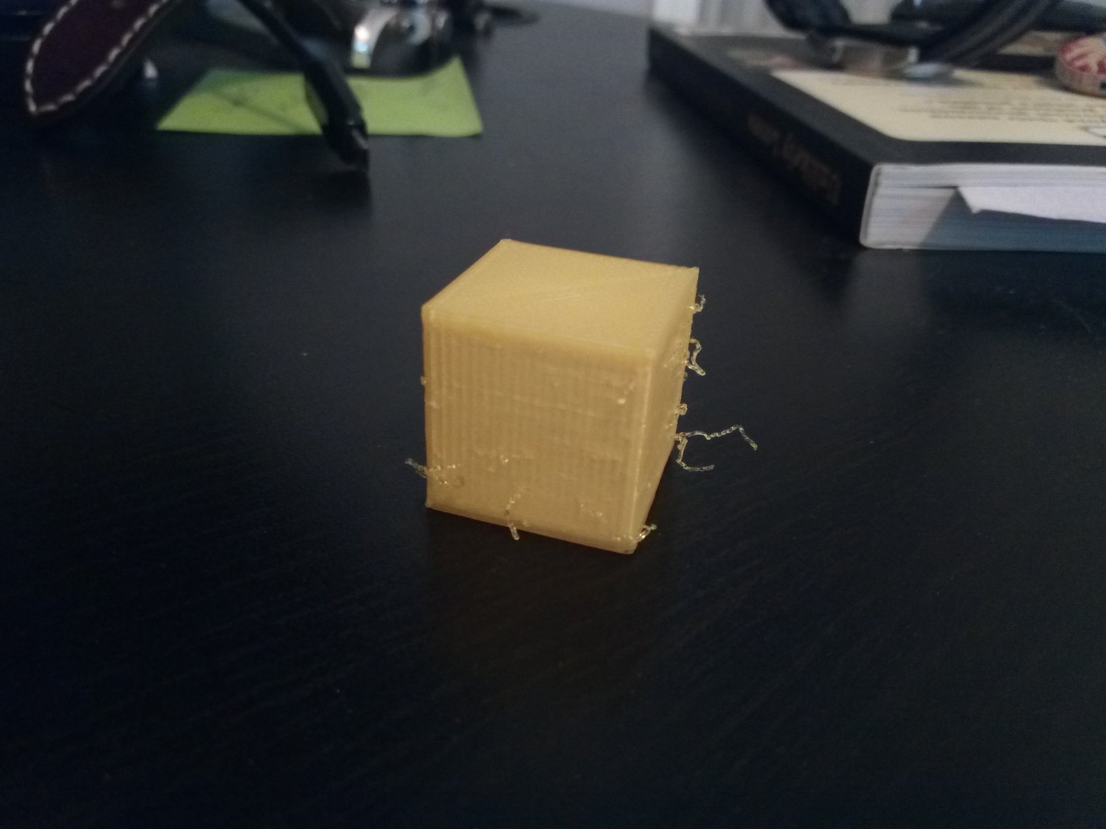

Adding second photo to show another view of the print.

Maybe this does not apply to your situation, but In CURA I’ve been running everything using Perimeters before infill.
I see from time to time depending on print and material, that I get Zits sometimes on the outside of some of my prints.
I think what is happening and have yet to really confirm it, is that at certain times, when infill stops to move over, I think that
the extruder is turning off the filament feed, but it takes a short time to stop and change direction.
If, in your case infill is running before perimeters, it could possibly be that the filament is turned off and the extruder travels a bit, which
I think could be leaving strings.
I do not have a Wanhao printer, so I may be very wrong in your situation, But that’s my two cents worth.
I hope it helps you in some manner.
Hey there,
The cube is hollow, there is no infill so I don’t think it’s the issue. thanks for the input however.
Did you tune the filament diameter and extrusion multiplier? Try setting all speeds the same except travel. So if you are printing at 20 set all print speeds to 20.
