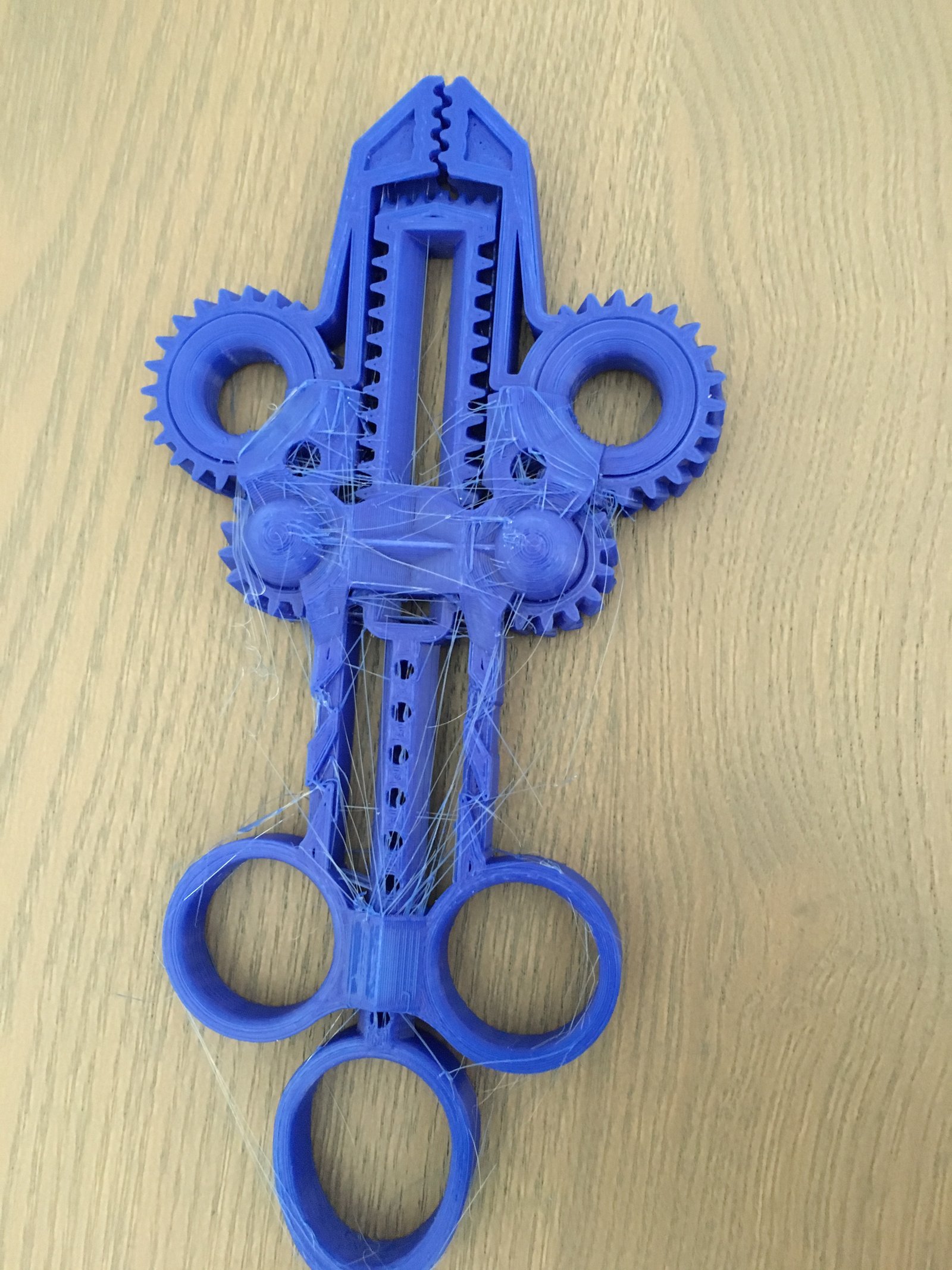

I have a Creality 3 and use Cura to slice. Everything runs perfectly, however the stringing is a real issue. I decided to print Predator Pliers as it seems to be pretty popular. I’v looked everywhere I can and tuned everything I could and it still comes out this badly. This print is supposed to move and has working parts, but my printed seems to have attached them together via stringing.
Here’s are the settings with what I printed this specific one:
Layer height: 0.15
Infill: 20%
Printing temp: 190
Build plate temp: 60
Enable retraction: true
Retraction distance: 4
Retraction speed: 60
Print speed: 40
Travel speed: 140
I have also tried printing with cooler and hotter nozzle, changing retraction speeds and distance, having a smaller and larger travel and print speed, adding zhop, giving a higher minimum layer time to allow for cooling of each layer.
No matter what I do, stringing continues, any help would be highly appreciated.
(Attached is the image of the print.)
