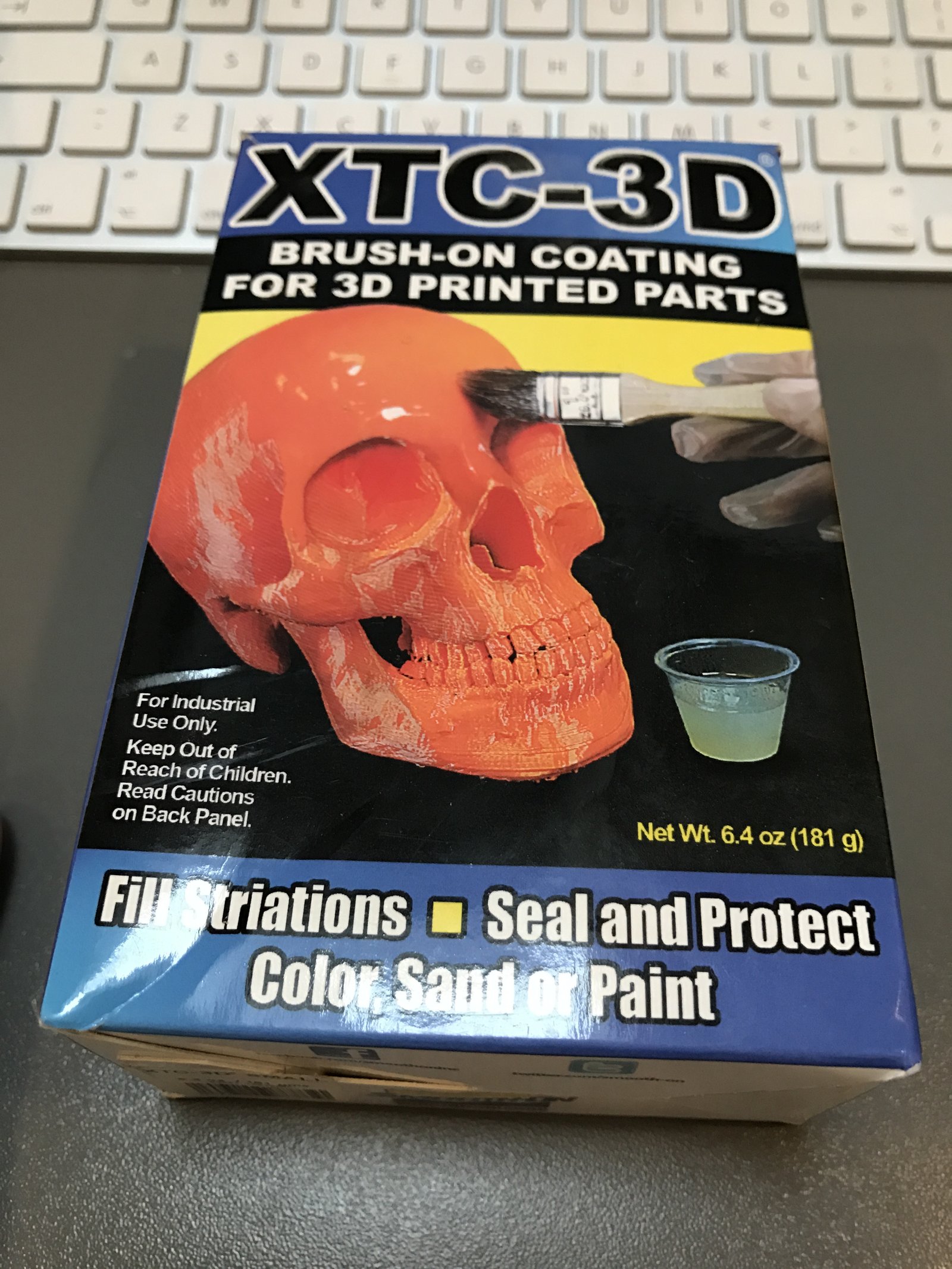

Hi. Wonder if you have tried low vapour epoxy?
also, i have tried this with my own 660.
Thanks everyone. I have a sample of a part cured using the 3D Systems epoxy, but didn’t find it that strong. I’ll try to test some of the other epoxy products mentioned here. The parts we print are generally very large full print-bed size so I’m not sure epoxy is a good long term solution for these parts?
