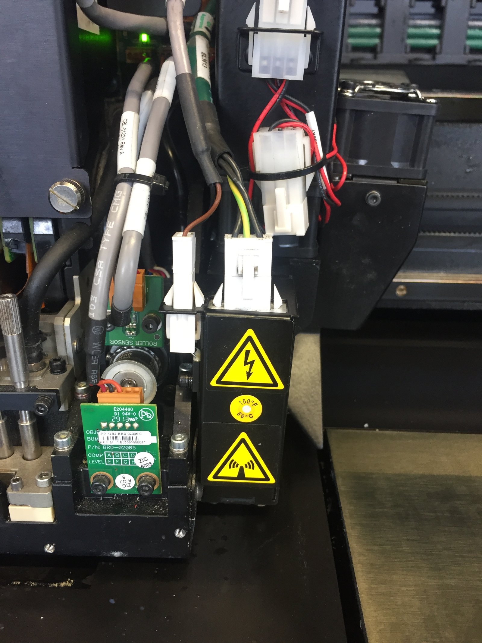

check the UV lamps, there is a sticker on the front which should be white
if its black then the Heat fuse has gone and this will cause the above error
Also check if the cables are plugged in. especially after maintenance sometimes people forget to plug back in the UV fans, which will cause the Heat to rise and blow the heat fuse.
Given that this occurred during a print it’s possible that the temperature rose too much.
Yup that seemed to be it!
For some reason the fuse was burned bc temp rose too high and it wouldn’t give a signal to the mainboard that the door lock is closed. Replaced the fuse with another and it all worked great!
