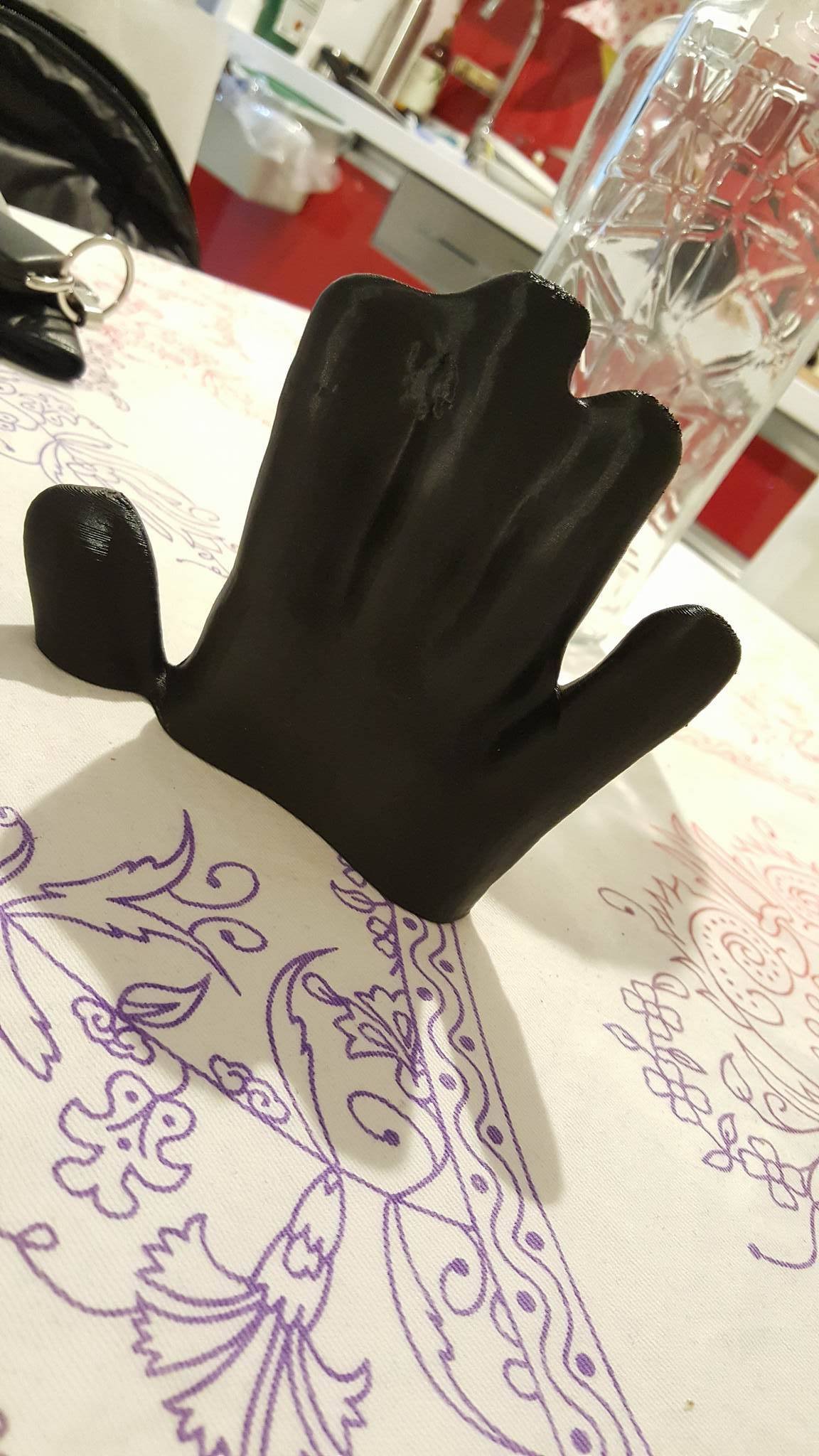

I tried several different things I figured out by your helps, tried different stl generation processes no help, tried getting smaller slices so smaller files no help, and finally I tried to upload on website and Voi La! It just uploaded and synced the file perfectly and you can see what I got now.

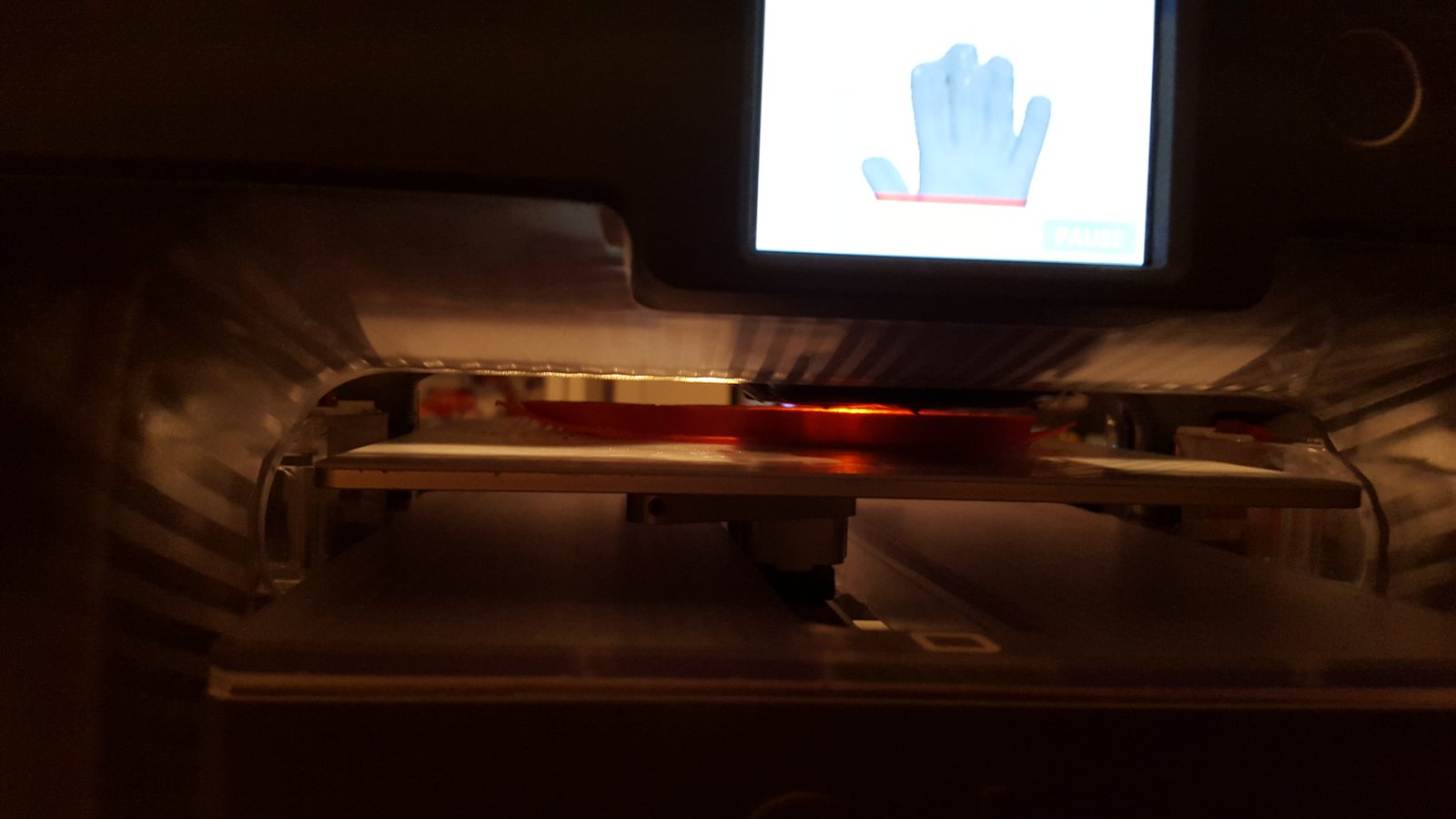

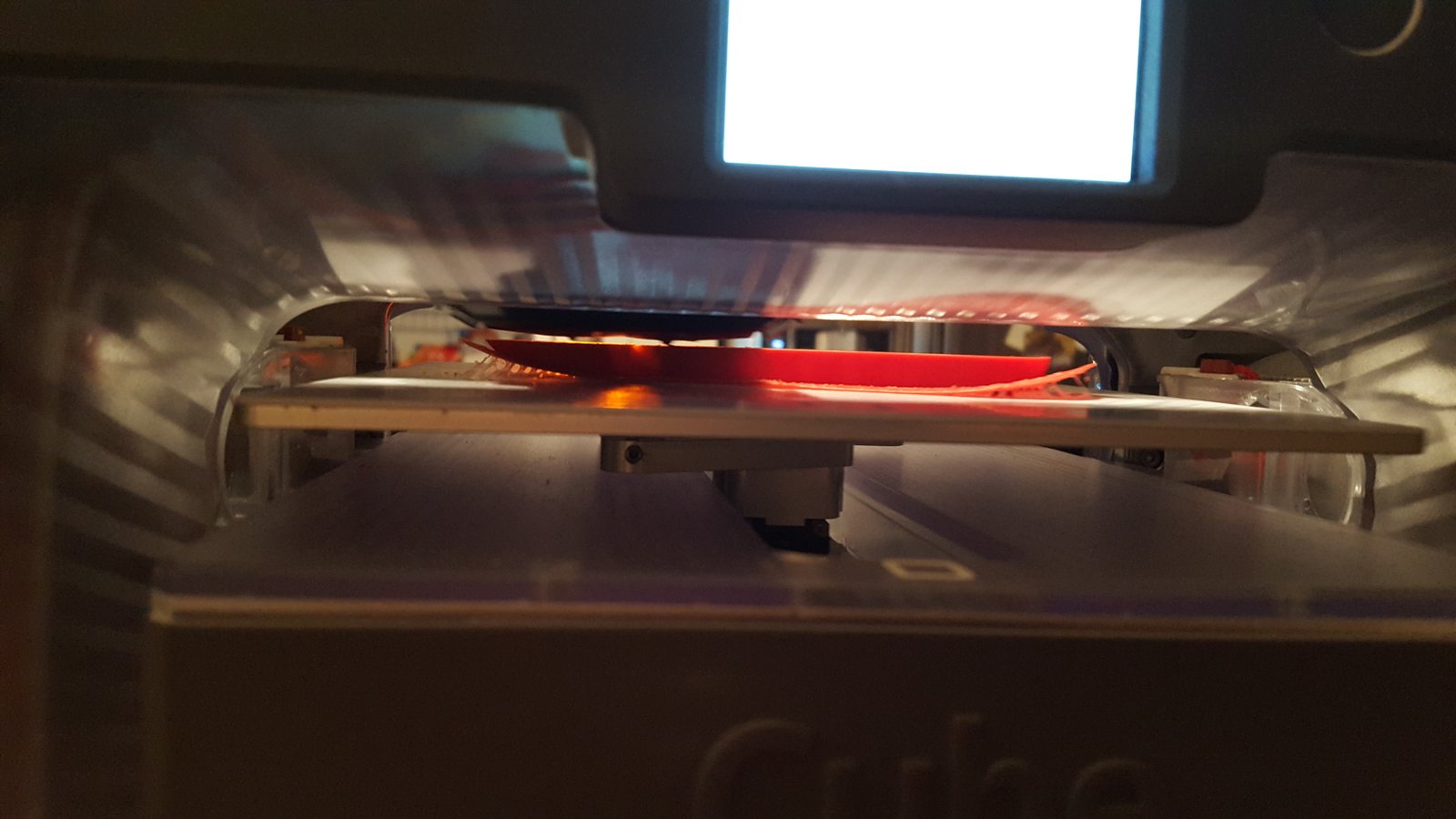

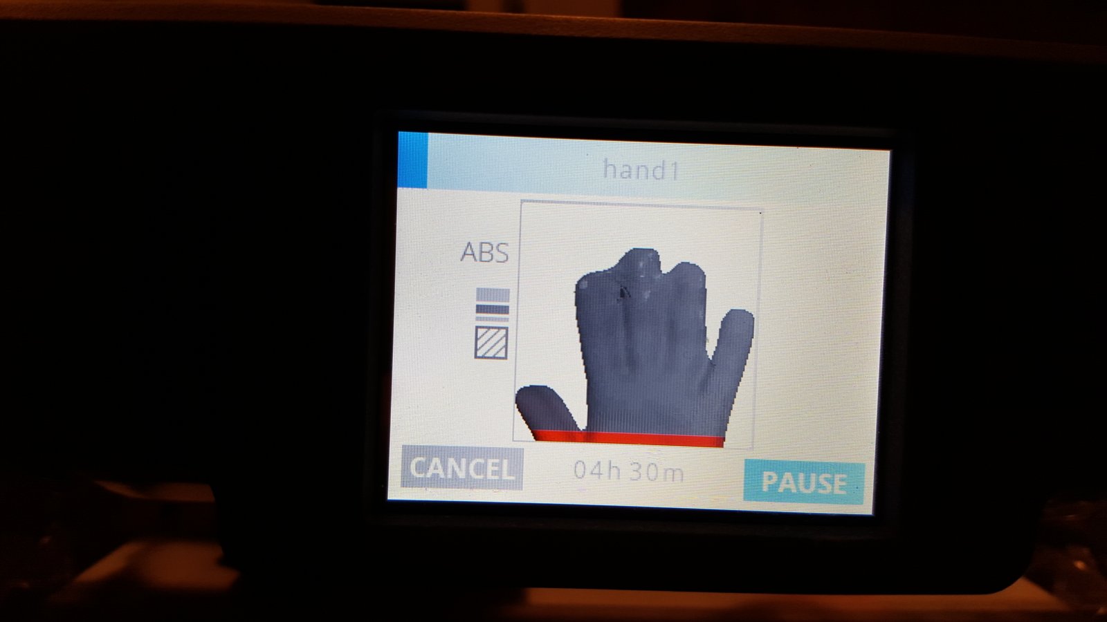

I imported your hand1.stl into Cubify and it is printing now without any problems. I made no changes to this file at all other than import the .stl from you, create the .cube3 through Cubify, and print it through the USB key. Were you able to get it to start printing, or did it fail before it would print?
I will upload the cube3 file that I am printing shortly.
This is where the print is now. Of course, I didn’t put enough glue or heat up the bed enough (I put it next to a space heater or heater vent to get it warm) and it is warping terrible, but still printing without any issues.
