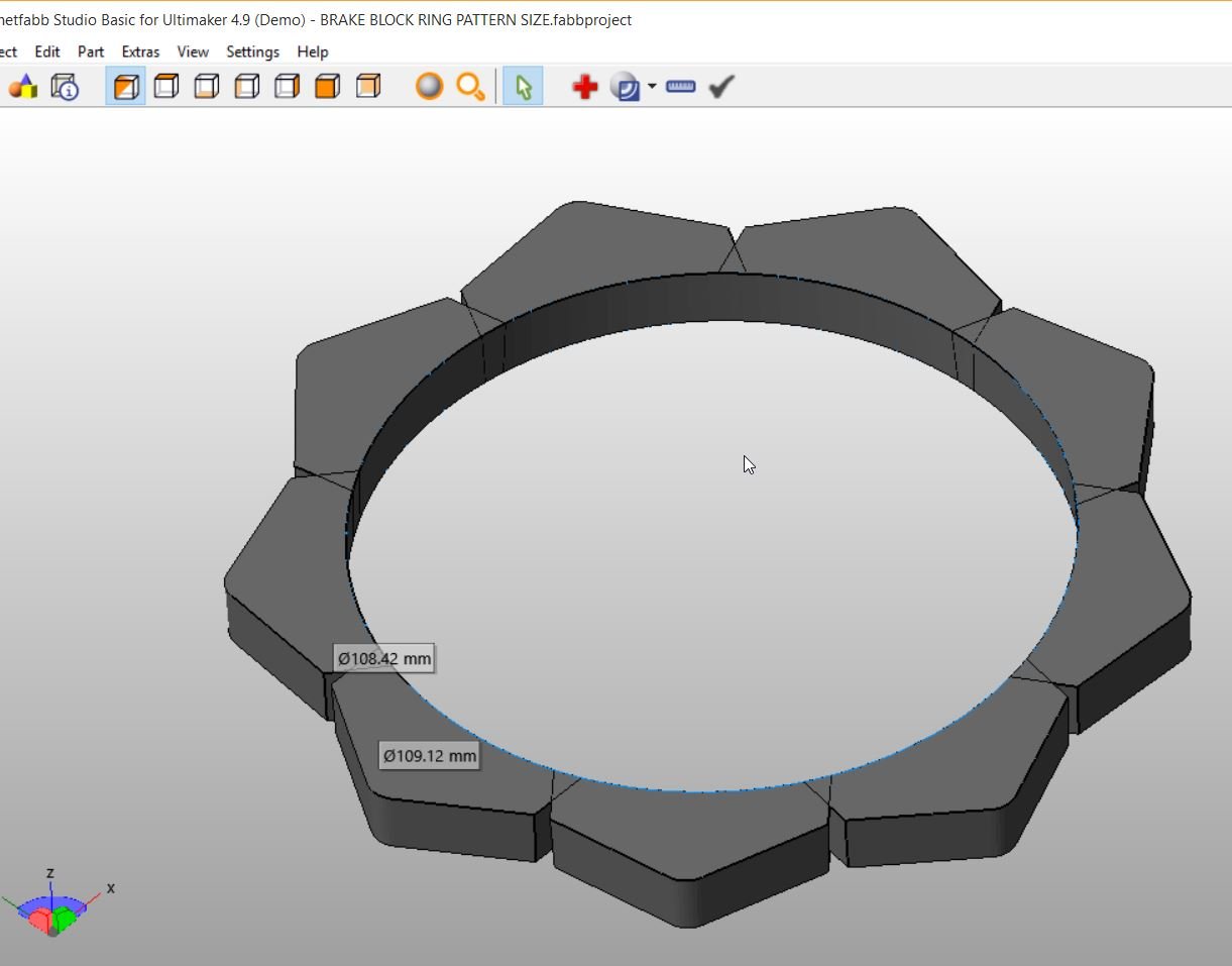

Can anyone tell me what’s going on with this stl and how I can repair it?

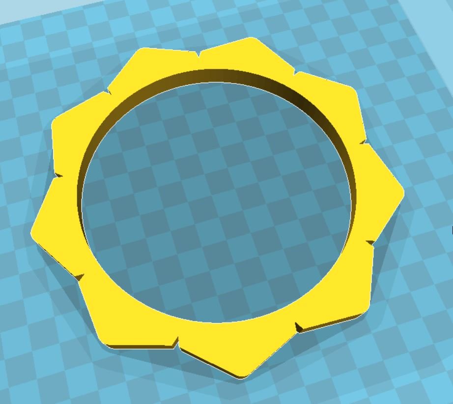

Clearly it seems that the original stl consists of overlapping objects and cura interprets the overlap areas as empty rather than filled.
I tried doing a repair in Netfabb, I also tried importing and re-exporting out of various programs including blender,Openscad & Autocad. I couldn’t solve this- granted I am a complete novice with Blender & Netfabb.

The attachments are largely self explanatory but you can see how cura shows in in normal view (what the customer wants),

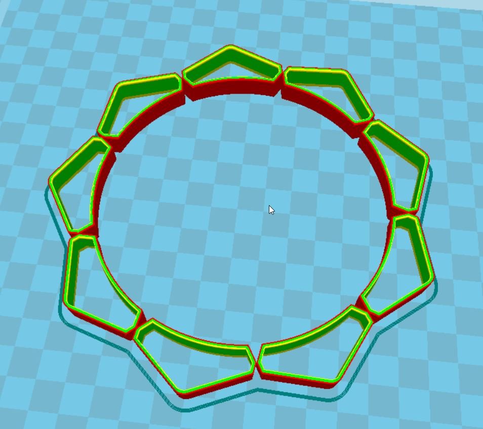

layer view,

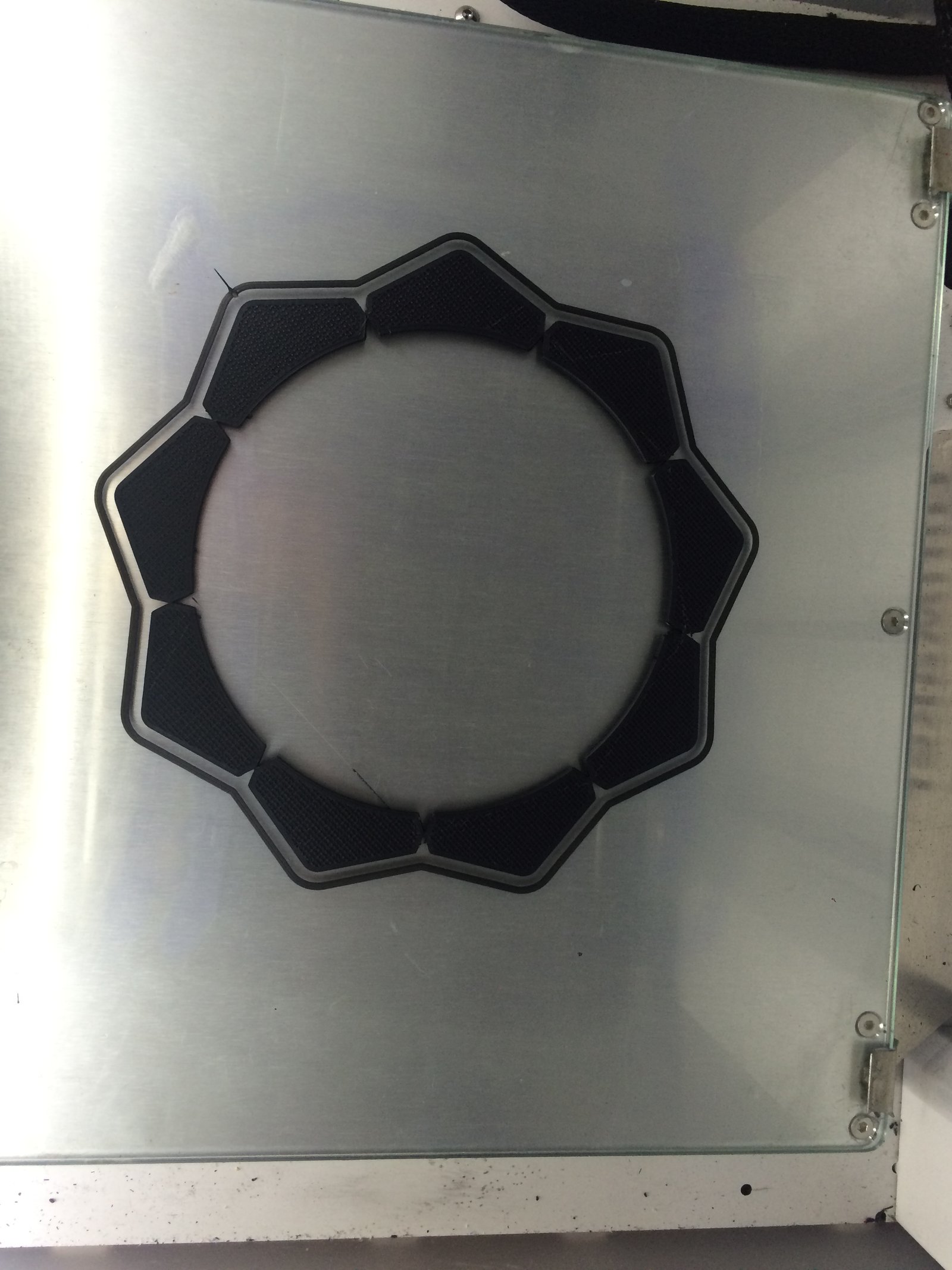

how it printed;

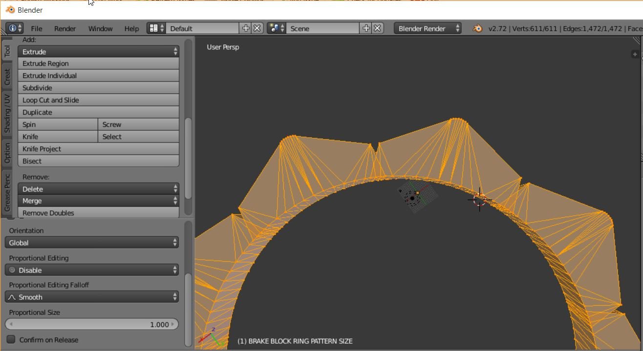

and how it shows in blender
and netfabb.
Thanks in advance to anyone who has any ideas how to resolve this given just the STL

In blender there is a way to flip the faces around. Have you tried this? Because red colored surfaces are meant to be inside surfaces. (Going from the sliced part image)
Thanks,
I tried this and it seemed to make no change. Assuming I did it right of course, I am feeling my way around Blender. However I did load some other models and they also have red outside in layer view, so not sure about that
You could try the fix horrible setting , in the expert menu in Cura playing with the A/B buttons can have the desired result http://polaridad.es/wp-content/uploads/2014/12/cura\_expert\_settings\_dialog.png
I actually just found another solution to the immediate problem which I am about to post -I will do that seperately, but you win!!! Using fix horrible either A or B did the trick as well (just based on layers view). Thanks so much, that will help next time- now I know what fix horrible does- never touched it in nearly 2 years of using Cura, haha.
