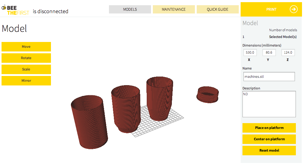

So I want to print the infamous machine designs on my Bee, but the stl consist of multiple parts (see image). Call me crazy but I can’t seem to find the “split model” function to seperate the parts, like Cura has. Anybody an idea? Thanks!
I would give netfabb basic a try.

Right , i have that printer too and i never found that function. So what i do is , i do split it in Autodesk 123D first in diferent files and than i have to print every file at a time
To detach a shell from several inside an STL file you can easily use the software netfabb Basic which you can download from this link free of charge.

Ok, thanks guys, clear. External software it is then. Shame it isn’t build in…

Ok no problem the only ways I know how to do it is either in Netfabb or in cura right click split parts then save the model as Stl.

Ok thx. I will go for Cura indeed. Will share the result later. cheers!
