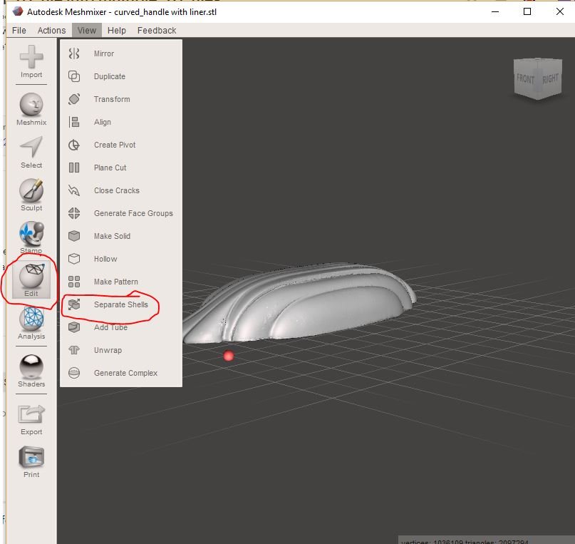

You can also use the Edit, Separate Shells menu option.
It is usually used for parts that are made from multiple shells but does not care if the parts are already phycially separated. it still sees them as shells in one part.
