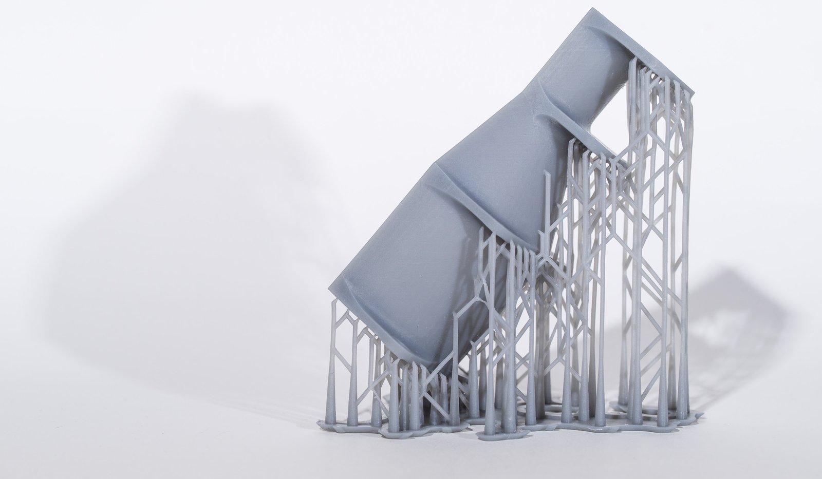

1st: Why are you so down on FDM printing? You list a whole number of problems with FDM including that it often needs support and hint the SLA does not, yet your pictures show things like the above. Why no mention of supports in SLA printing?

1st - Let me start off by saying we’re definitely not down on FDM, we think it’s capabilities are amazing and will be showcasing it in our next mail! We compare the two in the article as they tend to be our two most popular materials. Within the “print orientation part” of the Designing Parts for SLA article we discuss all the ways in which support affects an SLA print, as it’s an integral part of the process. It’s also discussed in the post processing article we sent over in the mail too.
