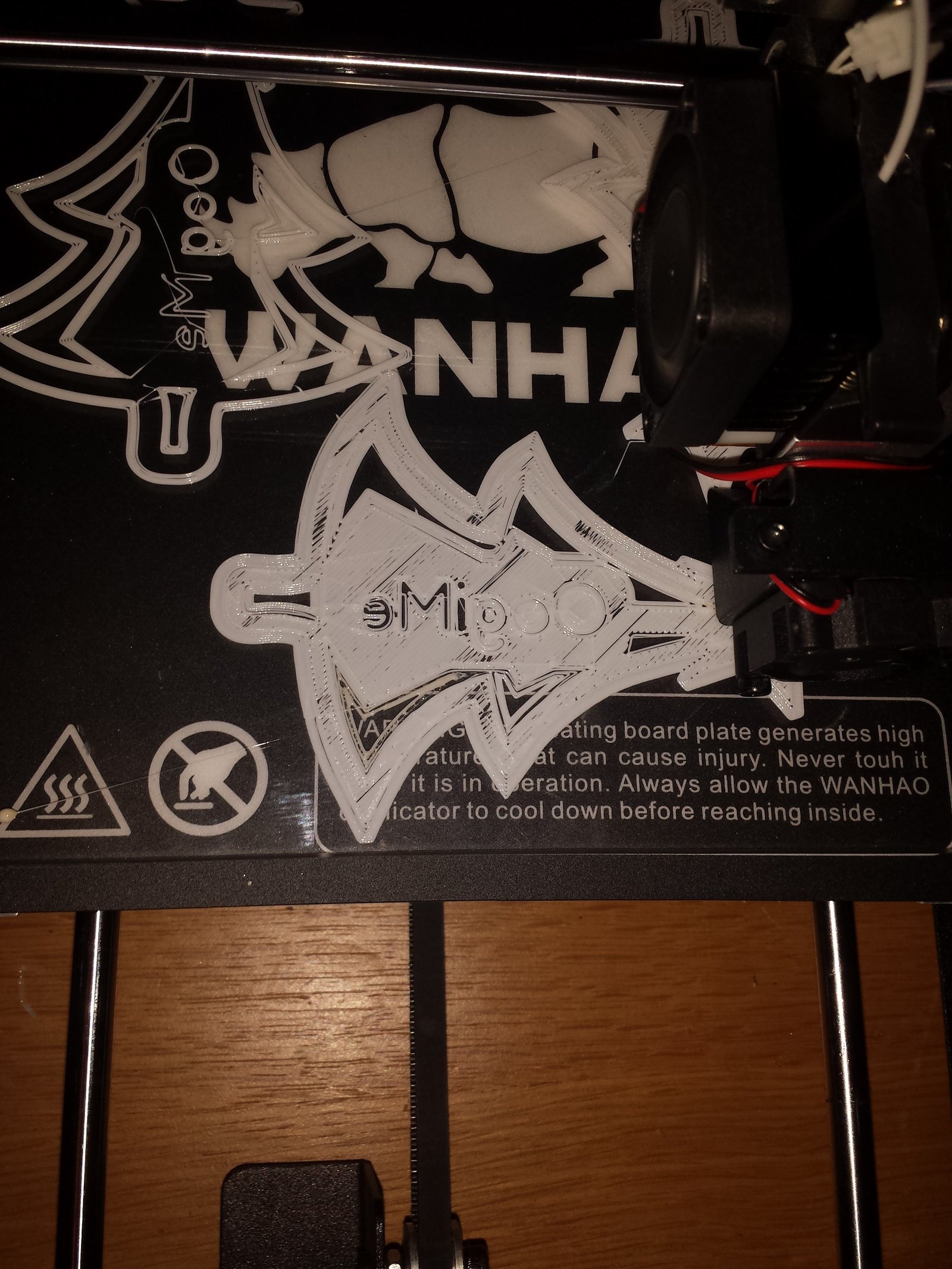

Hi peeps. After having the issue of mid-job halting on my printer I decided to try Cura instead to see if that resolved it but it doesn’t start very well!
I’ve attached a pic of what it looks like. I’ve set everything I can see as the same but it comes out like that. Simplify printed what it did spot on.

I don’t think this is a problem connected to your slicer at all. I would recommend you check the following:
-Power connection to your board. If it’s loose, printer vibrations can cause intermittent operation
-USB printing. If you’re printing through USB, you could loose connection mid-print. If you can, try printing over an SD card.
-Driver temperatures. Some boards shut down/reboot (whether this is wanted or not) when components such as the stepper drivers get too hot. See if you can reduce the motor current without skipping out on any steps or add active (fan) cooling for your board.
