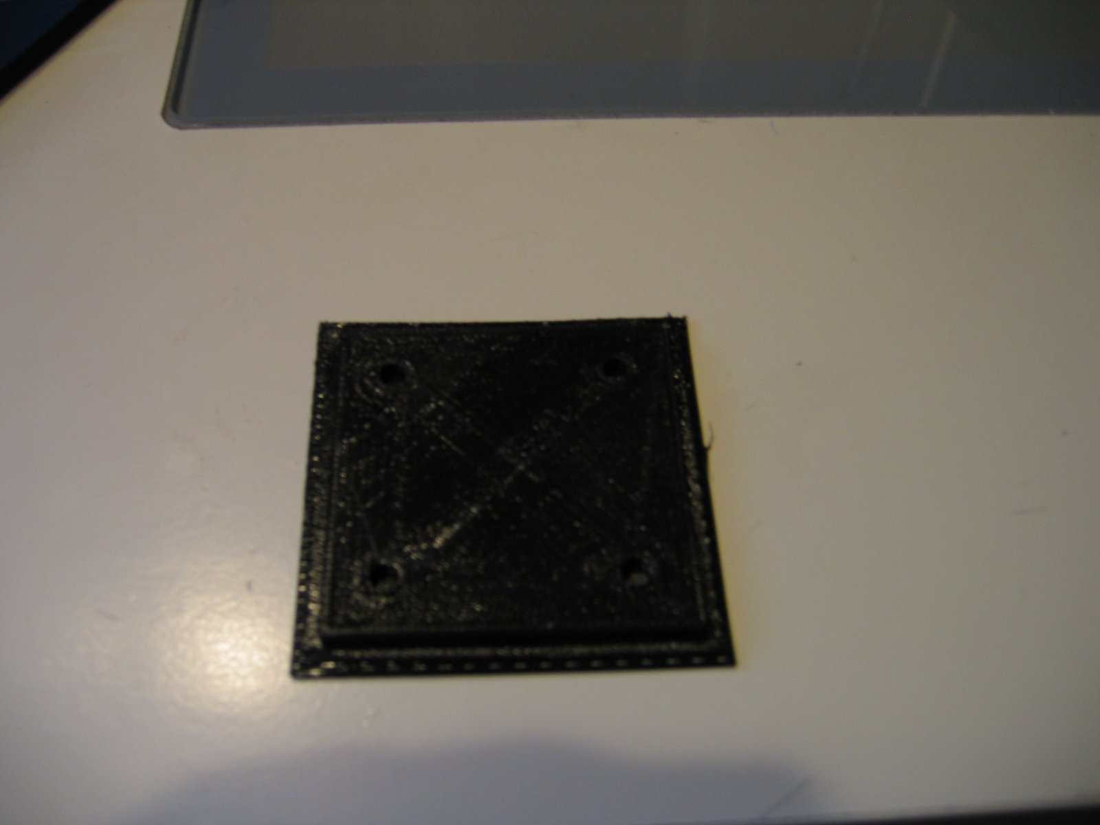

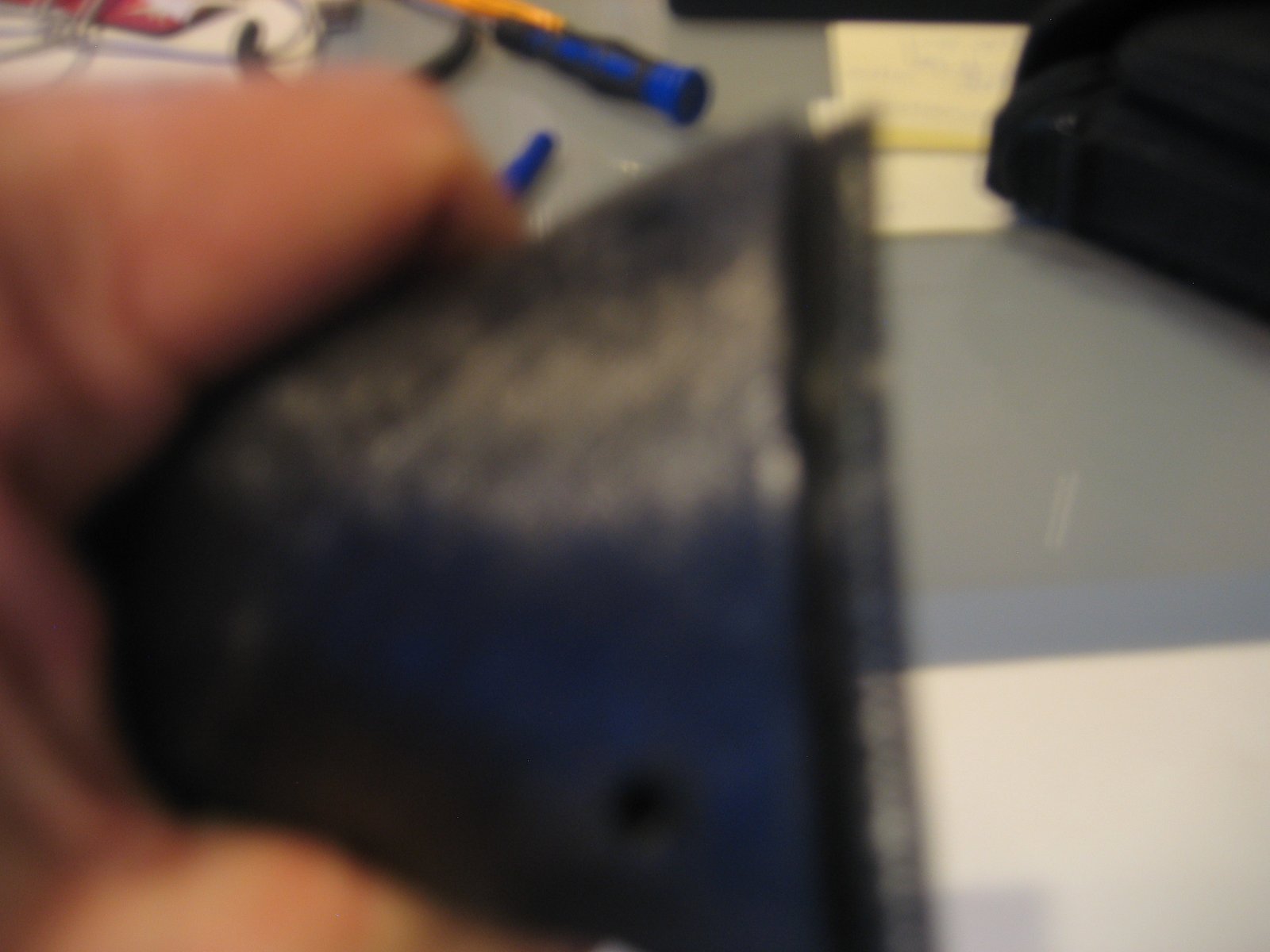

See the images i made for a customer. It is a flexible damper for a insertbearingblock and it looks Ok . It won’t be as smooth as the watch you sell because of the somewhat lower resolution. but i will do for prototypes

I can give it a shot upload the stl file to Saenhub and i will see what i can do for you.
It would be fun to help you with this and see what FPE can do!
